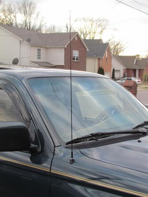

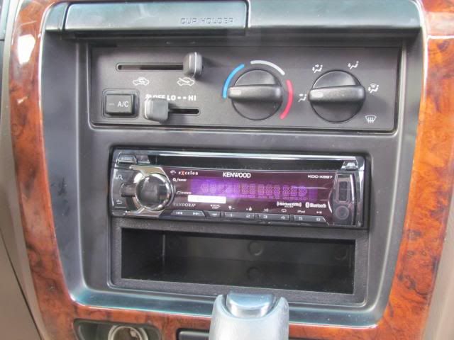

Well I got my Tacoma whip and my new HU installed today and if the effin Mobile App wasn't being difficult I would post a picture.
I will get them off the real camera later tonight. Anyone else have trouble with the mobile app crashing when you try to upload pictures?
Real Camera pictures downloaded.

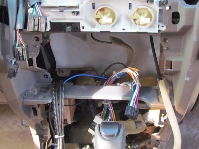

First off, I hate the little two wire connectors that seem to connect everything in the center console. I managed to get one off on my security indicator, pulled the light out on the second one and just laid the shifter in the floorboard because it wouldn't come apart, anyone know if there is a trick to those little suckers?

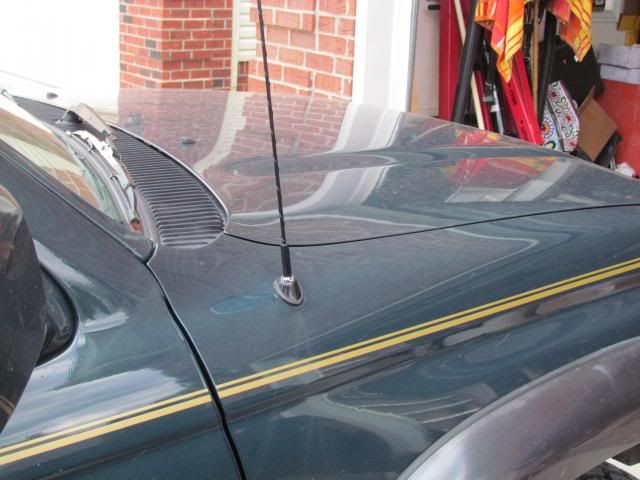

Anyway, once I got the trim off, I got the old radio out and then had to swap my antenna. I am not sure, but I believe that my antenna had been swapped once before because the routing was not along the AC duct as noted in the write-up, but wedged in above the dash steel tubing. There were no zip-ties to access and the cable could not be pulled at all, so since I had a new one to go in, I cut the end off so that I could pull the wire out. I then just pulled in the new antenna cable and routed it myself, zip-tying it up out of the way, but in a more accessible location. This process was not documented because I was too busy trying to figure out WTF was going on, but I did snap a couple pictures of the finished product.
http://i84.photobucket.com/albums/k8/mrtucker80/IMG_3243_zpscca0ef87.jpg
http://i84.photobucket.com/albums/k8/mrtucker80/IMG_3242_zpsbc3a4720.jpg
My new routing gave me ample cable to plug in the new HU, and the best part is no more wha wha up, wha wha down everytime I turn the key over. If anyone needs a power mast in good condition, or a motor for their power unit, I have both that will be going to the garbage can later if no one claims them. The overall unit is trashed since I cut the cord, but the mast and motor are still good.

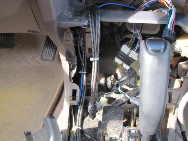

I spent last weekend hooking up the HU harness to the plug-n-play harness that crutchfield supplied with the radio.
Guts hanging out
http://i84.photobucket.com/albums/k8/mrtucker80/IMG_3239_zps19a04c26.jpg
http://i84.photobucket.com/albums/k8/mrtucker80/IMG_3236_zps63cbb4b7.jpg

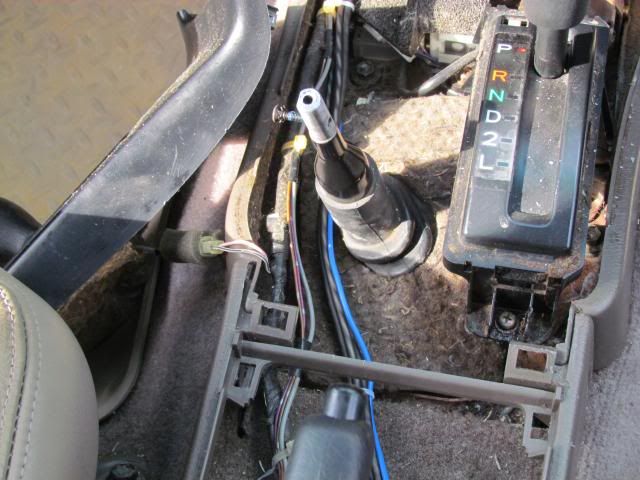

And I went ahead an installed the remote wire and two sets of pre-amps so that I don't have to tear the dash back apart in a week when I get ready to do the amp and bass-link.
http://i84.photobucket.com/albums/k8/mrtucker80/IMG_3237_zpsf3f1fac9.jpg
Everything is routed under the console out under the passenger seat. I wrapped all the ends in split loom and electrical tape to prevent them from shorting until I get the amp installed.
And I am very pleased with the finished product.
http://i84.photobucket.com/albums/k8/mrtucker80/IMG_3240_zps5da2c894.jpg
I haven't played with it much, just turned it on and made sure everything worked correctly and then back off.
I am looking forward to being able to play a CD :D

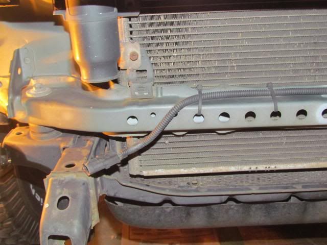

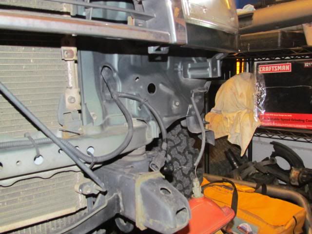

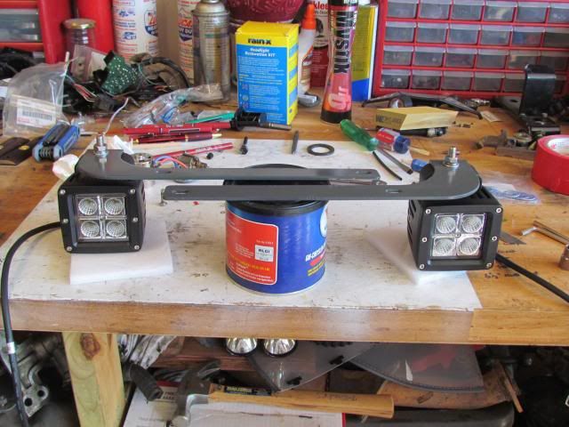

Here are a few of the Fog light install that I did a few weeks ago.
Here is the semi-factory Harness that is in my rig. Apparently in 98 fog lights were not a true "factory" option, but alot of 4runners got port-side fogs installed, so it is basically a stand alone harness, tapped into my low-beams. They only power up when the low beams are on and go off when I hit the brights. I figure it will do for now, but eventually will re-wire them to stay on with the brights also. Anyway, I basically just cut the old ends off and installed the supplied ELS connectors to match the lights.
http://i84.photobucket.com/albums/k8/mrtucker80/IMG_3224_zps11f60818.jpg
http://i84.photobucket.com/albums/k8/mrtucker80/IMG_3223_zps7f053034.jpg

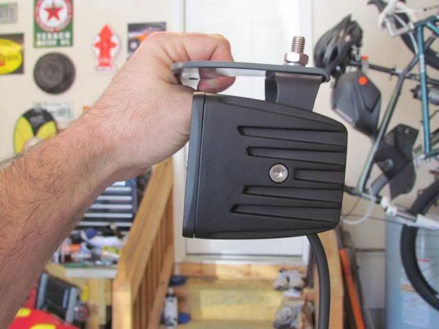

I modified the original bracket to allow me to accommodate the deeper mounting of the ELS LEDs. I have a pair of spots and a set of floods, I mounted the floods for now, and overall I am quite happy.
http://i84.photobucket.com/albums/k8/mrtucker80/IMG_3235_zps88f8c2cd.jpg
http://i84.photobucket.com/albums/k8/mrtucker80/IMG_3234_zpsc06595ea.jpg
