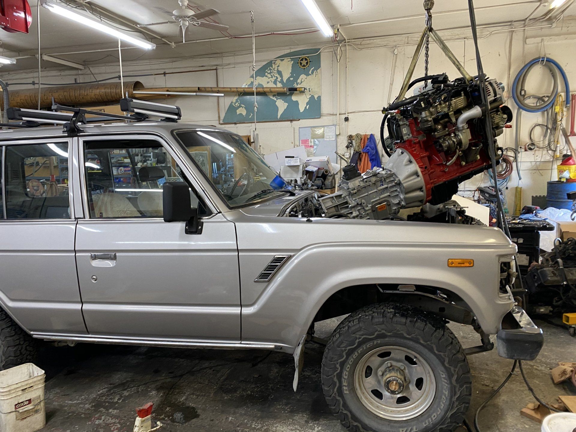

my name is Fred and live in Anchorage. Unexpectedly broke my back taking a snowmachine drop and needed a rehab project to keep me moving. My girlfriend has a really clean FJ60 that I installed the Cummins r2.8 into and mated to a Tremec 5 speed and an atlas transfer case. The 2F engine had 280,000 miles in it and was starting to complain in the cold winter.
The install took about 4 months given my slow mobility but I think it was good physical therapy crawling down and up from the floor creeper. I’m a habitual tinkerer and have a tig, mig, mill and lathe at my disposal if I needed something made or modified. I did have to lift the vehicle 2 1/2 inches for oil pan clearance to the differential
Initial test drive had the vehicle at 30 mpg in four wheel drive but would like a full tank reading. The tremec is an over drive 5th and has no problem doing 75 mph up a hill. It’s never gone this fast before and the road noise is understandably louder. Engine purrs like a small tractor with a windy sounding turbo instead of the whine of larger units.

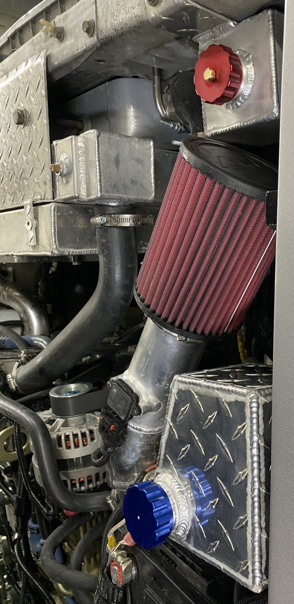

first picture was the initial fitup for welding the engine mounts. Second photo had all the plumbing complete and could run but still needed to install the fan.

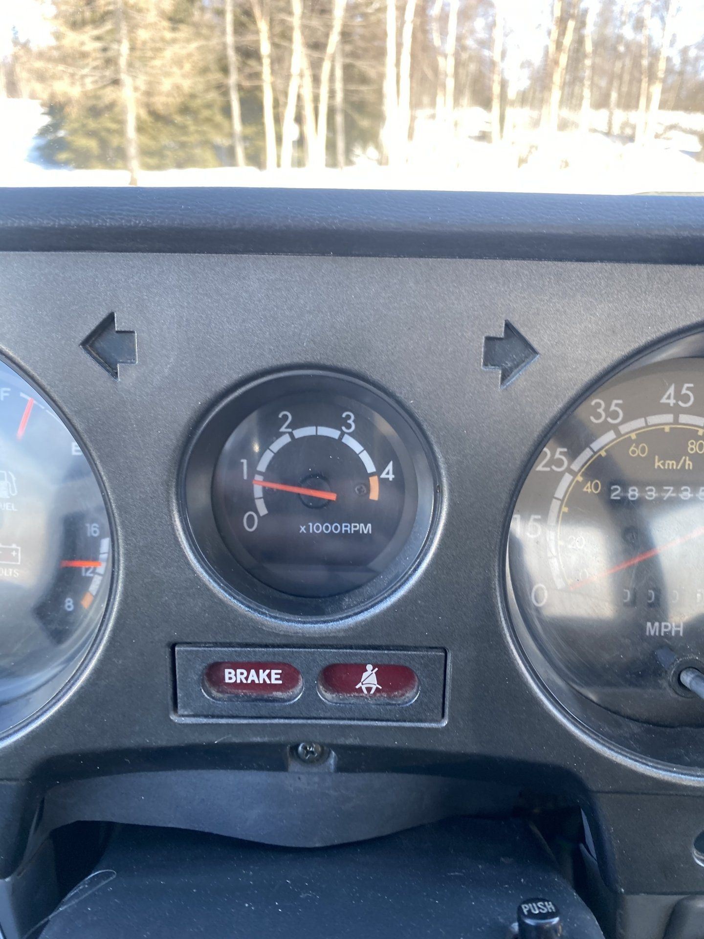

I’m at 95% complete. Last item I addressed was converting the tach signal to work with the original one and build a windshield fluid reservoir. I had to move the reservoir because i had to move the battery because the intercooler took that space. There were several shuffle episodes in this build.
