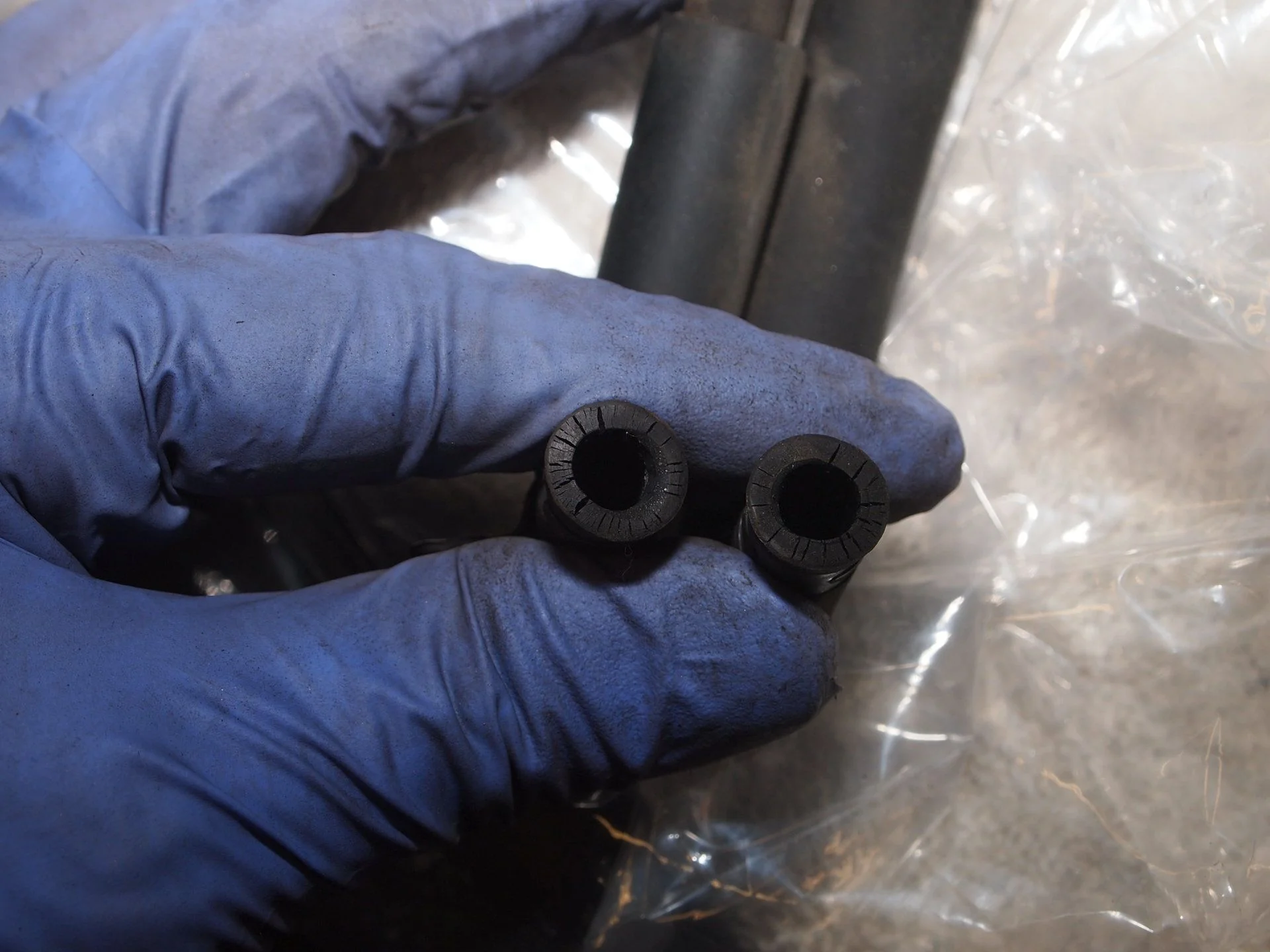

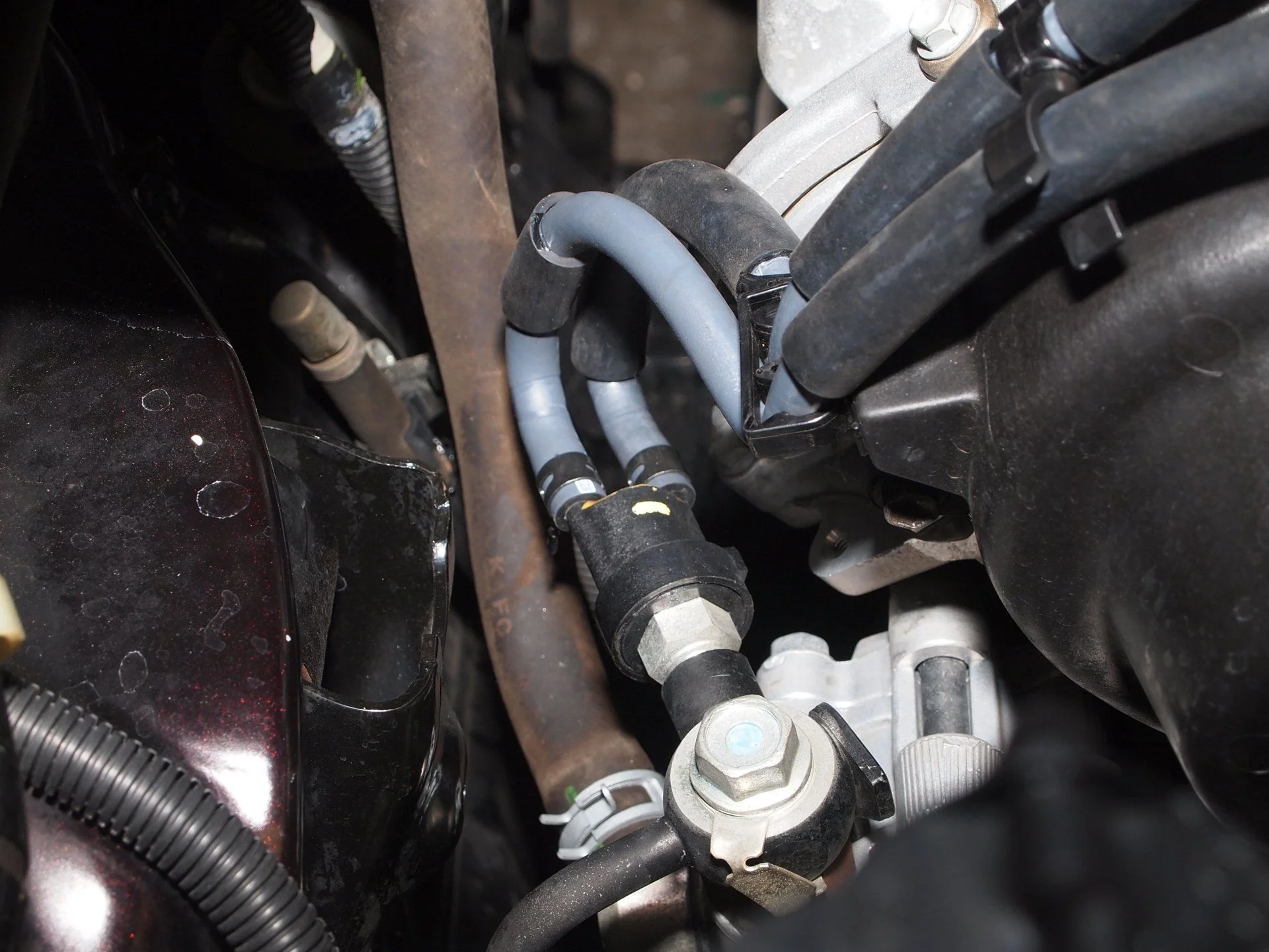

Sorry, VANE is the power steering pump. It has two vacuum lines on top coming off a control valve. I am always finding these lines bad. It's just two of many vacuum lines we need to check in our ageing fleet.
Power steering pump is on PS (RH) of engine front below air box.
I'm not saying vacuum leak is your issue. But basic need to be addressing first thing. Sometimes issues are a series of little things, that just do not setting off the CEL.
