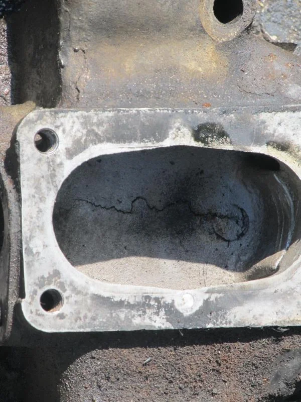

How much should i expect to pay someone to weld the crack in my intake manifold??:mad:
It shouldn't cost too much but I dunno exactly. If you cleaned it up well before you dropped it off to be welded it would probably save you a few dollars also.

x2 on 40 bux or under and the pre clean

ok the intake is off. See the crack!!
so do i need to take the exhaust off also???
I would take the exhaust (header) off while you are in there, replace the gasket with a Remflex and make sure the intake manifold and header are flat so they will compress the new gasket evenly when you reinstall.

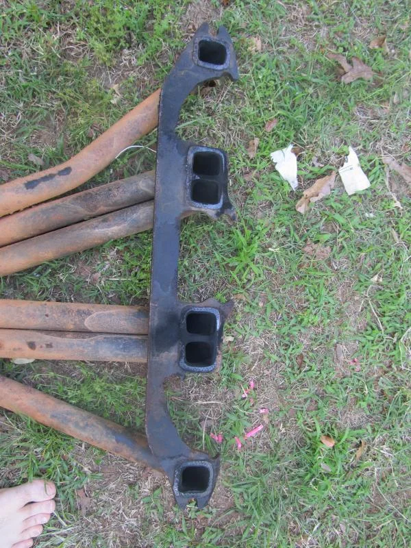

took my headers to a muffler shop today. They said if they could weld it together it wouldnt be but about $10 or so!! So hoping it works out. New headers would put me back a while.
well it is officially apart11 I now know why i kept smelling the exhaust so strong. Hopefully i can just have it rewelded. :doh:
Just make sure when you get them back you put a straight edge on the and make sure they are not warped badly. There is only so much a remflex can do.
Also tighten down the headers evenly. A little at a time. My first set I made the mistake of tightening the tops first snug then the bottoms. The leaked from there on out.
was able to have them welded back to together for $10. Sweet!! Now to check them with a straight edge.
picked up another intake from eventhough. Gotta check it with a straight edge. Getting there slowly but surely.
