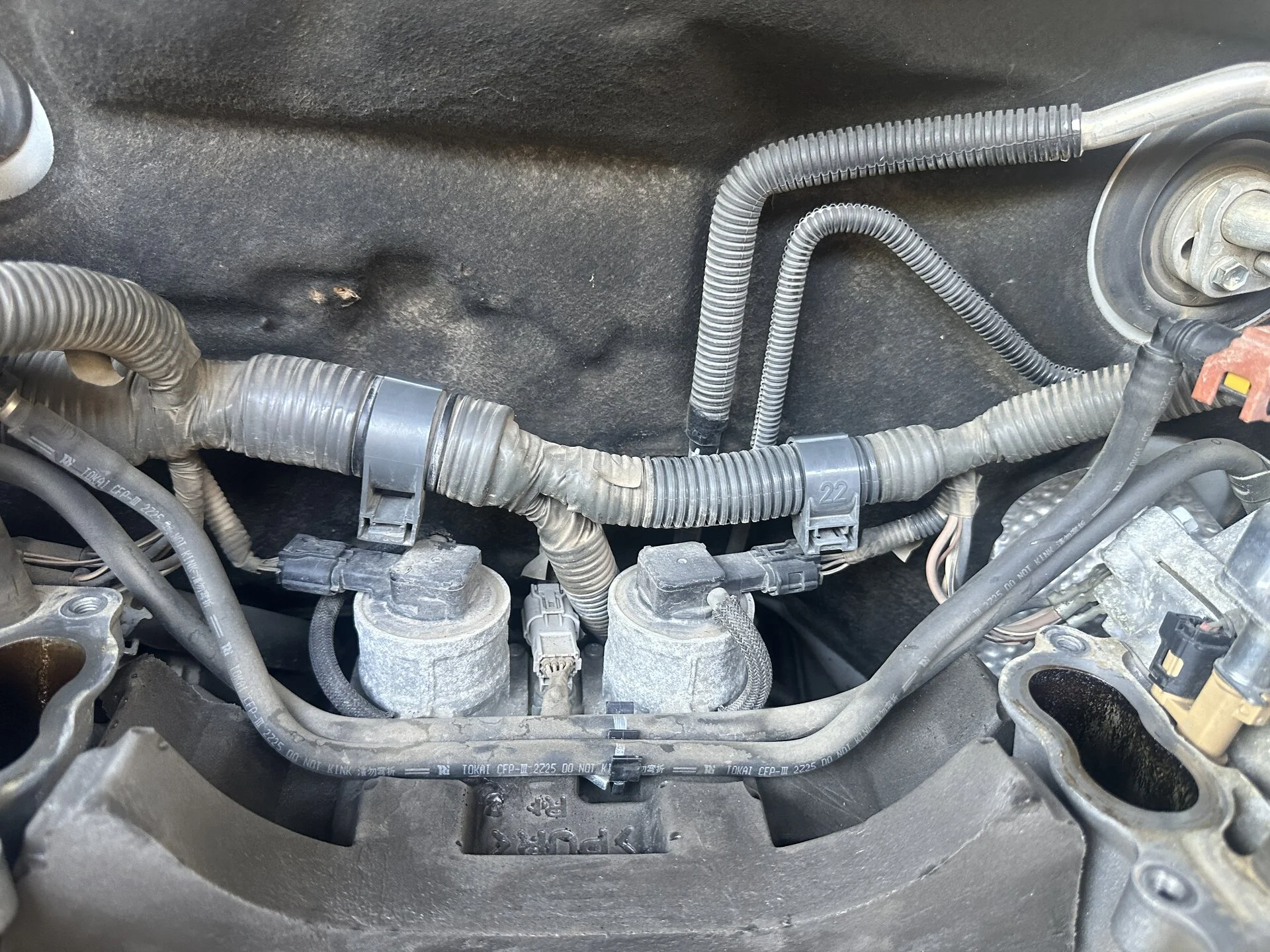

The two gray retainers on the harness here

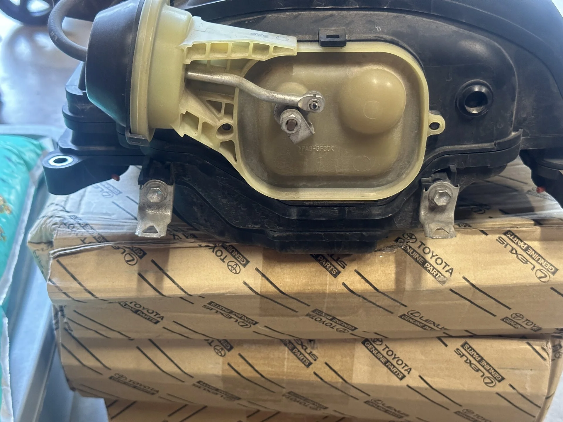

Attach to the two metal clips on the lower rear of the manifold here

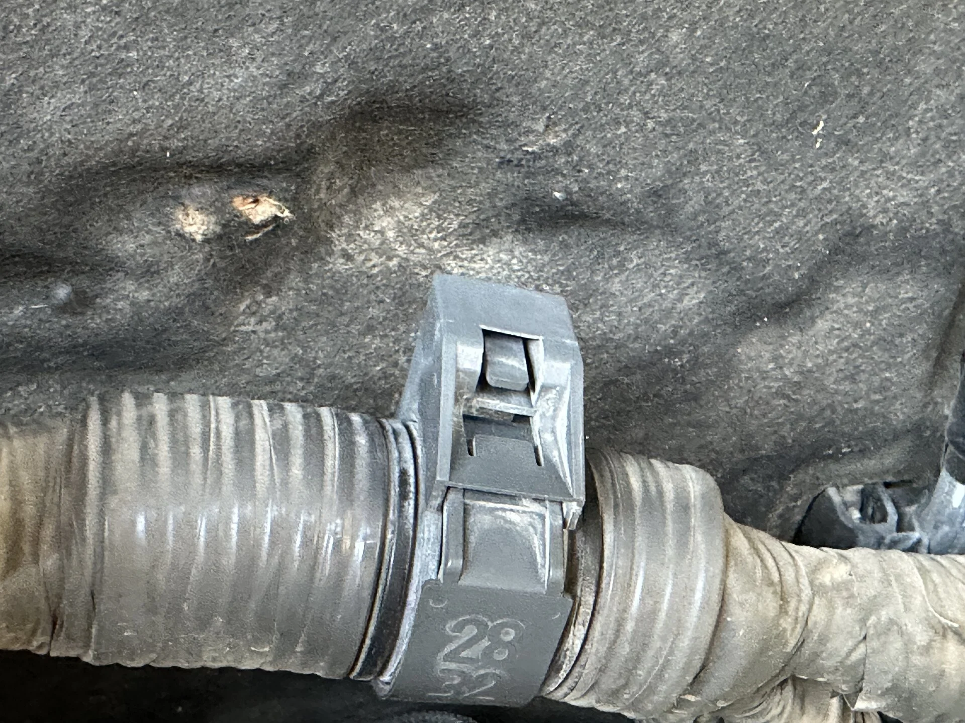

They are held on with a small tab on the bottom of the retainer, and once you know what to go for it's not too difficult. I'm just able to get it with the tip of my middle finger, then use other fingers to pull the retainer back off the metal tab. I flipped the retainer upside down in the following photo to show the tab
Again, that one has the part upside down to show what's going on. It'll be blind but just push the retainer forward, pull the small middle tab downward, then pull it all back, and it should come right off.
