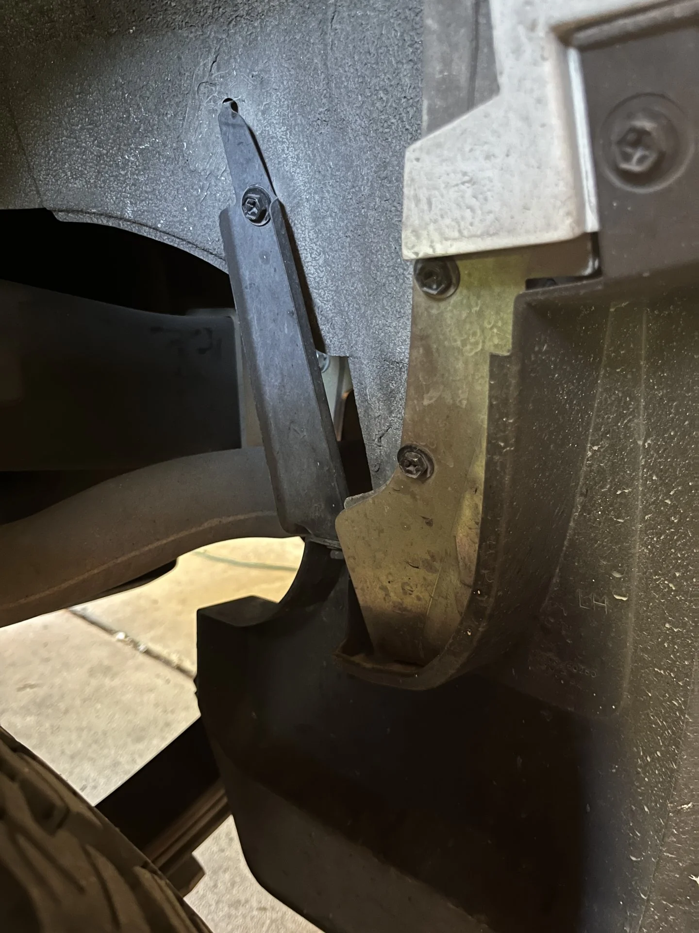

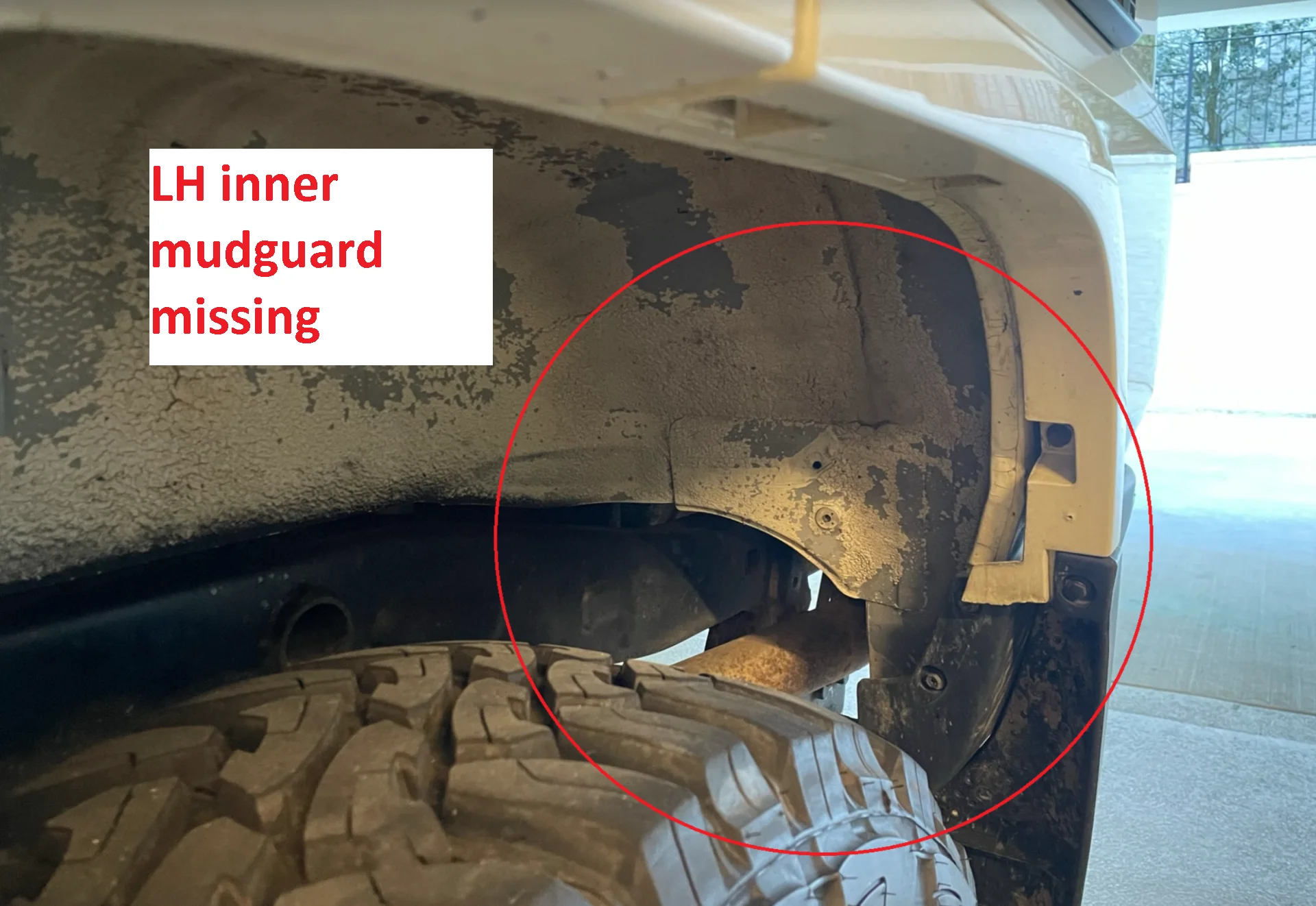

Could anyone tell me the part number to this? It's the rear, inner fender mudguard. My LH side is missing.

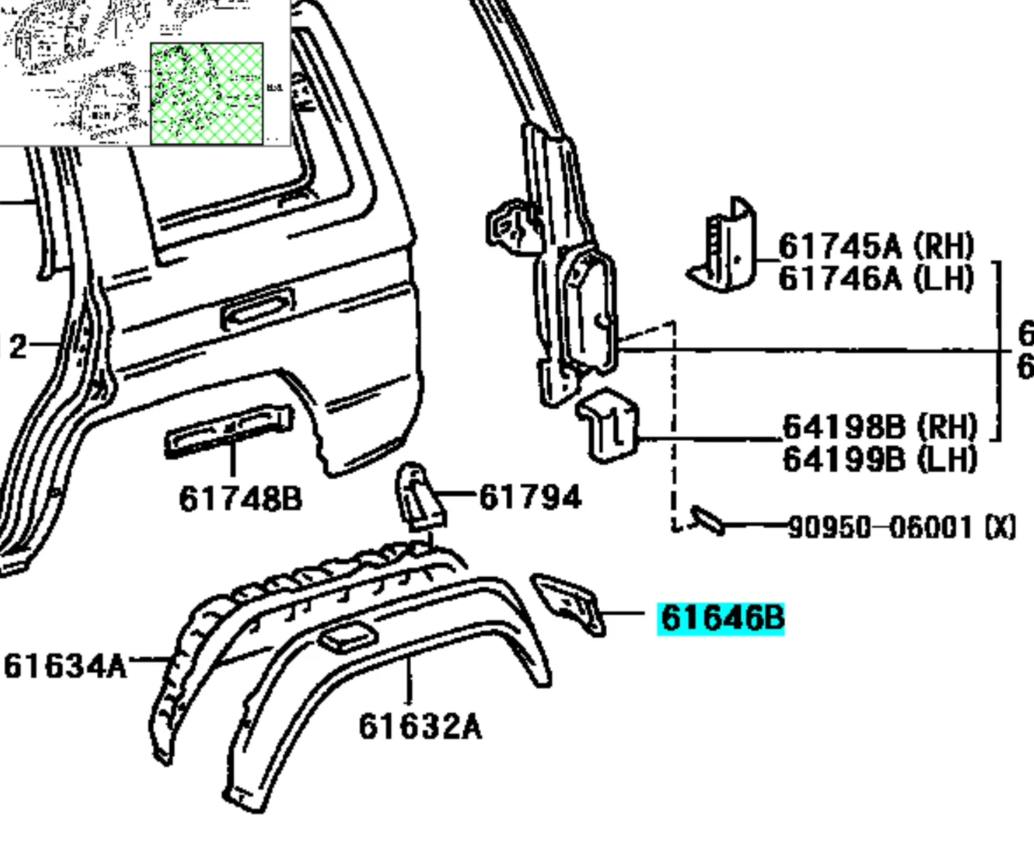

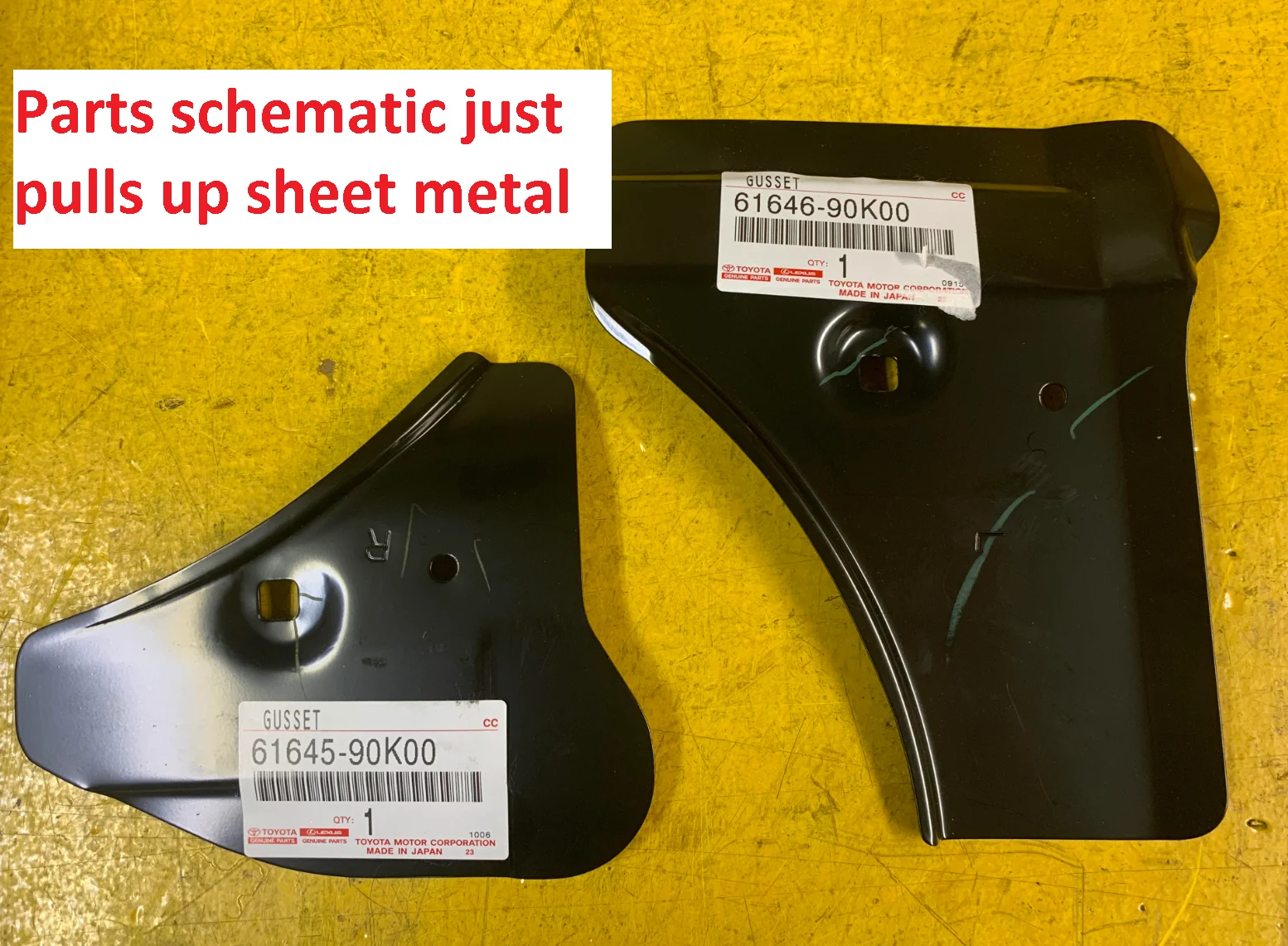

I worked with Stedman on it over in Japan. We thought we had it, but it turned out that it was only sheet metal, not the plastic guard...

I took a look and thought I had one there but that hole is actually used to secure the mud flap.

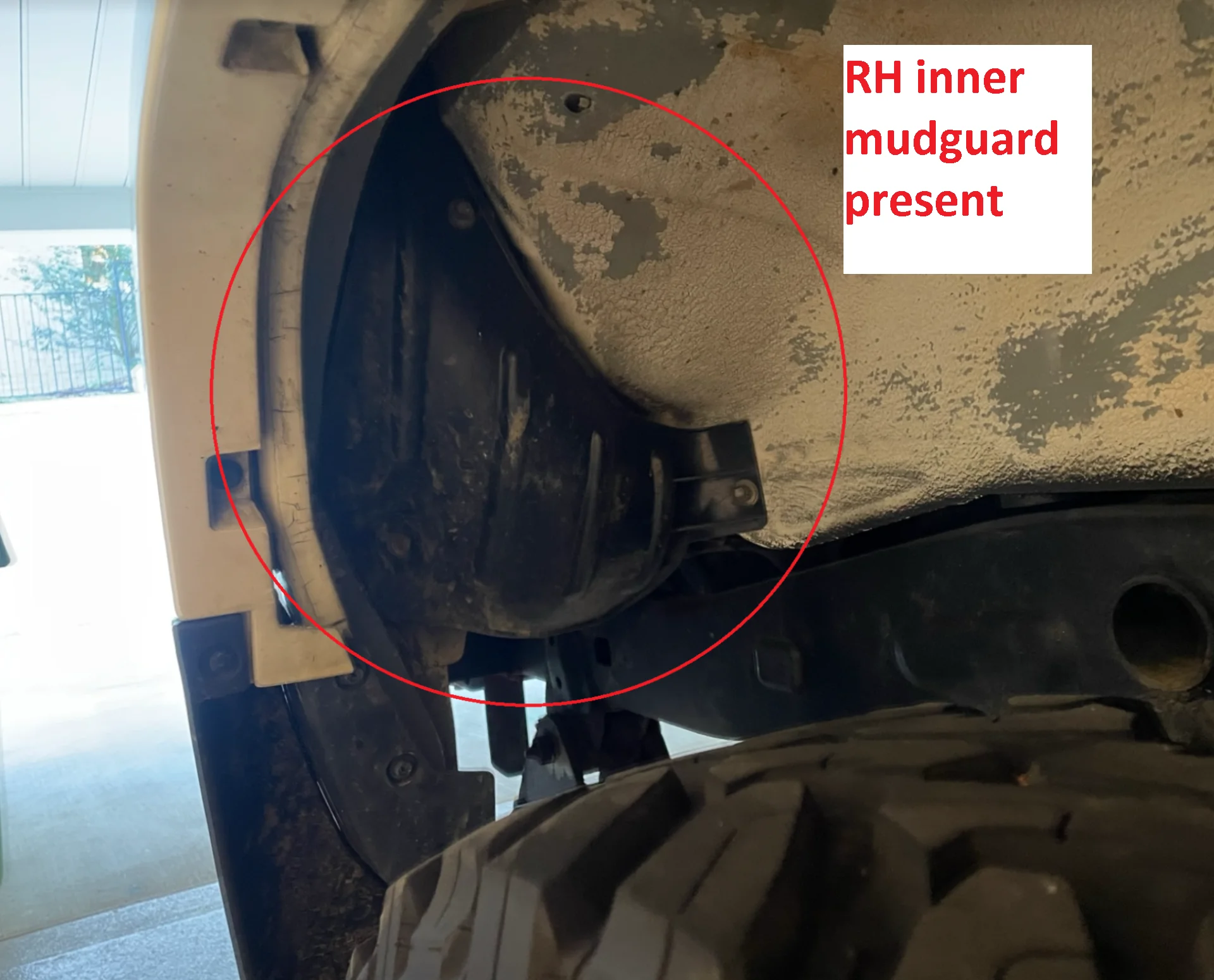

The right hand side which is p/n 77277-90K01 is indeed to protect the fuel lines and such.
I believe that’s correct. Mine has the same as well.
Absolutely correct. Shielding the fuel fill tube. Left side-only.
Many thanks to everyone on this thread. That makes perfect sense. Now I just need to track down a mud guard bracket.
76646-90K01.
It is difficult to tell from your photo but your right side bracket may also be missing.
76646-90K01.
Thank you. Got both sides on the way. I'll install it while painting those janky fender wells.
