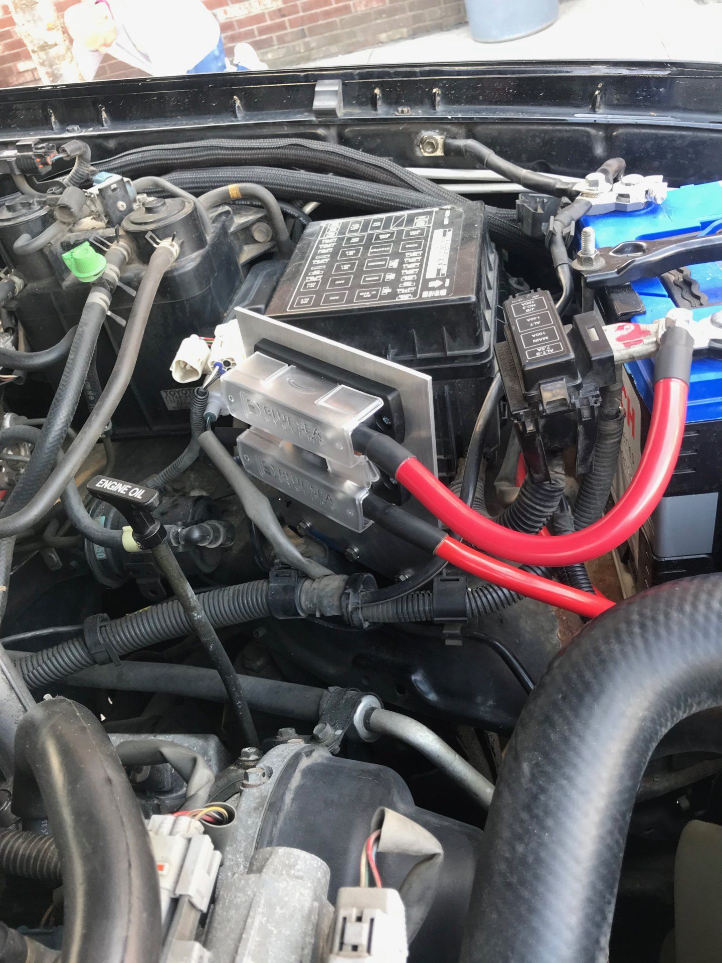

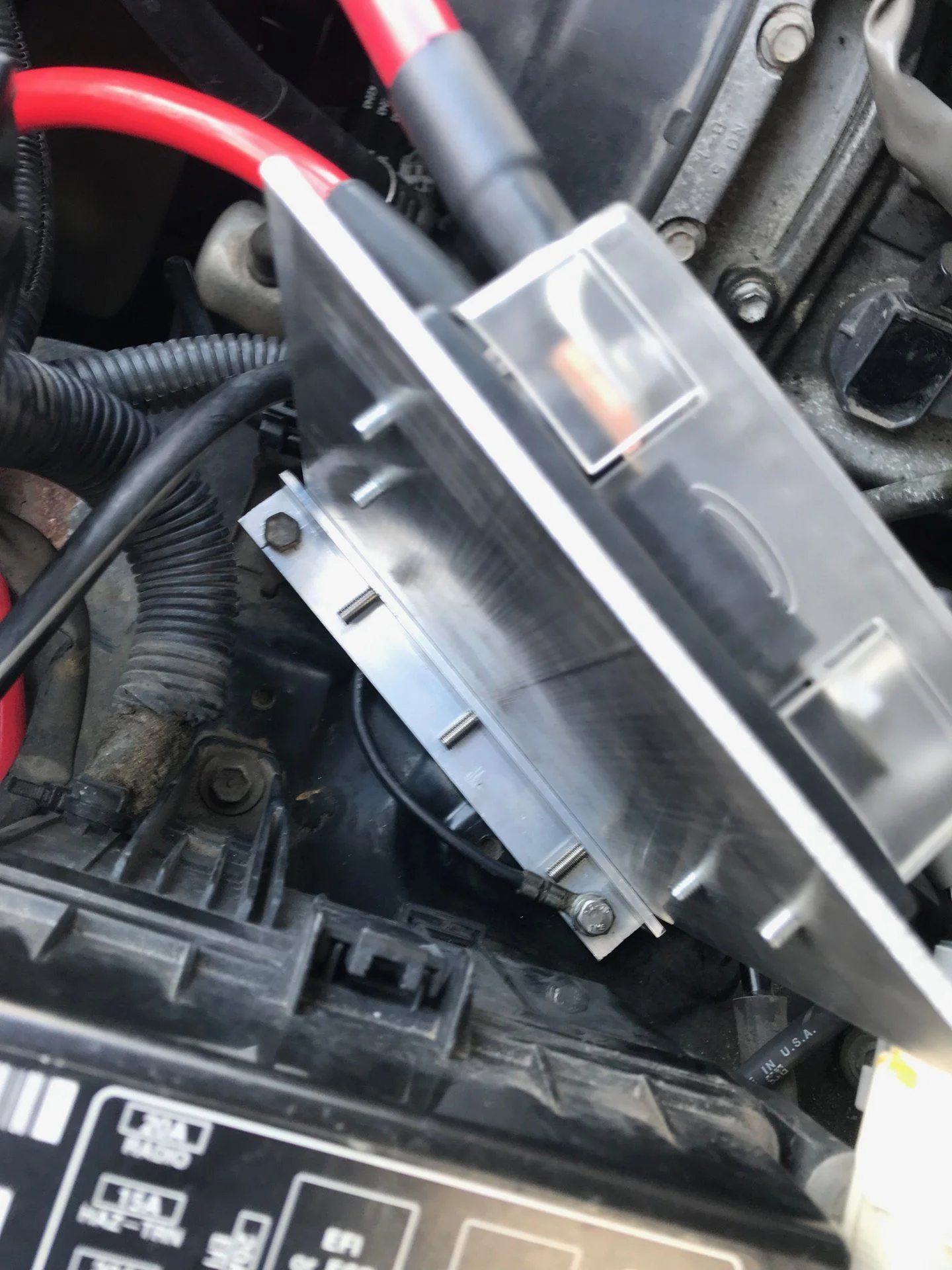

IMHO, that BlueSeas terminal fuse is about as good as it gets. Less connections prone to failure than an in-line option. Here is mine configured for use with my dual battery kit and winch.

bracketology -- i used a dual MRBF like you over at the 2nd battery too

I love those MBRFs. Super high quality choice. Most inline fuses I associate with "audio" shops and they are cheap chinese junk.
THe ANL fuses in a good holder like Blue Sea are also very good and a nice way to go. But for absolute max protection, the MBRF makes sense since there is no unprotected wire run, not even a short one.
Thanks all. It never ocurred to me to mount it sideways! My hood JUST clears this setup so that will give me more peace of mind.
Yeah, the inline fuses I found were all "audio" ones. Not confidence inspiring.
