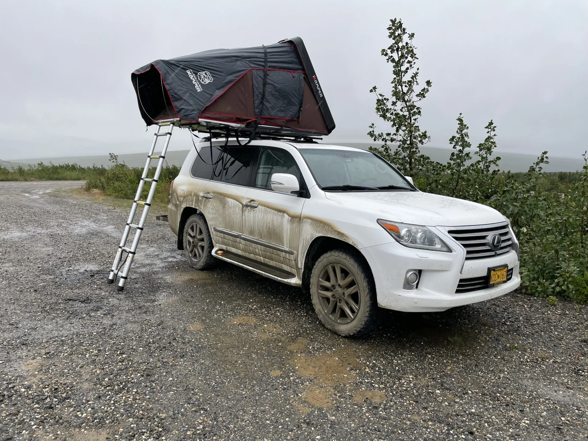

I carry all kinds of things on the OEM LX rack with Yakama rail grab and 66” round bars. I have an iKamper mini, 2 rocket boxes, a 16’ canoe and my skinny basket, mud boat, a box and 2 extra bikes (primary for bikes is a north shore on the hitch), canoe and skinny basket,… this set up is way more versatile then any of the large safari racks. And best part it comes off in <5min. Last fall I switched from the OEM LX rails to LC rails for easier loading/unloading of the canoe.
800 miles of dirt/mud/gravel with the RTT last fall above the Arctic circle. Picture of it now with LC rails.
