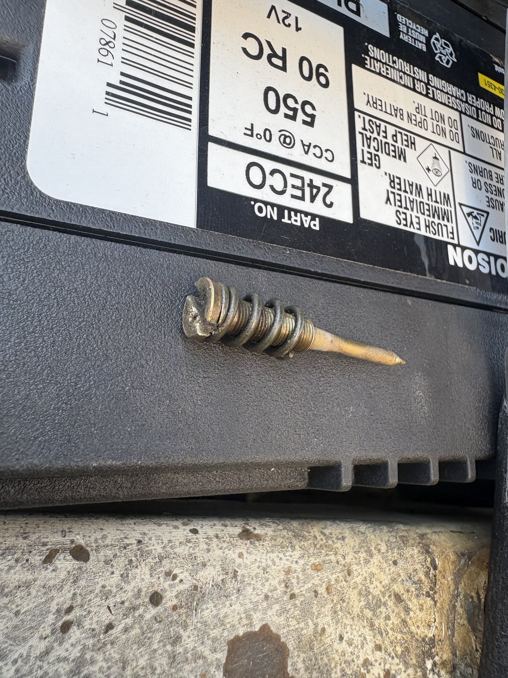

So I once again need the help of this forum, (huge thanks to the forum) my fj60 carb Idle Mixture screw (not idle speed) keeps screwing out, it’s perfect at 4 turns out but after driving the setting gets messed up. I’ve read that applying blue loctite to the threads of the screw is a solution but I was thinking wouldn’t it get sucked into the passages and gum things up? I also can’t seem to find a replacement screw (or spring). What are some advisable solutions to keep it from turning out?
I dunno - loctite, blue or otherwise, is the last thing I'd want on a mix screw. I suppose it could migrate to the idle circuit passages, then you'd be f'd.
It's most likely backing out because the spring is broken or missing. The NAPCO Carb kit will have a new spring, though the mix screws included won't work. The Keyster doesn't have the spring.
Kits are available on fleabay from Indonesia or Middle East sources.
Post a photo of the mixture screw in use and spring. USA 80-87 is different from the ROW carb mixture screws and only one I have found works in place of it.
