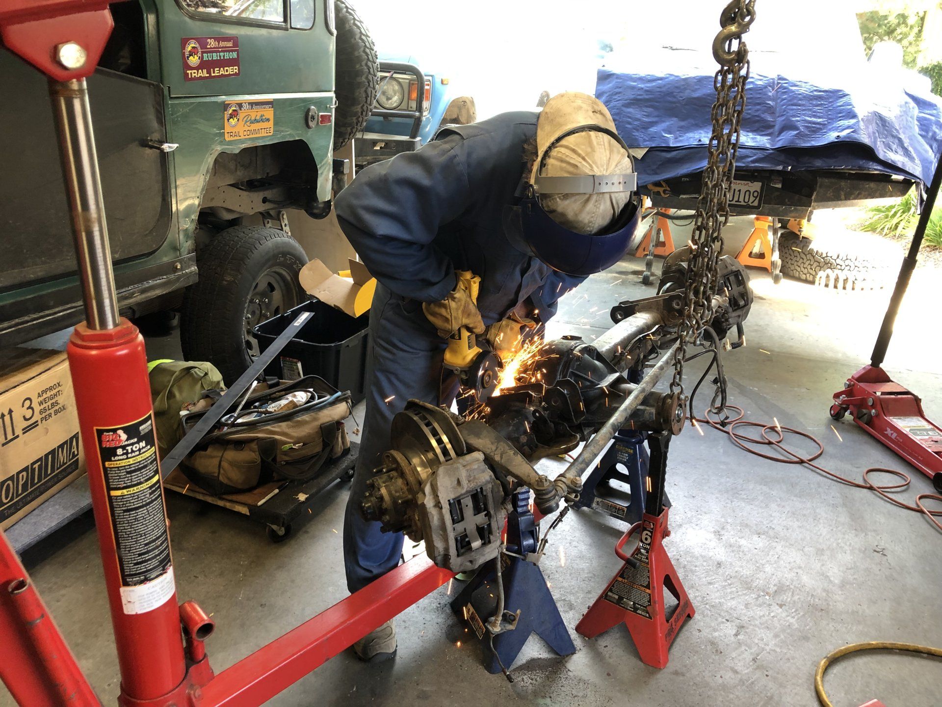

2 floor jacks to roll it out and then a cherry picker to move it around. Harbor Freight dollies are also helpful. THey are rated at 1000 pounds and a complete front axle is less than 400.
The key is to have very large (12 ton) jack stands behind the front spring hanger to hold the remains of the truck in place while the axle is elsewhere. We also blocked up the truck with timbers, in case the stands failed as a back up.
This pic has all the ingredients! HF dollies, floor jacks, cherry picker, and multiple jack stands including the 12 ton holding up the front of the 80 and @TrickyT on the grinder (this was his axle)
