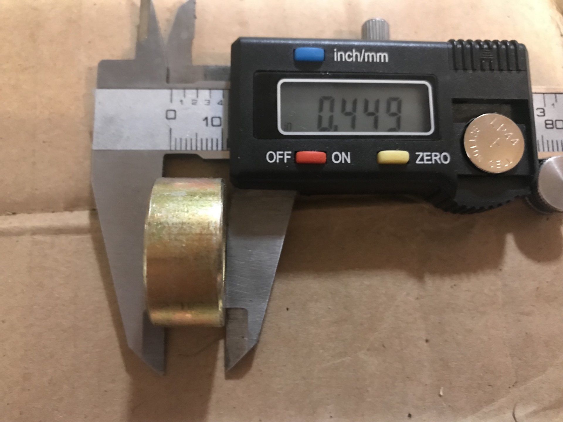

Yeah I actually ordered this kit from cruiser outfitters. The spacers were on the invoice but I cannot find them in the box anywhere. Maybe I threw them out with packing or something. Not sure. Called them and getting some sent out Monday. Slight delay but have plenty still to do so it won't slow me down any. Anyone happen to know the ID and OD I would need to find something local I could use for this.....or know of some easy subs I could source in place of them?
Outstanding. Thanks to both of you. These seem pretty specific to this application but maybe I could get something close. Gonna take another swing at finding the ones that should have been sent. I have emptied the box this stuff came in and just don't see them anywhere. CO said they would send me some Monday but hate to have them do that if I can find the originals or can come up with something that works local. Thanks again to both of you. Very helpful.
