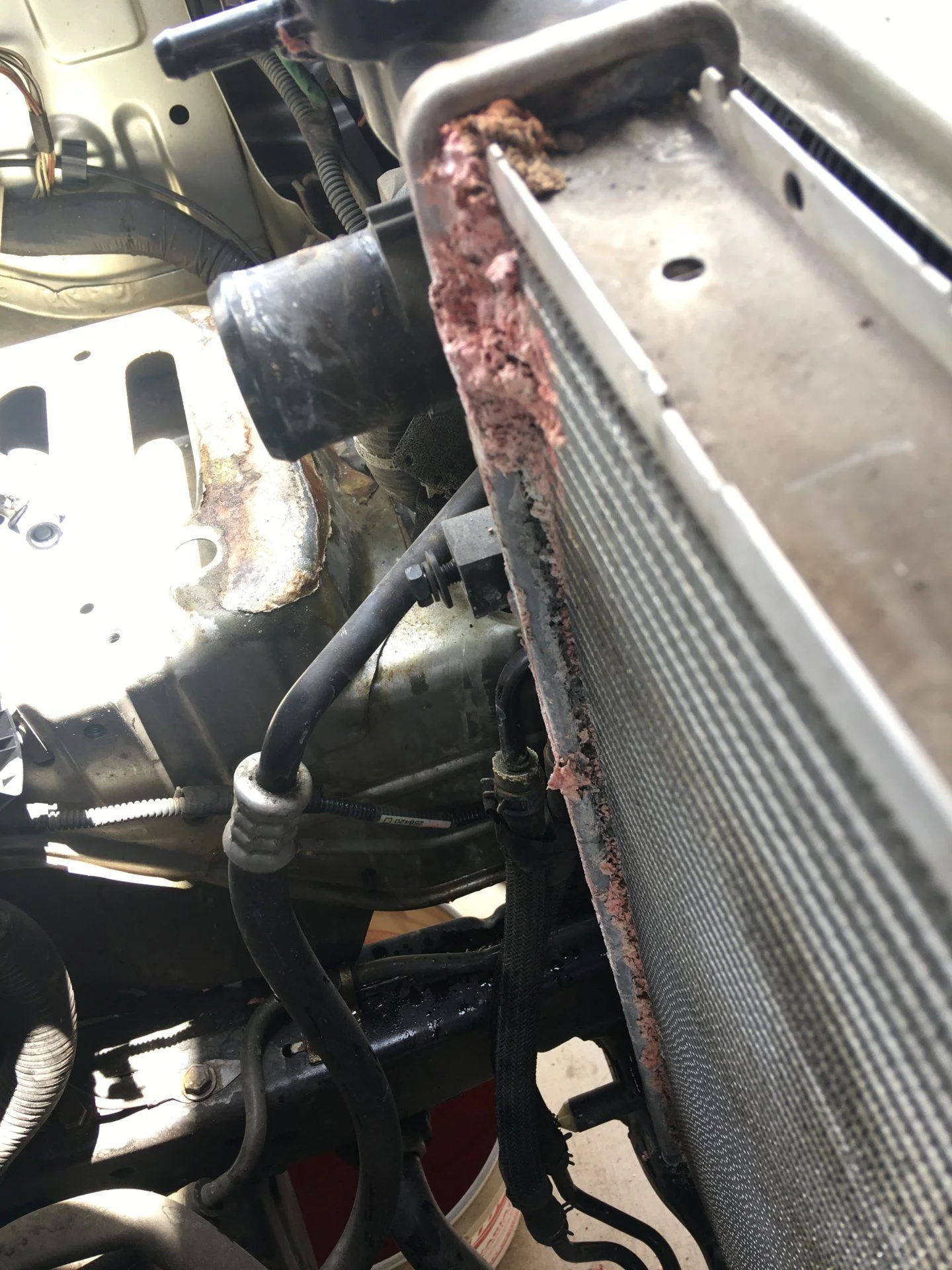

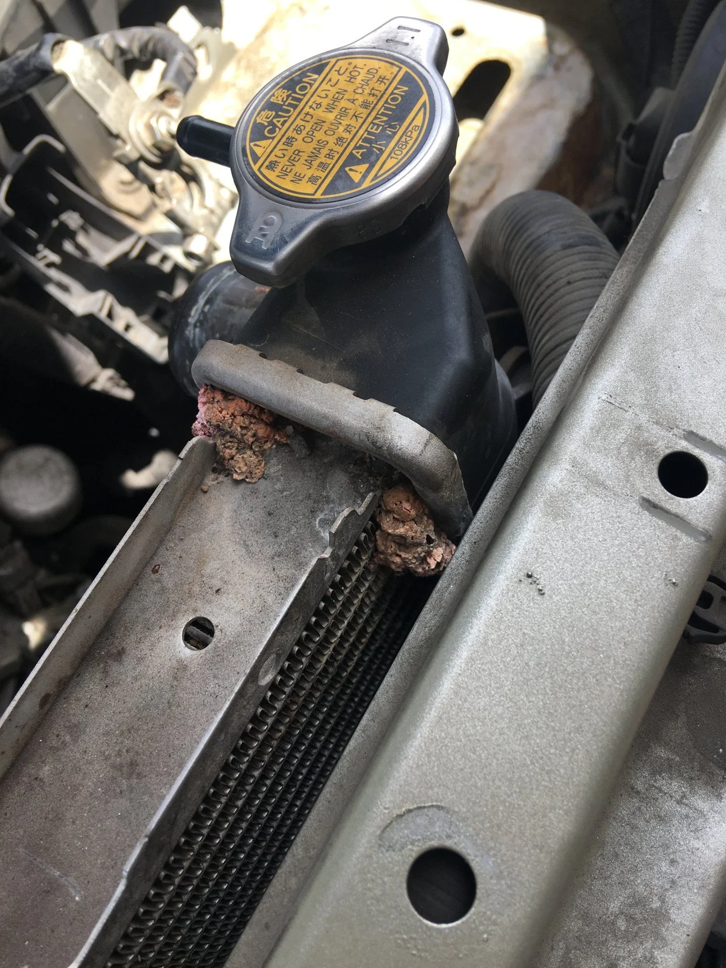

Hi mud family I’m doing the timing belt and I noticed the radiator has this pink stuff on the side and do u think should I change it or can I still reusable it? and If I need to replace what brand u guys recommended?
Silly question, you must replace! Cant remember the brand of preference, I am sure somebody will chime in with it. Easy job, don't forget to use Toyota Long Life Red Coolant.
Denso is the oem brand. I got mine on amazon. Replace the water pump too if u don’t know the condition of it. There’s an Aisin water pump and timing belt kit.
When I drained it The coolant was pink can I switch it to red becoz I already have 2 gallons of red coolants at home
Red is pre-diluted pink. I did not want to wait for the parts to fail so I replace them preventatively at 123k or so.

@chiz45 good list. Add replace the radiator cap.

@terrance lim By the way, my radiator wasn’t seeping as bad as your picture. I was probably half as bad and I replaced it. My mechanic said do not clean the pink crust because it serves as a selant. Just replace the radiator when you are ready. I still drove like 2500 miles with mine seeping.
If your radiator looks like that, you are going to have to take it off, if you are taking that off you might as well do the TB and water pump for $350 more. Check the hoses and replace them if they need it. Good luck, take pictures.
