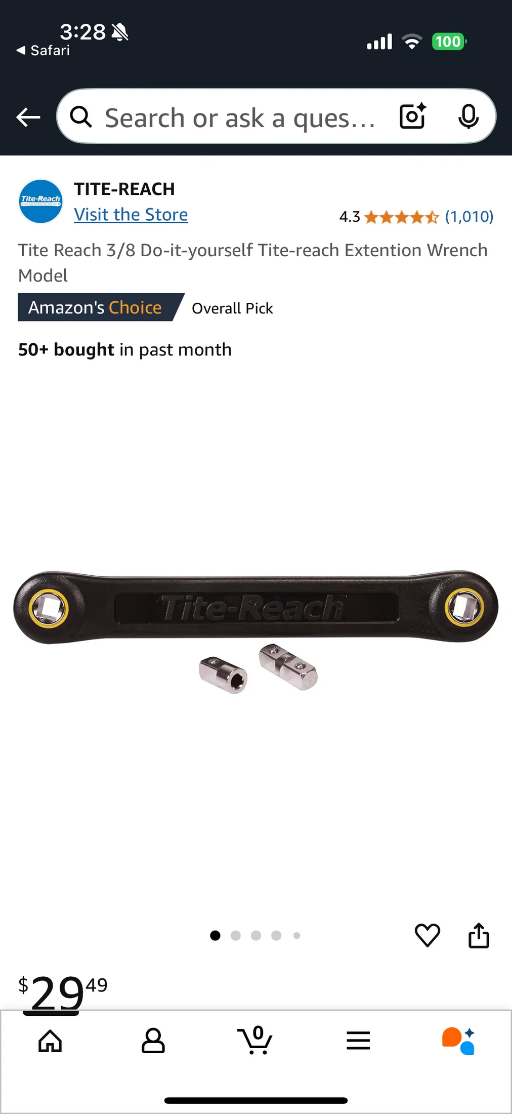

I also ordered one of those Tite-Reach Extention wrench sets with the low profile sockets.
I watched a video on Youtube by Timmy The Toolman showing how to replace the starter, and it doesn't look too hard

I forgot to mention that I also ordered a set of Gearwrench 120XP Flex head ratchets after watching Timmy The Toolman's video. He said that it would be helpful. I only have a regular ratchet set, so it seemed like a good idea. He made the job look pretty easy, but I know it will not go so smoothly for me. Every time I ever try to work on my vehicles, I always run into some kind of problem, and a lot of times it's because I don't have the proper tool, bolts hard to reach, hard to get my hands in there, hard to get enough leverage to break them loose, bolts strip, etc. It seems like it's always something. Hopefully adding these tools will make this job easier... we'll see how it goes this time around.
