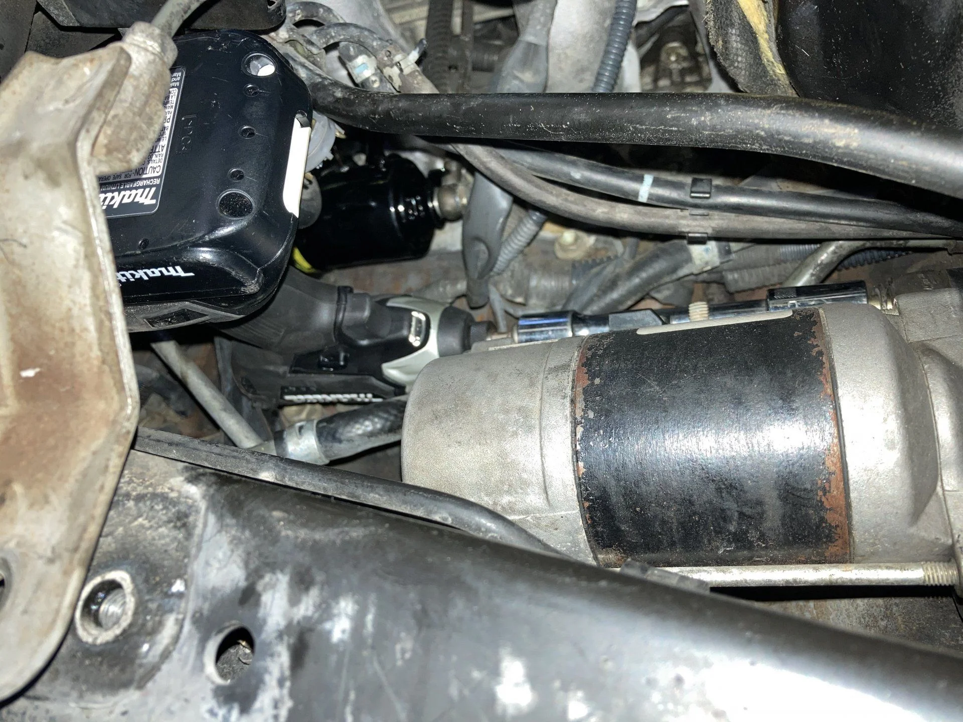

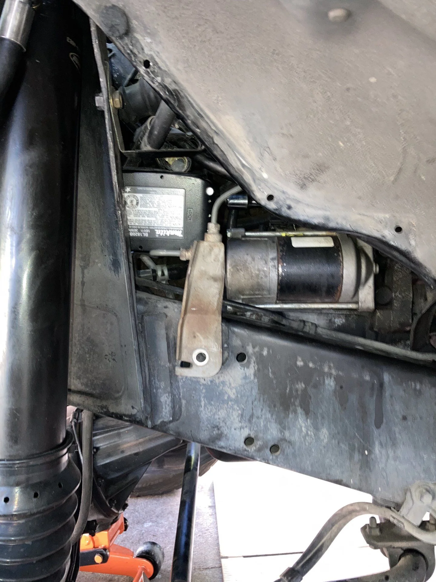

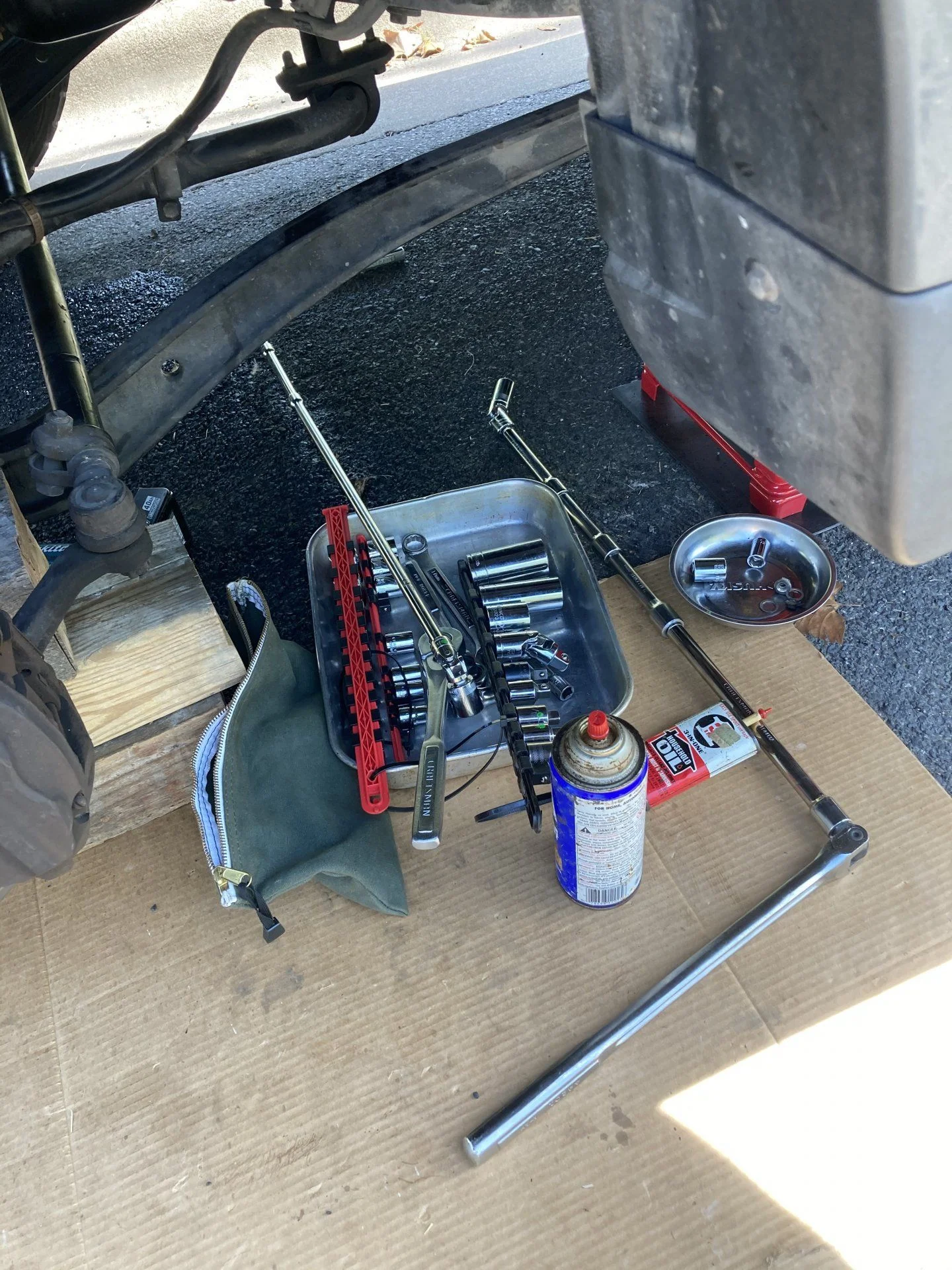

gents, i picked up a couple additional extenders for a 1/2” breaker bar and a 3/8” breaker bar and a 20” extension for it.
i am comfortably working at it going back over the brace at the differential and just resting it in the lip at the sump.
i am really cranking on it and it is not moving.
i was going to soak it overnight in some liquid wrench and try it again tomorrow. i can’t see getting an impact driver on it (edit: meaning the kind you drive with a sledge hammer) but any other ideas? also i had a bit of an adventure replacing a fuel filter in 105 degree texas heat so i am disinclined to get any kind of torch under there. would a heat gun on the head of the bolt maybe work it a bit?
any more force right now and i’m afraid the bolt might break.

Lots of extension length will absorb some twist when you try to turn it. Acts like spring.
I MUCH prefer to give the breaker a quick jerk when trying to rotate/break a bolt free. The shock will pop the thread loose, versus just applying static force. That's why impact guns are also a good thing... The starter bolts are meaty - unlikely you'll shear them if you use some technique to break them free.

that’s why no one likes extensions. i was thinking the lever arm was the same. so a solid extension would be way better than a bunch of short ones. got it.

As George says, too many extensions and the type of flex extension act like a torsion bar: it all twists. Even with an impact that many/type of extensions
and flex joint likely won't work. IIRC last time I did this I used a long 1/2" extension bar (thicker=less twist) and an impact wobble joint on the 1/2" drive socket.

Do you need those U-joint's?? I've really never had luck using them. If you need a few angles of freedom, try a wobble adapter.

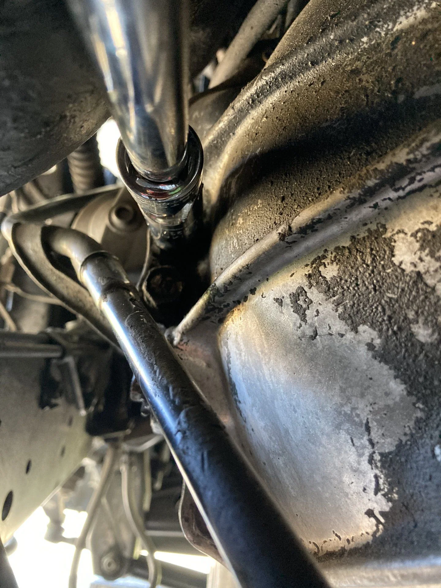

the front bolt was even worse. i mean the front one is like ****ing comical.

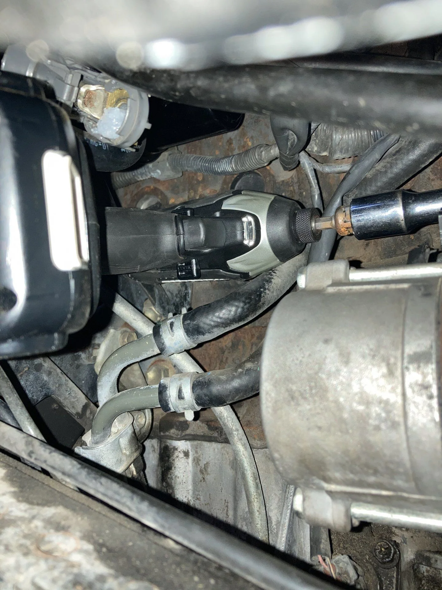

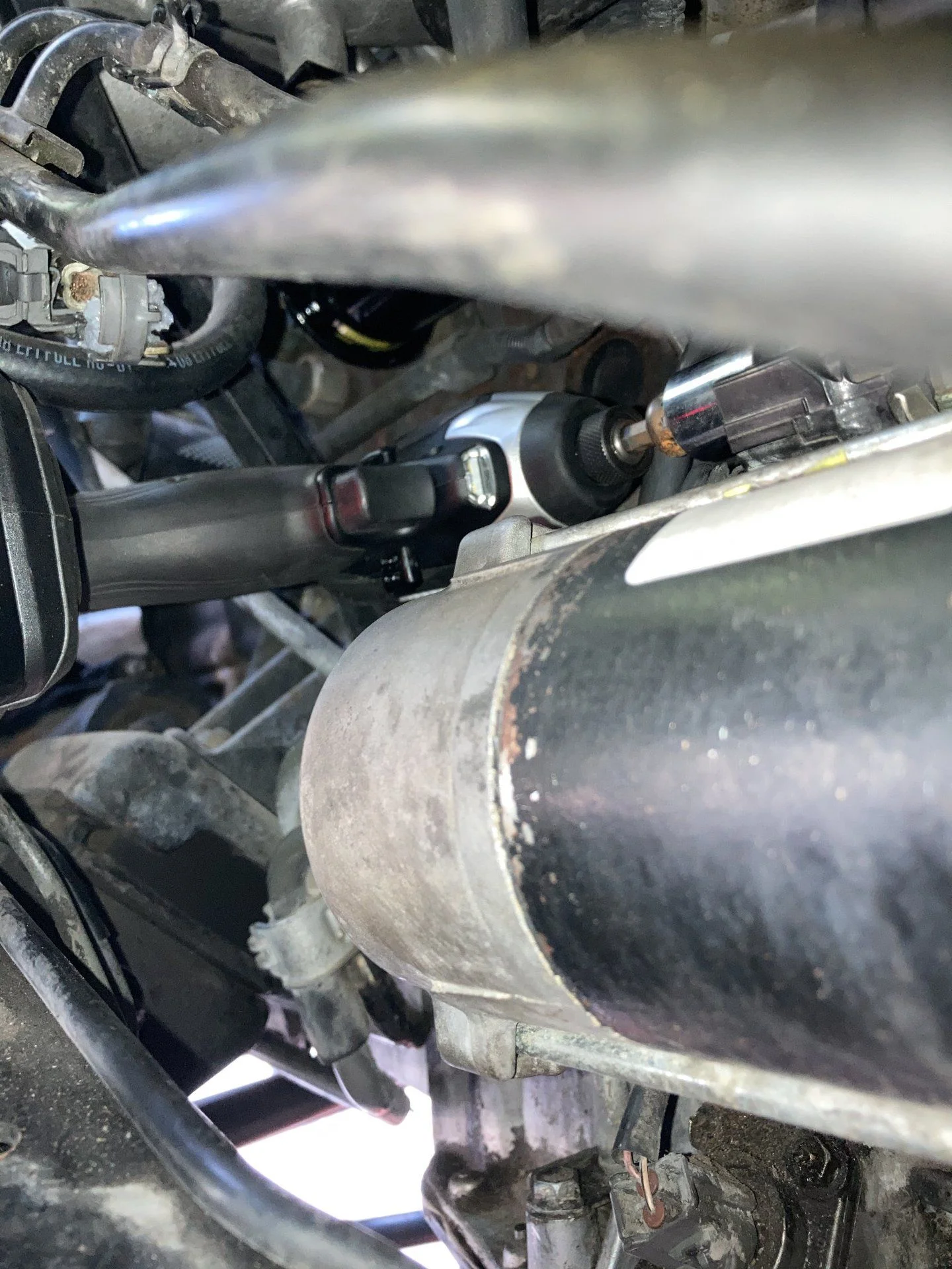

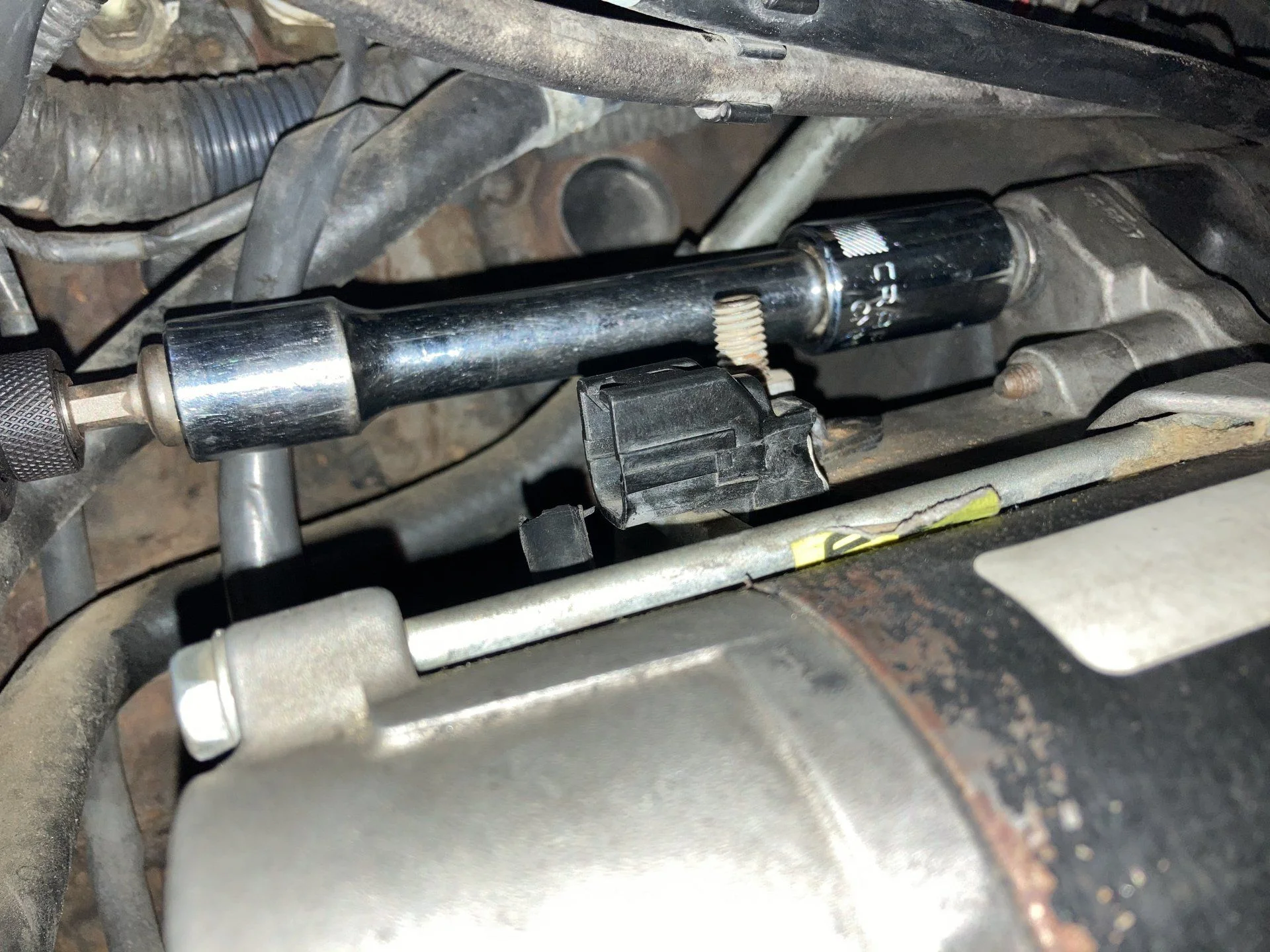

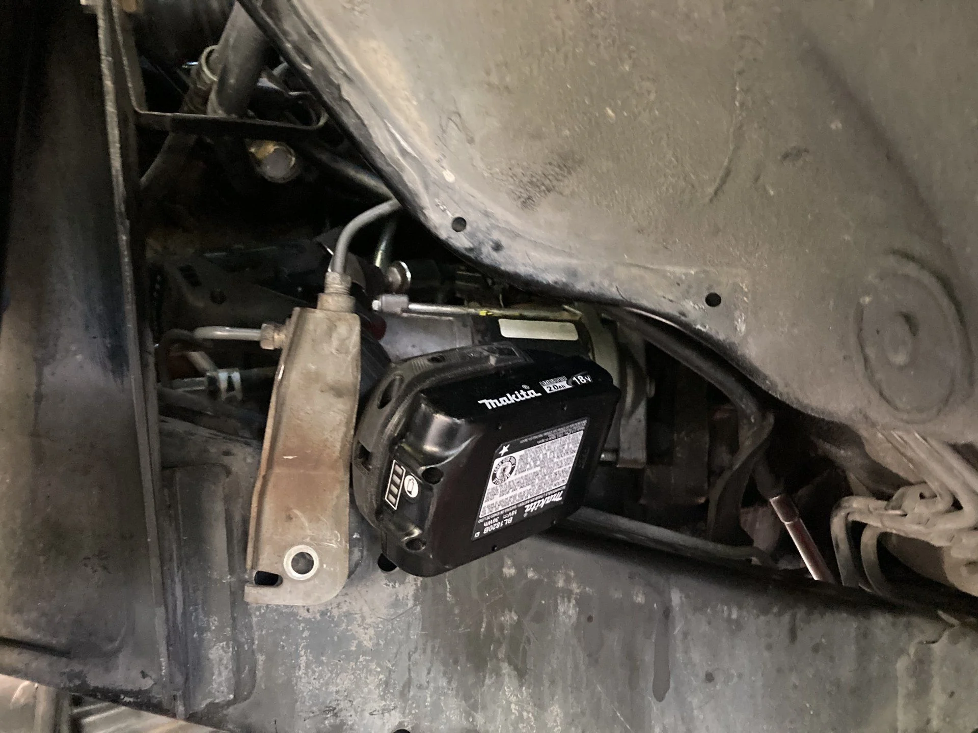

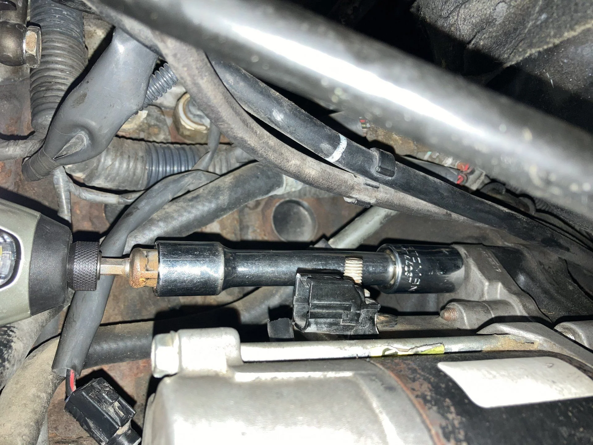

on the rear i ended up unbolting the transmission dipstick, and getting enough room to get a 17mm with about a 6” extension and a 1/2” breaker bar on it. and with my feet toward the rear wheels i grabbed the right radius arm with my left hand and gave it about the 1” clearance i had and a hard jerk and i thought i felt a tiny give. so i was then able to get the ratchet on that and work the rear one off.
the front i ****ed with it for an hour and a half. no joke. maybe more. honestly i tried everything.
then i removed the bolt at the hard lines there.
then i tried everything all over again.

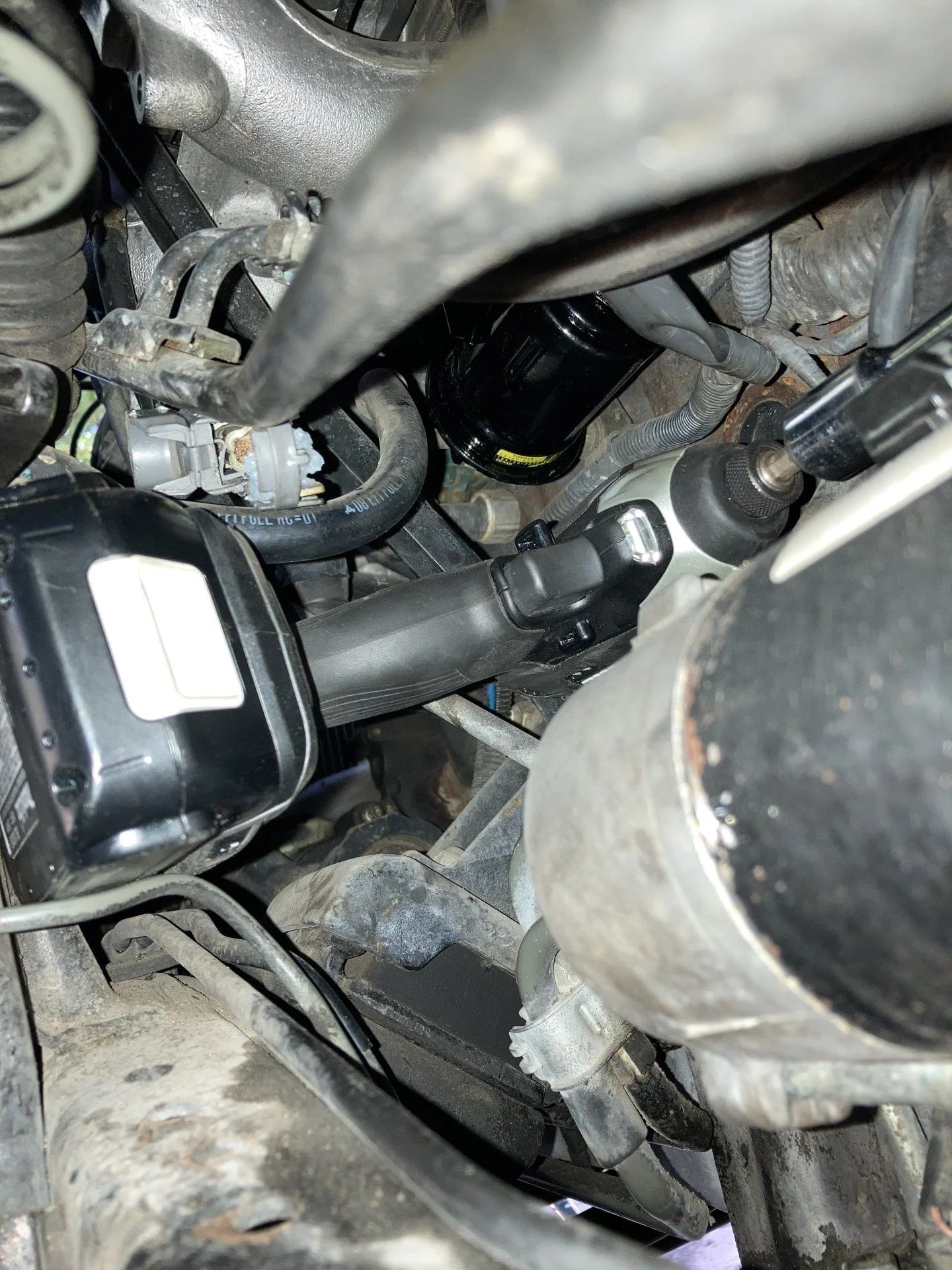

then i got really pissed and started swearing like a mofo and i just shoved my makita impact all the way in and got it over the bolt and just held the switch for a full minute and the thing finally unwound.
to get it out i had to tighten the bolt back up and work the driver back out again.

I can't really tell in your photos, but I think you definitely want to be using a six point socket and not a twelve point. In my experience, you're most likely to round off the head of a beefy bolt like that with weird drive angles using a twelve point socket than you are to snap the bolt. I also like a longer breaker bar, but I'm kind of a weakling.
thanks. those knuckles are useless in a situation like this. too much slop.
i may need to pick up a wobble adapter if i can figure out what it is.
also i think a cutoff 17mm would be really really good for the front bolt. a regular socket is too tall i think.
