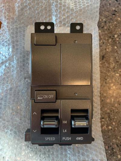

Hello All! I have a 2011 460 and tried ordering the crawl control switch 84970-60090 but the dealership claimed based on my VIN that the connectors wouldn't fit and that I need part number 84970-60100. Has anyone else heard of a similar situation as this thread only references 84970-60090 for 2010-2019 non-air bag models? What are your thoughts about 84970-60100 ??? Thank you!
Do you currently have 4 switches in the center console next to the shifter or just 2? Your rig may have had the AVS / RAHC and a PO swapped out the air bags for springs and that may be why they are telling you that. Mine had the bags swapped for springs and I installed 84970-60090 in my 2013 without issue. Order from one of the on-line vendors and you'll save some money vs most parts counters.
Thanks Bang Bang! Yes, only 2 switches on mine. I just spoke with parts desk and showed them the part they indicated I need is acutally the part I currently have and am attempting to upgrade for CC. I caught a good sales price so went with that option. If it is the wrong part I'll post on here for one of you guys! Thanks much for the prompt response. mb
If you're giving them your VIN #, then they're going to tell you that the currently installed part (non-Crawl Control) is the one and only correct part, as CC/MTS were not spec'd in the US on early 460's. Just order by the part number in this post, and don't give them your VIN, or they'll just charge you for the part you already have installed. Bell Lexus online in Scottsdale got my part no problem, mailed and received in a matter of days.
Hmm... I'm thinking of adding this too, but I got the lift done on my 2018 luxury trim and they did an air bag delete. I'm not sure if that impacts which part to order, so I haven't pulled the trigger yet...
If you have 4 switches and either of the top 2 switches do anything, order the crawl control module that has the 4 switches (84970-60070). If you have 4 switches and the top 2 do nothing then you can order either module (84970-60070 or 84970-60090).
Mine does have 4, but the left top no longer does anything I believe and the top right should still work? I'm not 100% sure, but I have had it set on sport since I bought it and haven't touched it so...
If the AVS shocks have been removed and you no longer have the rear airbags just get 84970-60090 as Bang Bang mentioned above
Mine only had the 2 bottom switches, DAC and 4WD L and H so it was easy. Play with the top switches to see if they do anything.
