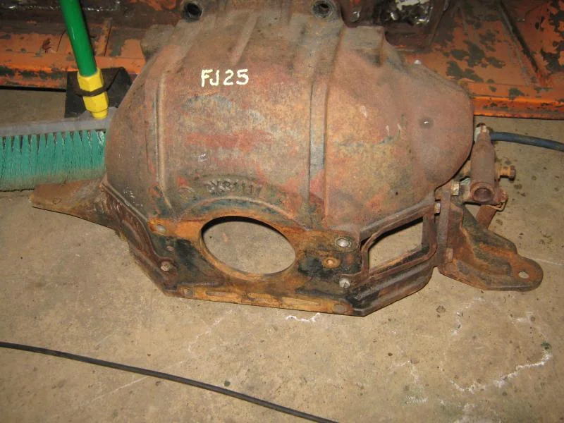

I don't give a flip 25 build.

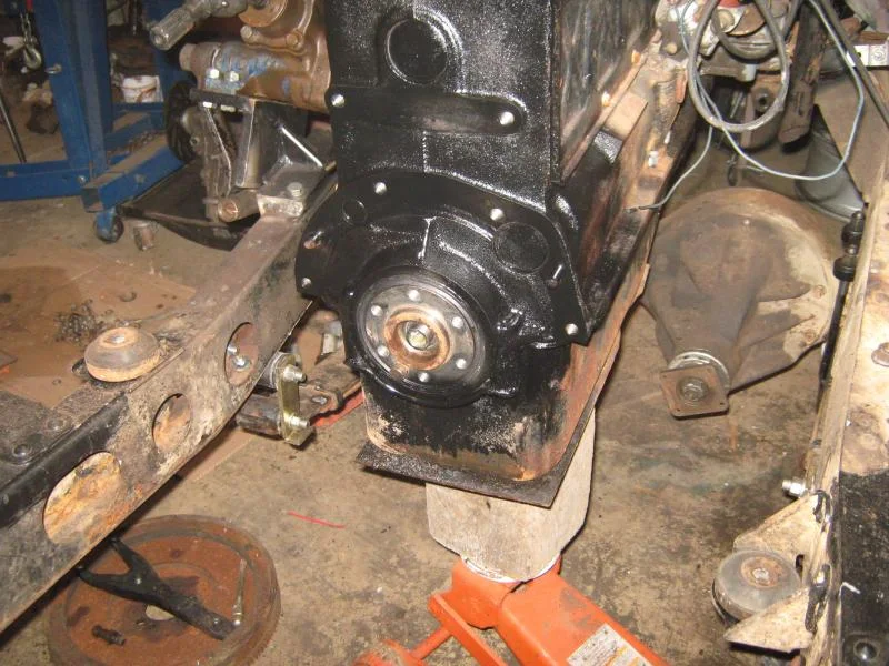

Realized I bolted this up with the FJ25 bellhousing. Gave me a chance to pull the rear seal (I love it when they shatter into small pieces when you pull 'em out ............. that's how you can tell they're original) surface the flywheel and spraybomb the back of the motor and bellhousing black.
Anyone need a FJ25 bellhousing? I already have a spare. :rolleyes:

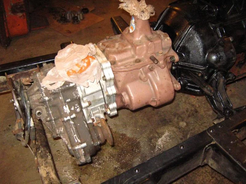

The pink tranny is back! :bounce: Albeit a bit rusty from sitting in the shed for a little while................

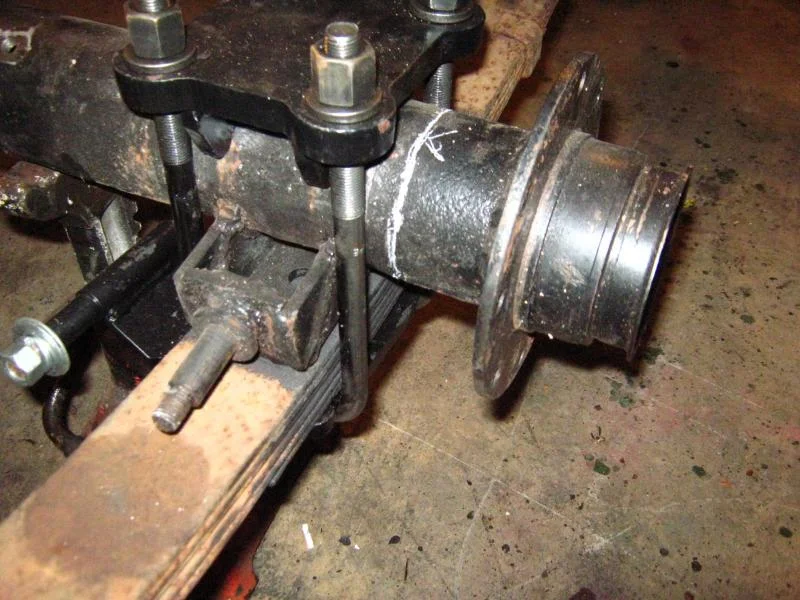

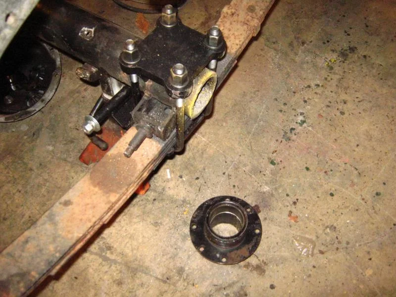

I guess I'm committed to doing a hybrid from a centered rear axle now. Wanted the centered 30 spline, had the centered housing, had the u bolt flip kit so I needed the bigger axle at the perch. Basically swapping the outer ends, stuffing the mini axles in the centered housing, hopefully get that back together this weekend.
I'm confused Jim, why the hybrid?
I bought all that hype about the 10 spline being weak............ ;) If it were stock I'd just use the centered 40 or 25 axle, but I think the 30 spline is really a necessity here with a larger tire and the SM420. The transfer is centered and very high, the driveshaft will be very short with the cv, and I don't think it would handle an offset axle combined with the height difference.

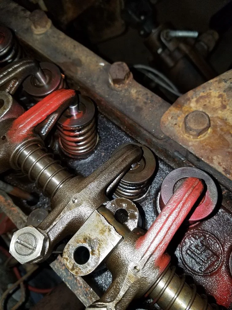

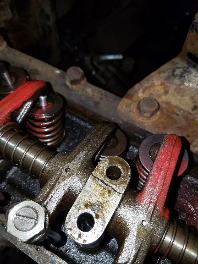

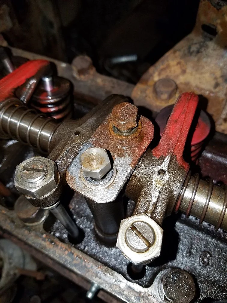

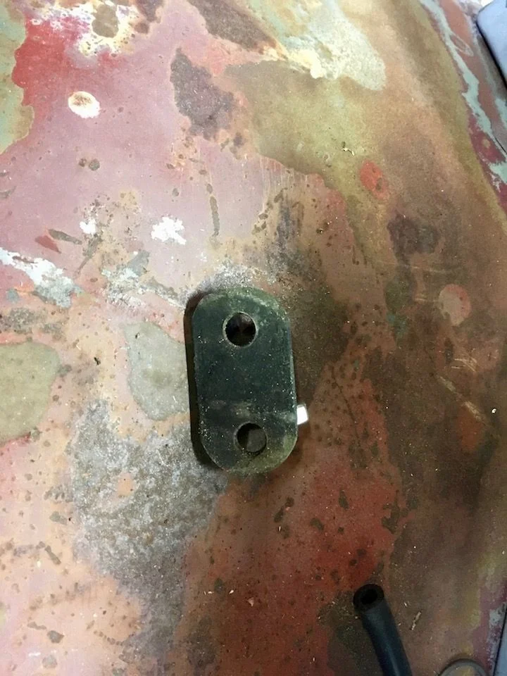

Literally have not touched this since it rolled back into the garage....a while ago. Had the garage warm, so dug into the motor to regasket. Found this "shim" on the valve train.........who would want to reinforce the rocker tower? Must be a shim for some reason............:worms:
So just how does someone break not one, but the two, center rocker shaft towers? Really, I can't think how you can break just the center tower. Attempt to lift the motor with them maybe? :doh:
Were your towers broken as well? I've bent plenty of pushrods but can't picture anything that would break that piece except a faulty installation.
