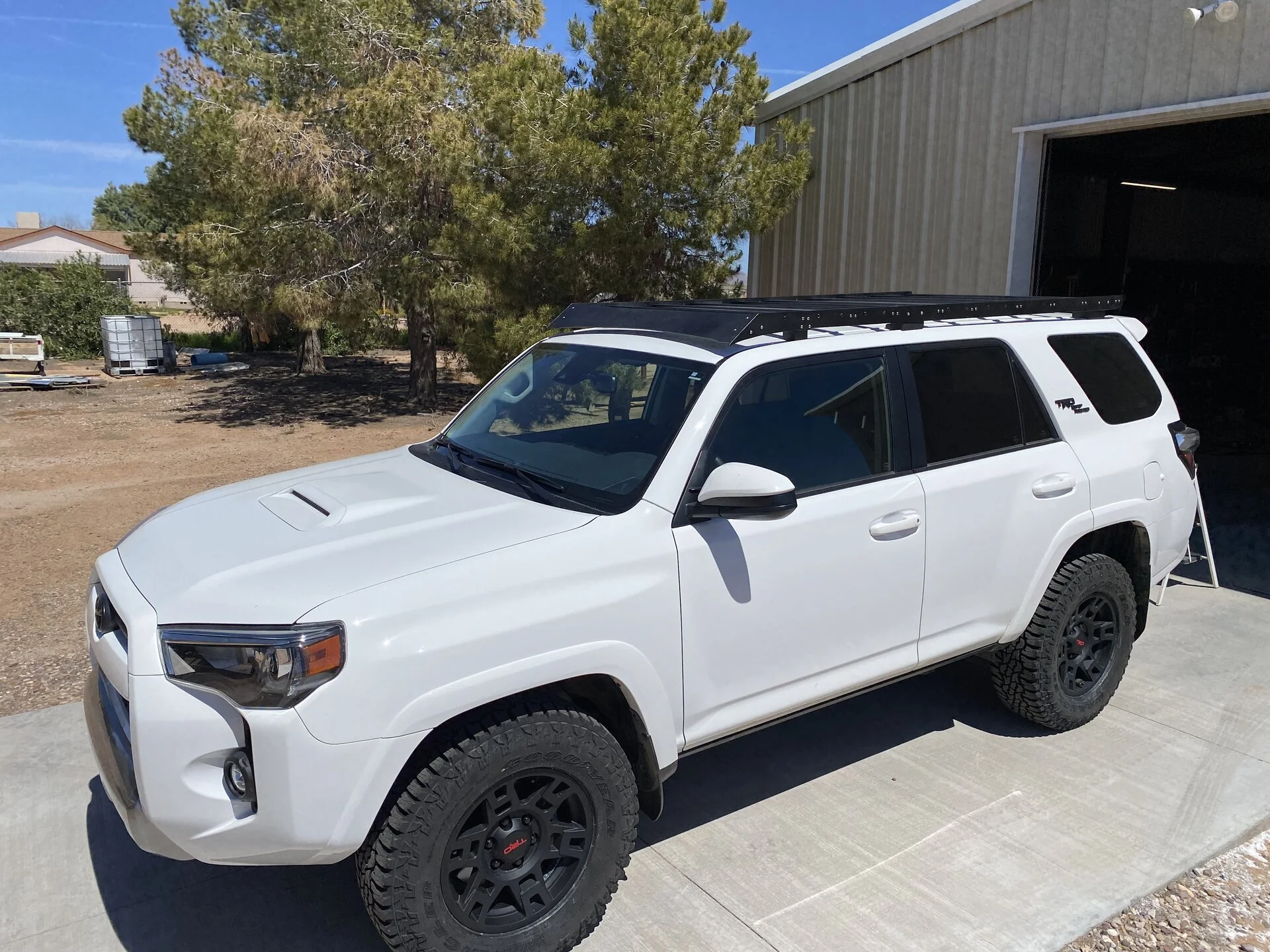

Kudos on the rack!
From the photo, one couldn't tell if it was a professional aftermarket rack or not!

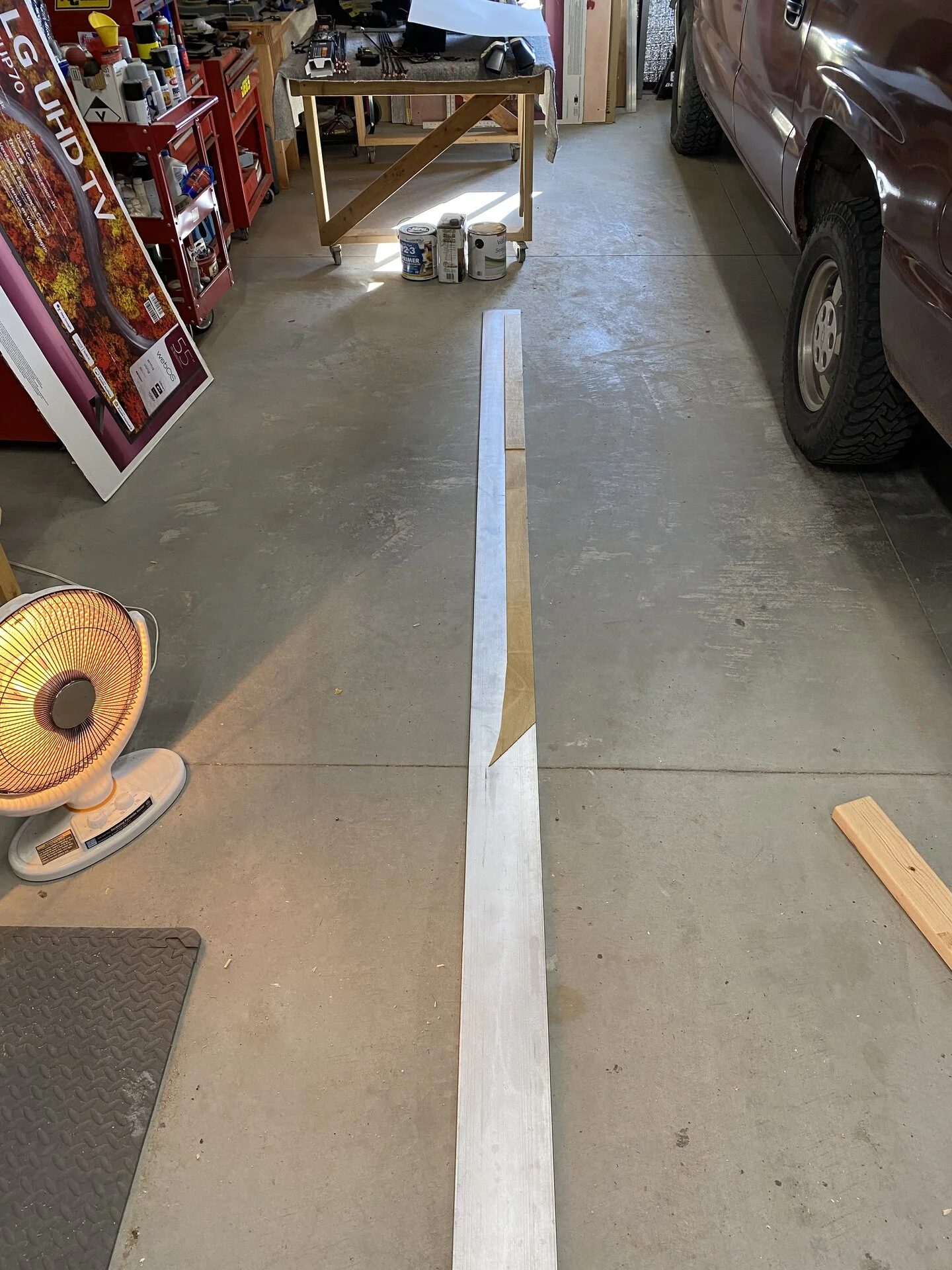

The brackets were made out some phenolic material I had shaped to fit the contour of the roof, then I covered them in white vinyl, and connected a 4" pc of 2"x 4" angle to connect the sides to.
Once I had the sides mounted where I wanted, I trimmed the height of each one, and bolted it together.
I then installed the U channel that the bars are fit in and bolted. At the end of each cross bar I cut and tapped in a pc of Azec, so when I cranked down the bolts it wouldn't collapse.

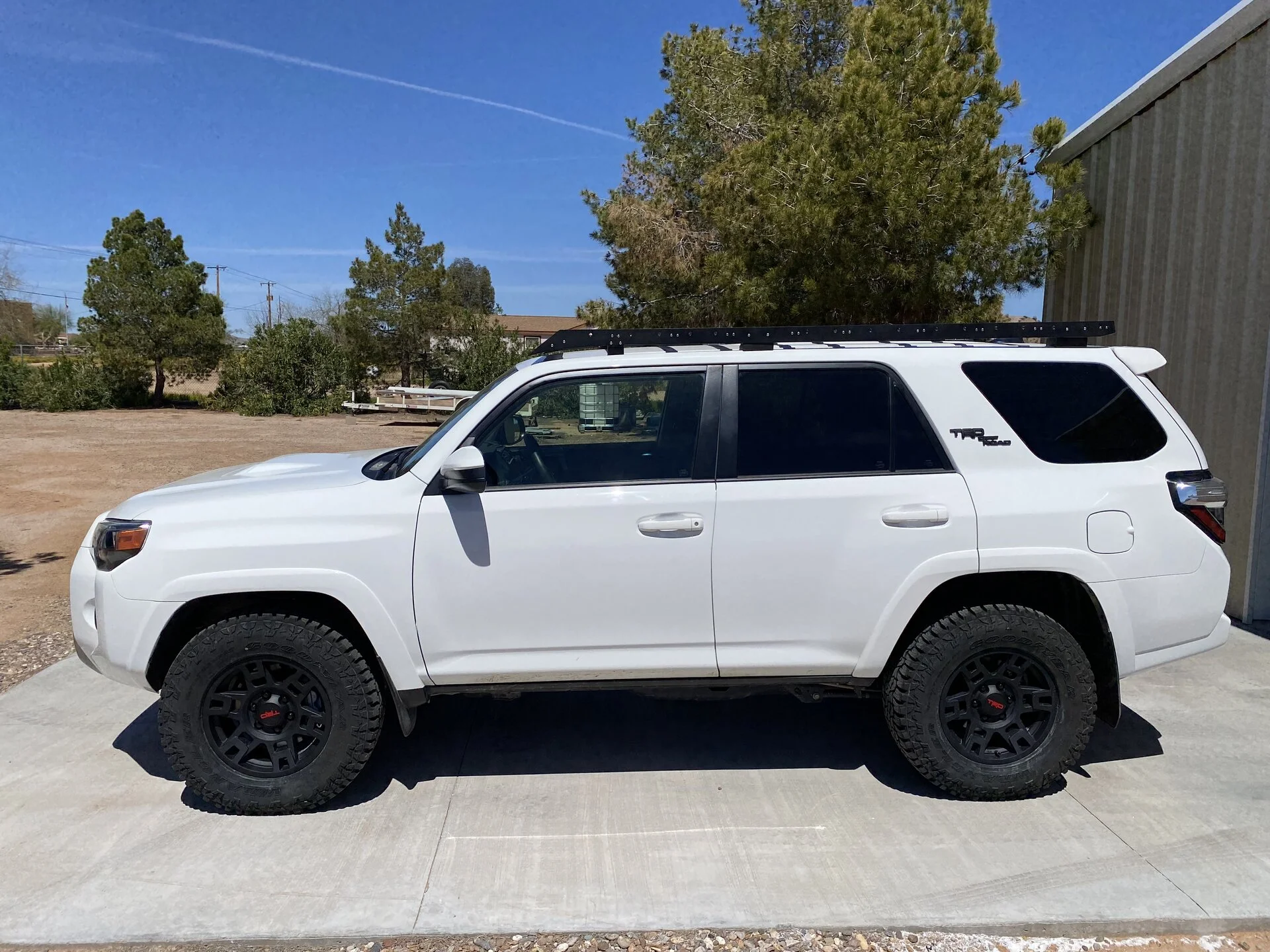

Hey SFM- thanks for the great thread and sources. I was all set to by a Sherpa, but did not like the <48” and I wanted the cross rails below the side bars. I bought a 12’ x6”-1/4” plate and could get both side rails with the drop front, and the front wind screen. At about the half way point now and liking it- thanks again for the idea and details
All done - accomplished three objectives - 48” spaces between side rails, cross rails recessed 3/4” from side rails to prevent cargo slip, OTD saved $1,000
Not so sure about the bed liner holding up, but we will see ( also got some more appropriate wheels and tires )
