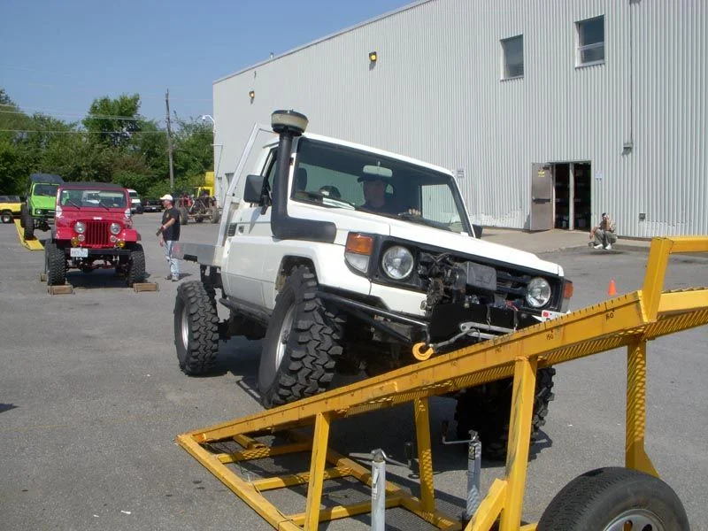

I was at an 4X4 club twist off today, tried my truck on the ramp, got an RTI of 508, not even close to the suzukis but it was fun to do. Limiting factors - front tires stuffing into the coil spring towers. More than enough articulation for me though.
