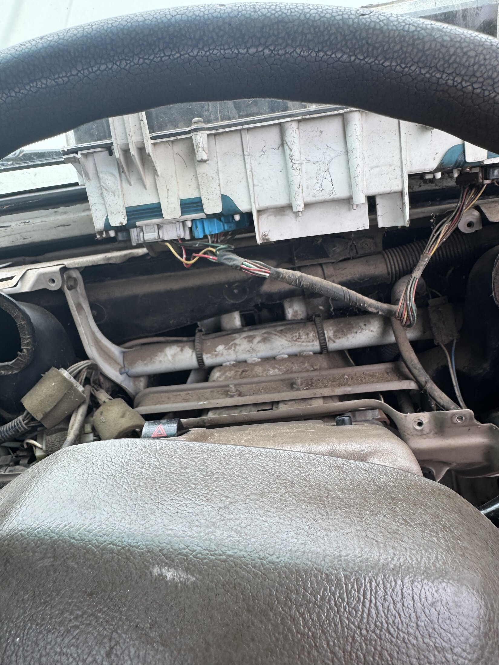

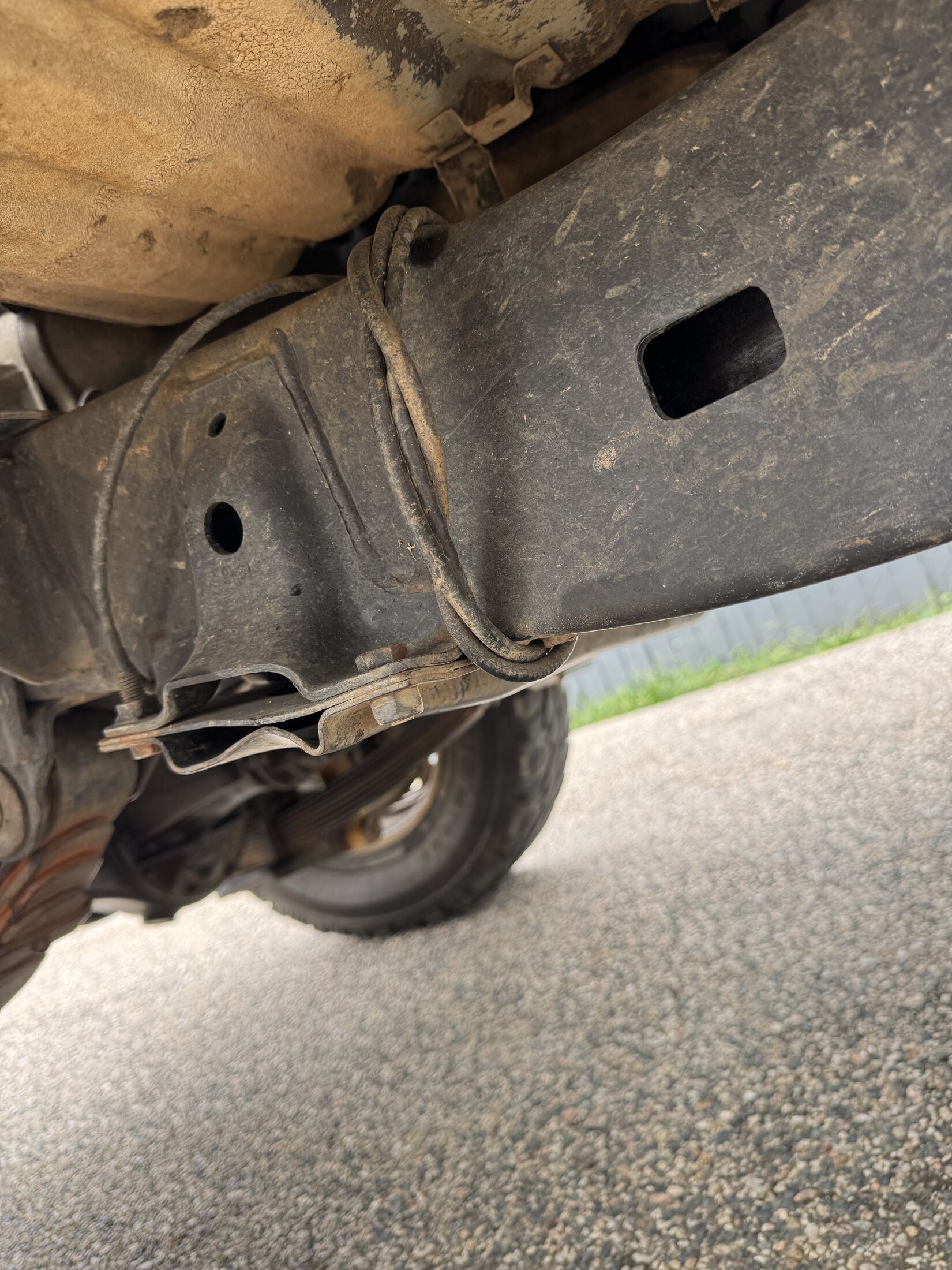

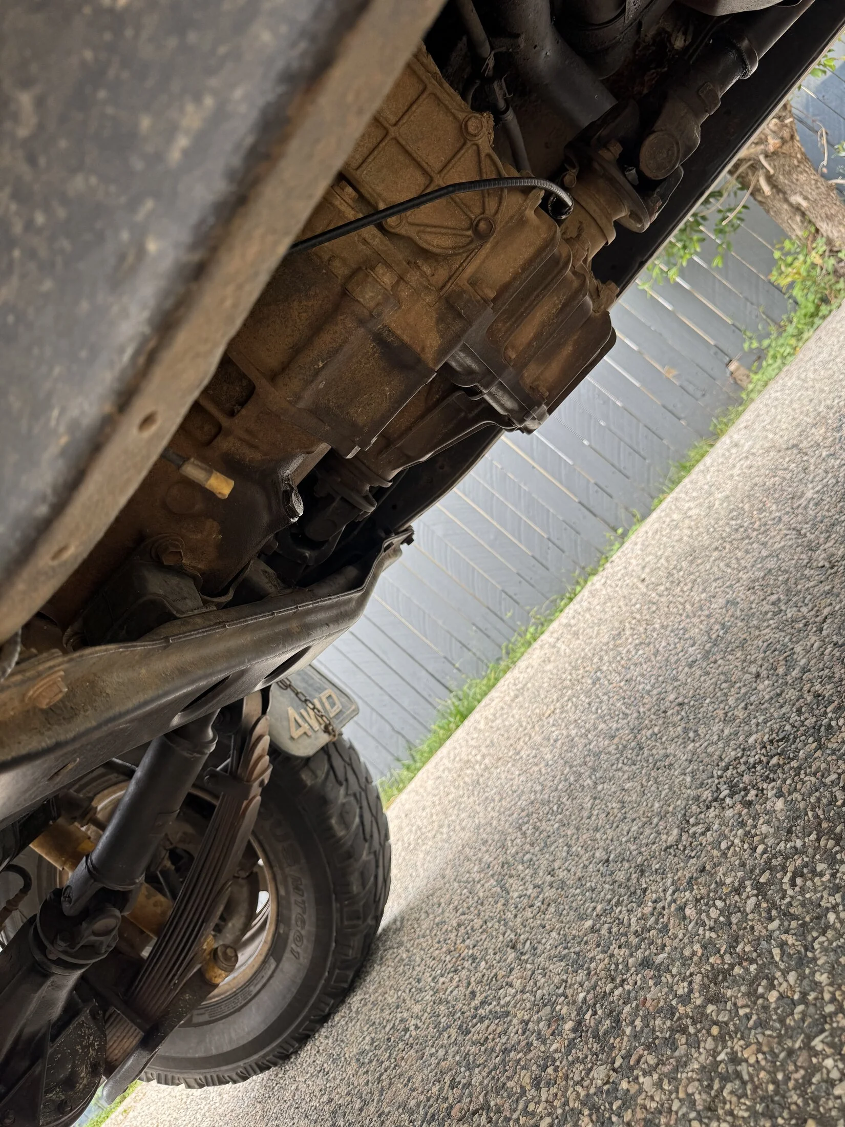

Hey guys,
I recently bought this hzj75 and the speedo doesn’t work the previous owner had pulled the cable out and had it wrapped around the chassis, I cannot seem to figure out where the new one is suppose to run, this is right hand drive in aus, thank you
Leaves the transmission.

Curves around above the steering column, and into the back of the instrument cluster.
I can get photos if you can't work out any part in particular.
