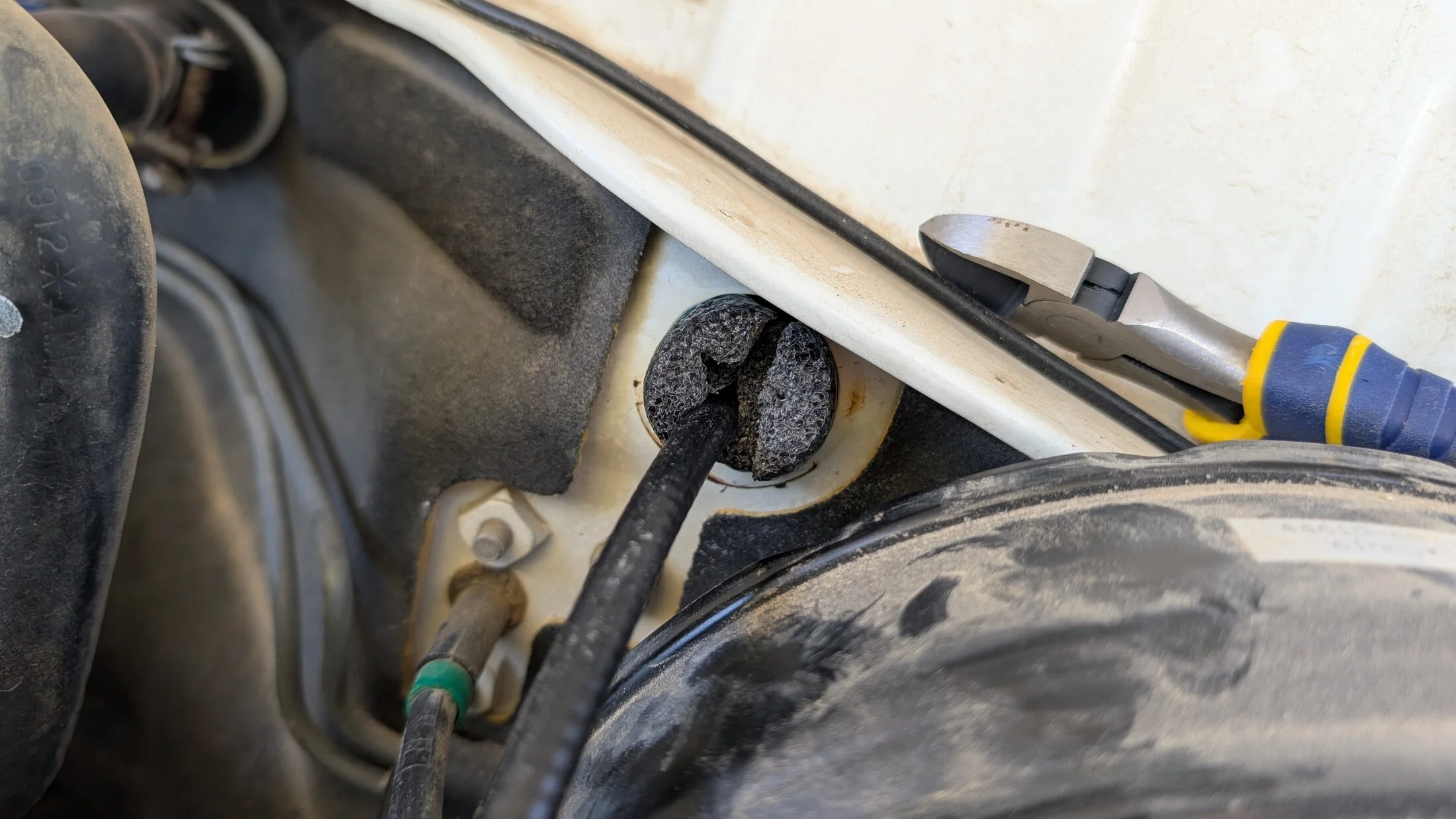

It seems to fit and work. However being a slightly generic aftermarket cable, it doesn't have the fittings for routing the cable on the clips on the body and some of the beefier anti chafe wrap sections. And of course, it doesn't have the built in firewall grommet which is annoying. I made a quick and dirty grommet out of some backer rod, but I'll need to get a generic grommet to put here I guess.

I just forced my new one through the old grommet. It tore but I just said **** it.
