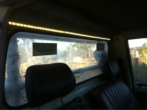

Hey everyone Still wating on some more parts hopefully will be up and running next weekend (: just been muckin round tidying her up and adding some spotties Led strip for interior light straightened mudguards and put some mudflaps on
