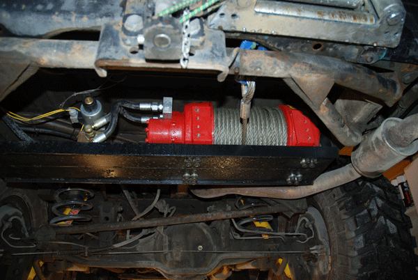

One of the Icelanders was running a Runva hydraulic with a reservoir for extra fluid. He seemed to have no issues while winching, but again had increased his fluid volume.
I believe he is powering a separate hydraulic pump attached to his PTO port on his transfer case. His transfer case came with a PTO, being from Iceland, they have access to such things.
sorry, guy I was thinking of was from Norway:
https://forum.ih8mud.com/80-series-tech/437049-my-heavy-duty-hydraulic-winch.html
