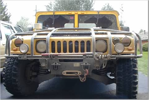

I had the 12k on my H1 and it was great. I know a lot of people who have different experiences but mine was a positive one. The PS pump never failed and the winch never stopped. I didn't use it a whole lot of times, which may account for the lack of pump failure, but when I did use it I really needed it. Yes, it was slow but when a truck as heavy as an H1 is is stuck in deep mud I think most winches would be somewhat slow. There were some times when I didn't think it would pull it out, but it never failed. I really liked how the hydro winch could fit in between the frame rails on my truck and the electics would stick out effecting the approach angle. Later I found that there were some electrics including the MM that would fit in there too. Here's what it looked like.
