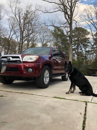

@jtmosca - - If it were me, and I am the WRONG person to ask, I would sell the 80 and the Highlander and just by a V8 4Runner, 4th Gen and use Drive, not Overdrive when you pull your camper. If it is only 3500 lbs loaded, you will be fine - I have pulled that much and it pulls great. Get a Scan Gauge II and watch your Transmission Temps for hills if needed.
Something like this for about $13K:
Pick up the Dobinson 3" heavy rear springs and the Bilstein 6112 front end set to about 1.5" and enjoy the simplicity of life with 1 car vs 2 or 3.
Take the extra $$ and put it in savings.
