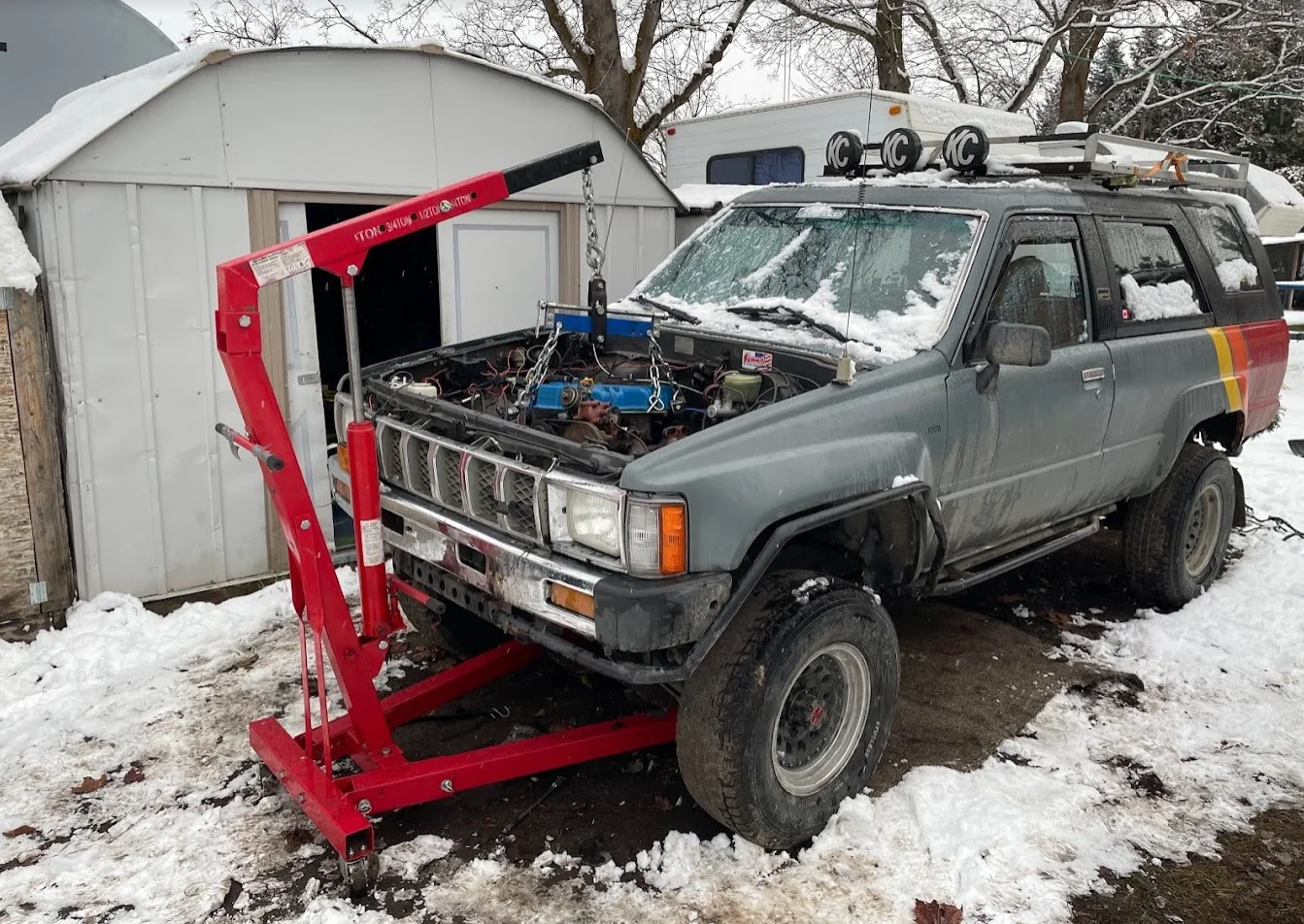

I have searched far and wide on how to properly set the timing on the injector pump of my 1984 2L diesel. I have yet to put the motor in the truck but when painting the motor, I failed to mark the exact rotation of the pump. I just put it back in completely centered, but I am not sure if that's okay. It looks like you have to use a dial guage to time the pump, and that is all I could figure out. Are you able to time it by ear while the engine is running? (like on a good ole' 22r). Thanks!

is going in this:
If you look very carefully (may have to remove paint) at the pump outer ear and rear timing cover, you should see a couple marks. Those are for setting base timing. Even a mm from that in either direction will make your motor run like crap.
You need to put a dial gauge indicator into the back of the pump (toyota SST) to set timing per the manual's instructions.
