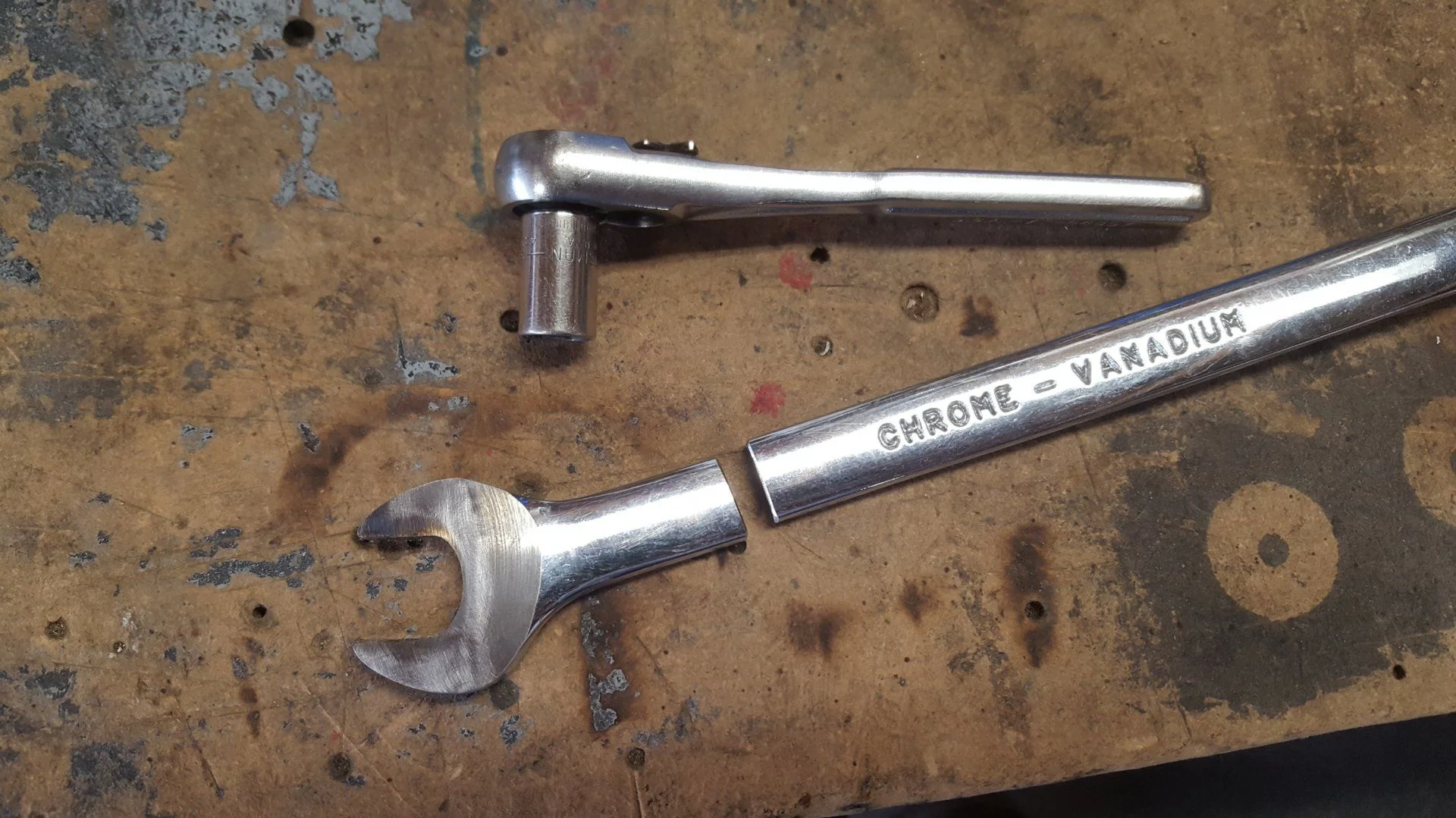

Had to shorten and narrow a 17mm open end wrench to adjust things, but it's nice and tight now.

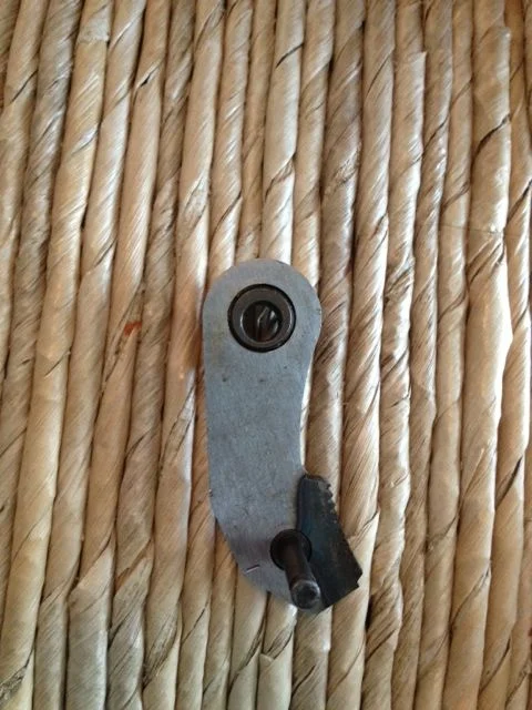

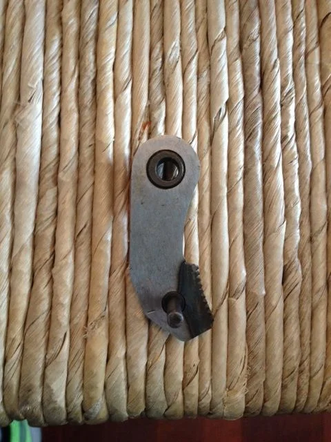

Does your steering wheel move up and down vertically a quarter inch or so? If so, your tilt column locking mechanism is probably loose. Fortunately this is one of the cheapest and easiest fixes you'll ever do to your 80.
1) Remove the clamshell behind your steering wheel
2) Loosen the nut noted in the picture
3) Rotate the nut noted in the picture until the up and down play disappears
4) Tighten the nut from step 2 to 52 inchpounds (not too tight or it will bind)
5) Replace the clamshell
6) :beer:
Why does this work? The tilt column is held in place by two pawls with teeth that engage. In order for the connection to be tight, the teeth have to engage just right with significant pressure. This adjusted by a rotatable offset bushing in the pawl:
When you rotate the nut from step 3, your're rotating that offset bushing and changing the way the teeth mesh. Notice the offset hole is in a different position from the previous picture to the next picture:
Apparently, over time, this offset bushing rotates on its own and the mechanism becomes loose. Aside from being vibrated for 20 years, the fact that the old grease becomes sticky probably has something to do with it. Basically, every time the tilt column is used, the sticky grease rotates that bushing until the column is loose. I pulled the whole mechanism apart, cleaned, and regreased. That probably isn't necessary, but you can do it if you want extra cruiserpoints. It's been over a year since I did this and my column still has no play and has not needed readjustment.

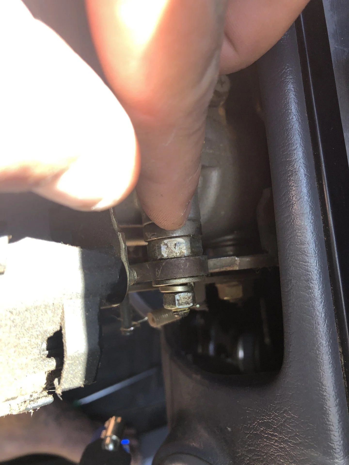

Hi mate this bolt here do I tighten it or
bryson
I do stuff.
SILVER Star
Jan 3, 2008
1,297
Utah
That assembly rotates and adjusts for slop in the tilt mechanism. The larger hex near your finger is how you adjust the eccentric. The smaller nut with the lock washer under it needs to be tightened once the adjustment has been made. The steps you need to take are outlined pretty thoroughly in the first few posts of this thread.
