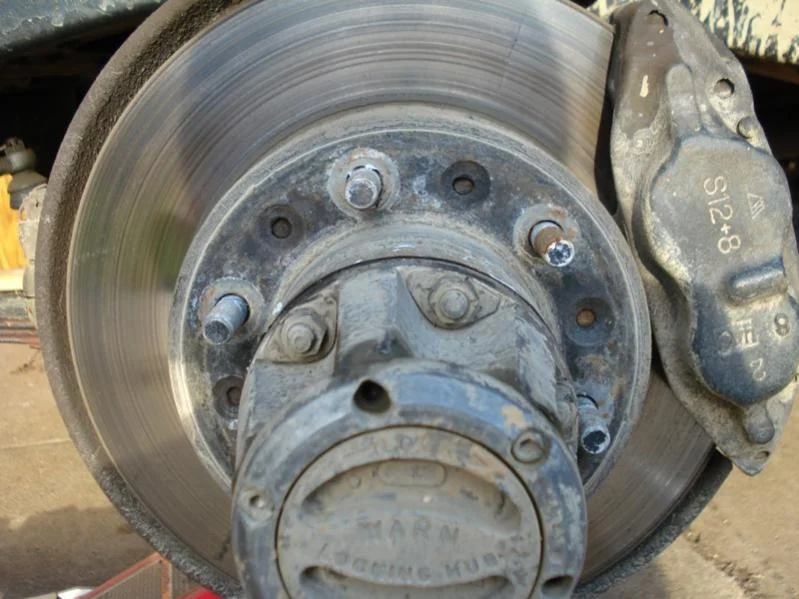

Thanks guys. I thought i would need to come with some more info/pics to get the assistance from you all I needed. Will get some pics and more info and report back this weekend.

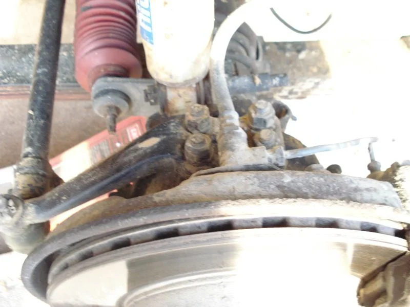

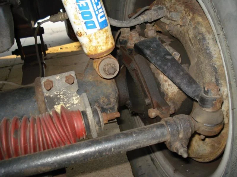

is the steering arm cut? if so it may be a mini setup
let me know if this helps.

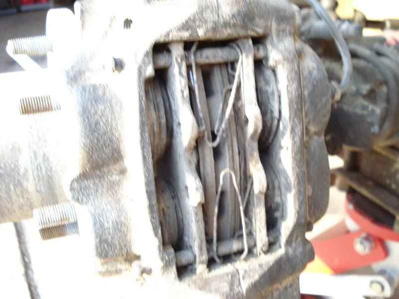

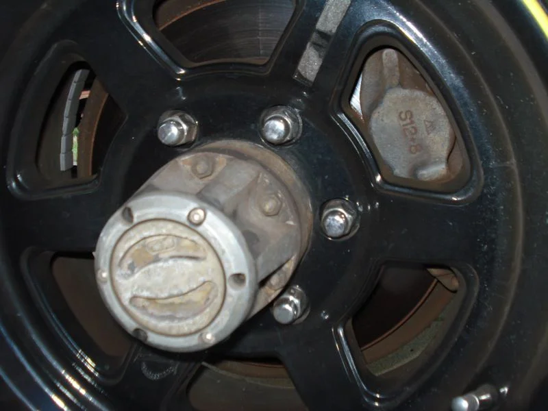

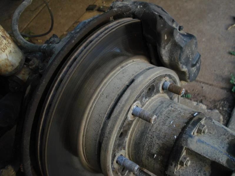

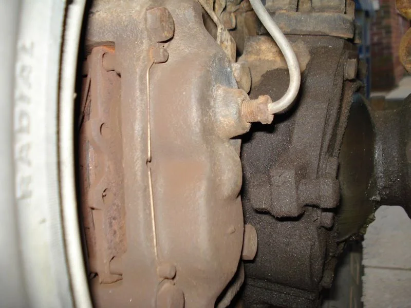

That appears to be a mini set up. If you guys look closely at the pic of caliper you can see the discs are vented. It is not one of the aftermarket drum conversion set up because it has backing plates. I am not sure of year but I also do not know if it matters on the mimi stuff.

Well you have 08/75-07/80 rotors and wheel bearing hub assemblies....early style.
Late model would be 08/80 and later. :meh:
Measure the pattern on the steering arm studs and compare it to what you find here <---- this is a link
They look like small pattern, 11mm stud, 12/78 and earlier knuckles/steering arms to me... :meh:

If I am looking to replace rotors and calipers, then I think I got the info I need, 75-80 rotors. It also looks like I have 86-88 calipers for vented rotors from the info in the thread below

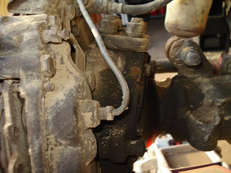

However, it would be a really good idea to figure out a means to secure the brake line and hose that is floating between the knuckle and axle, as it is not outside the realm of reality that it could fatigue at a junction and create a zero-brake pressure scenario for you at a most inopportune time.

Ok, so I am looking at the rotor and realized that it does not just pound off once the caliper is removed. I have only done brakes on my late model Nissans that the rotor just goes over the wheel studs and is essentially held on by the weel. I have to remove the hub don't I....
and I can't see how the caliper pistons are retracted to fit new pads. Maybe just easier and not much more expensive to get new loaded calipers.....
The rotor is removed by first removing the caliper from the knuckle, and then removing the wheel bearing hub assembly from the spindle so that you can remove the six 14mm head, 10mmx1.25 pitch thread bolts that secure the rotor to the wheel bearing hub. You can see the ends of them in your picture after the wheel was removed.
Pistons are easily pushed back into the caliper for new brake pad fitment by using a c-clamp style vise grip and pressing on the old brake pad.
