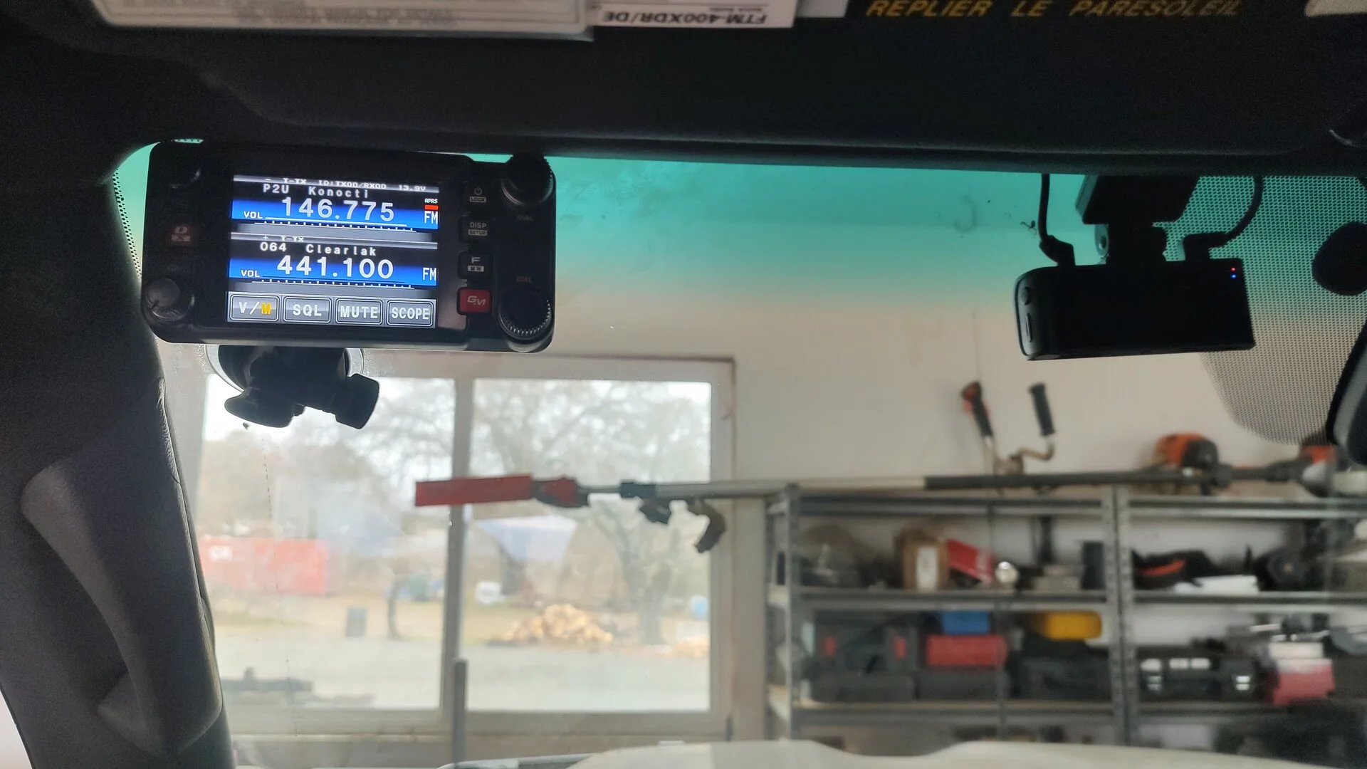

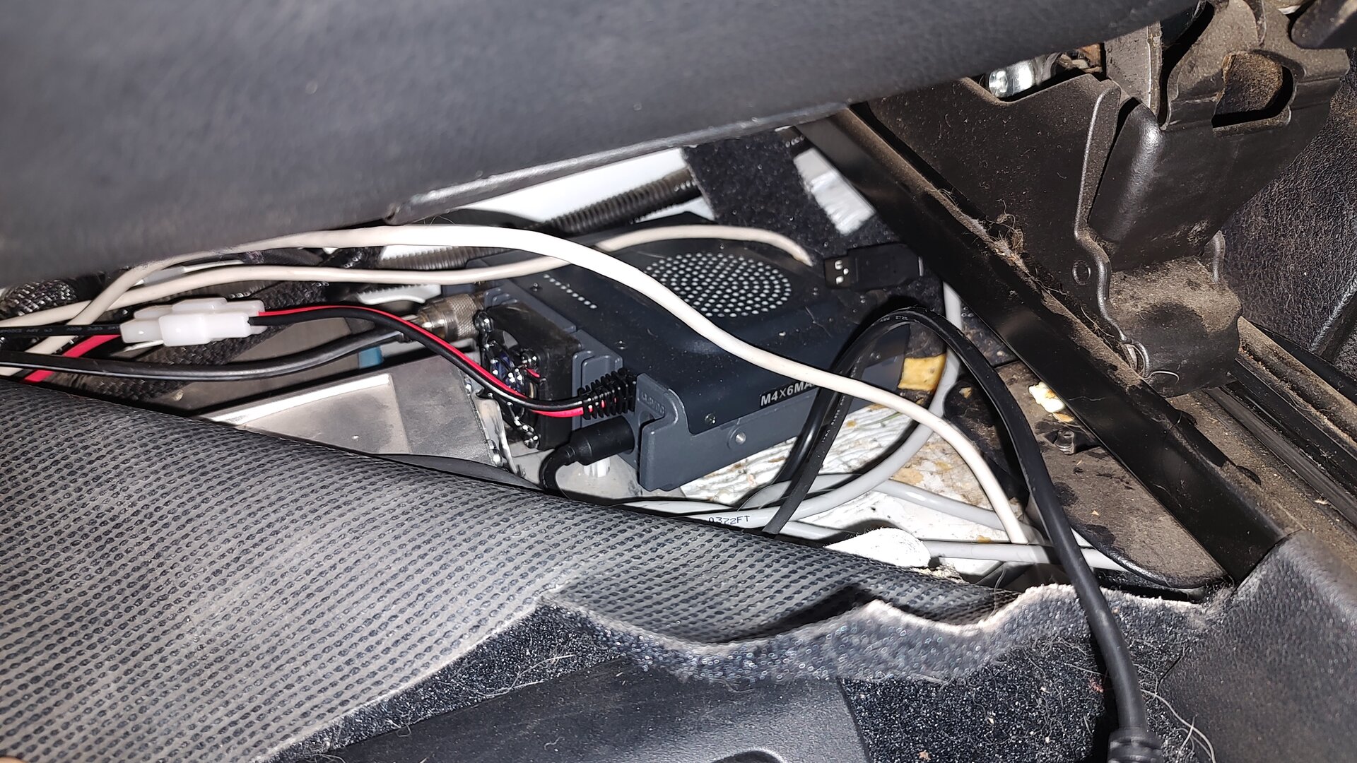

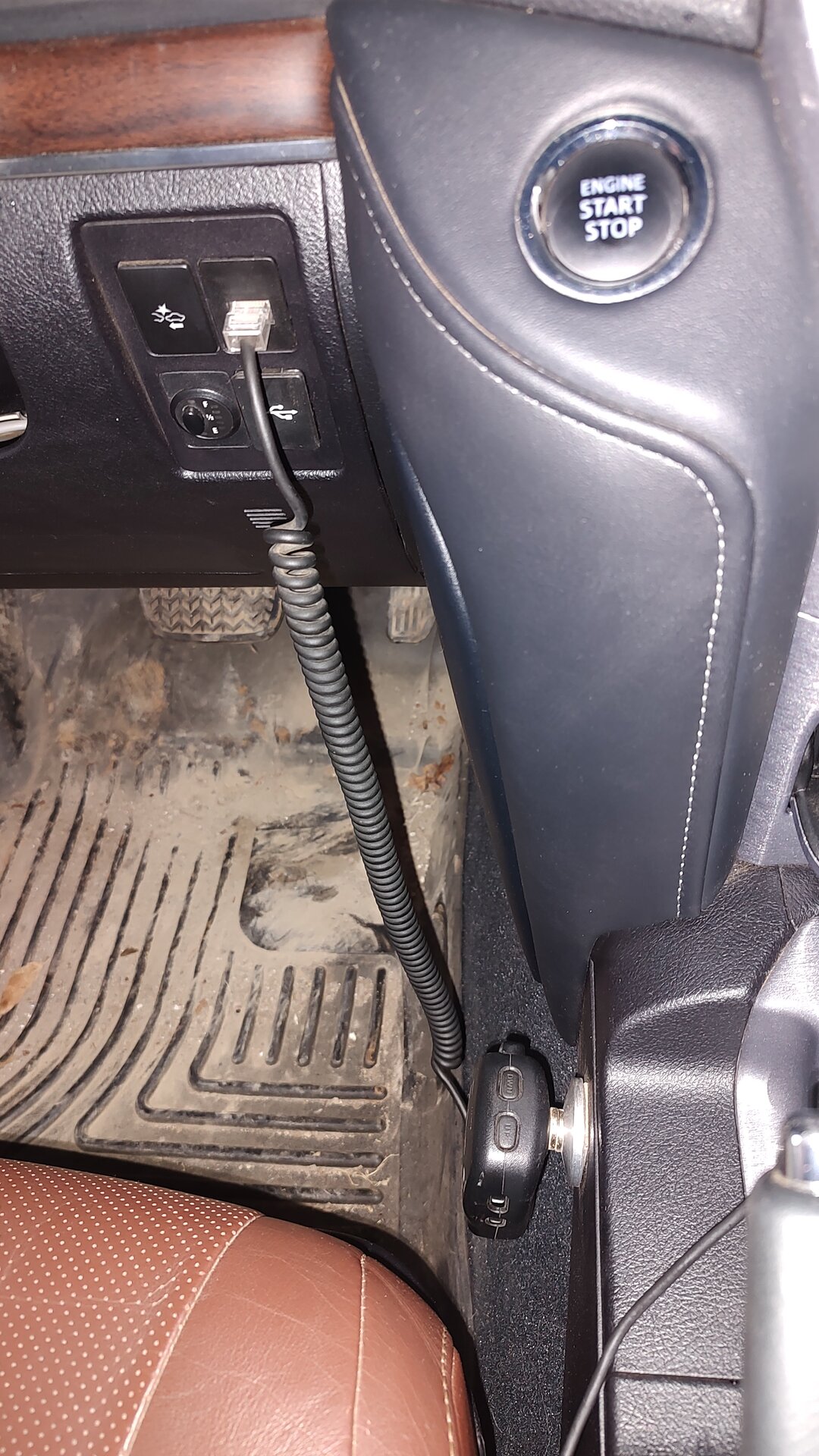

I have the body of my 400 under the drivers seat, there is a pocket under the carpet that fits it nicely. Screen/control is on the windscreen. cables run under the drivers side sill plate
That is good to know. I'm going to have to take a closer look under there. Any chance you have a picture of your setup?
On my manual one it is just a questionnof force… and you need to remove everything around bevor doing it.
Hey thank you! Do you just fold the carpet back over top of the radio then?
Yep, there is a hole in the carpet from the factory, I think I remember making it bigger or cutting to the edge to open it up. But once the seat is back you can't see it
