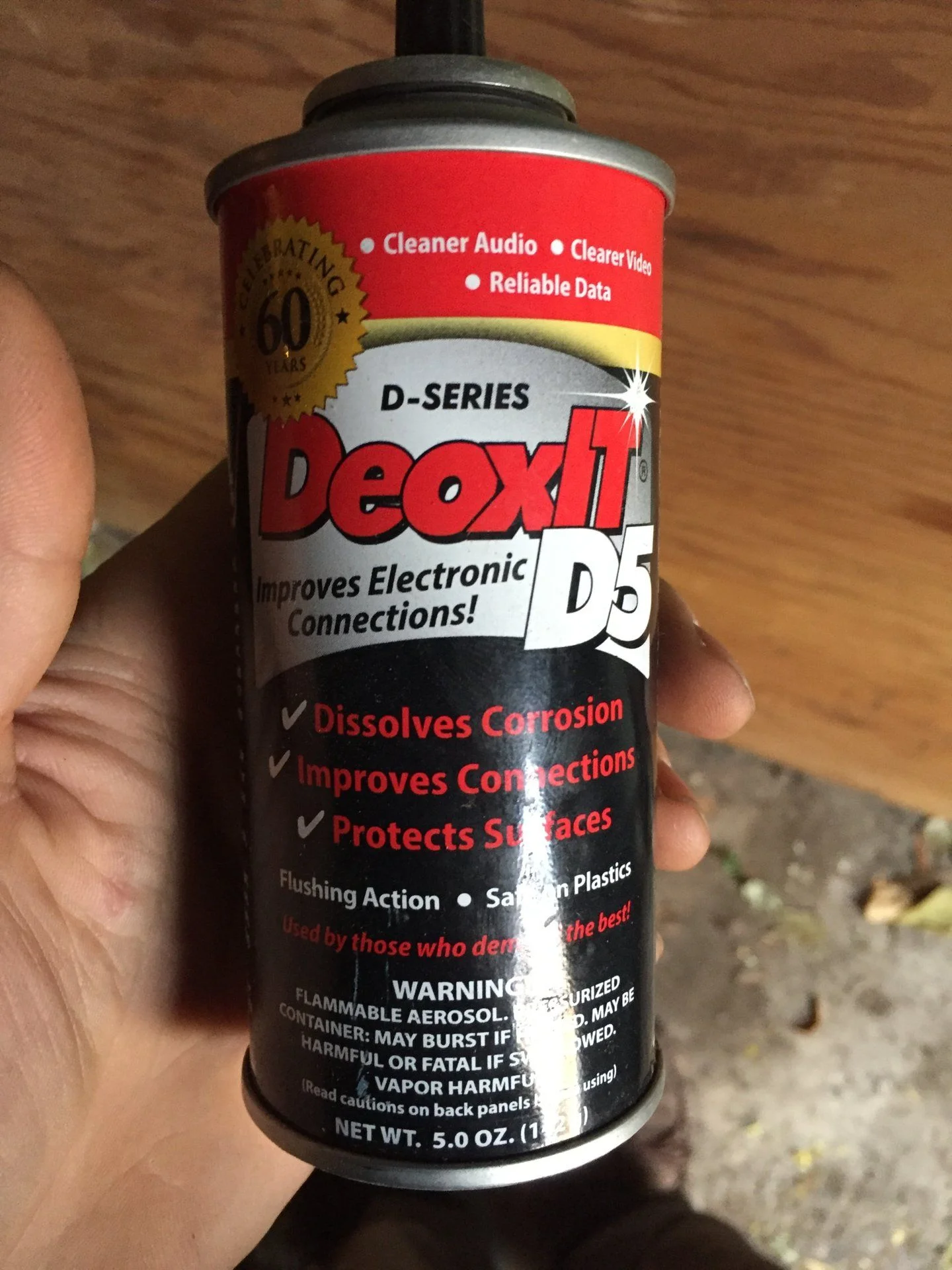

Use deox it, it is spray cleaner we use for connections on airplanes

I use DeoxIT, and a soft brass bristle brush for really grungy stuff. Plus some cheap CRC electrical cleaner for blasting out loosened crud. Finish with silicone dielectric grease to prevent future corrosion.
