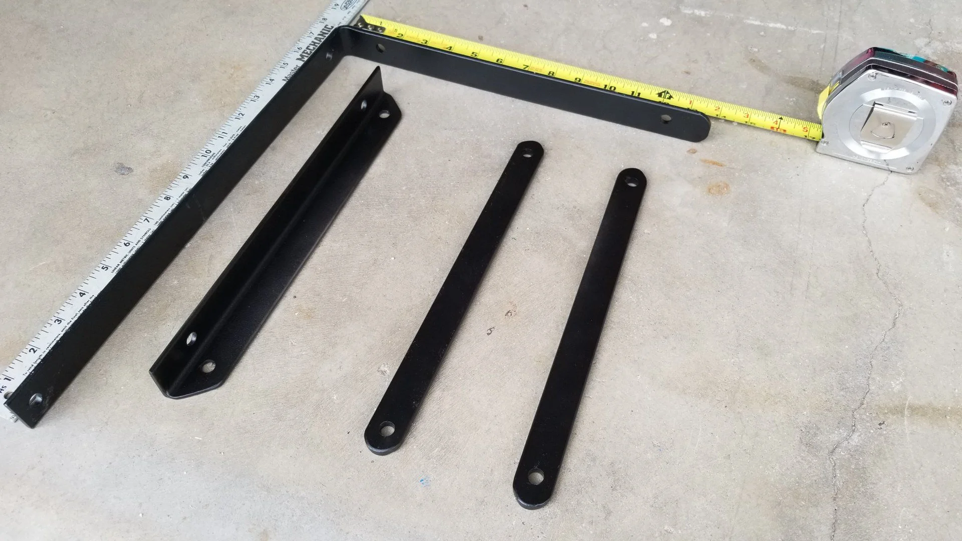

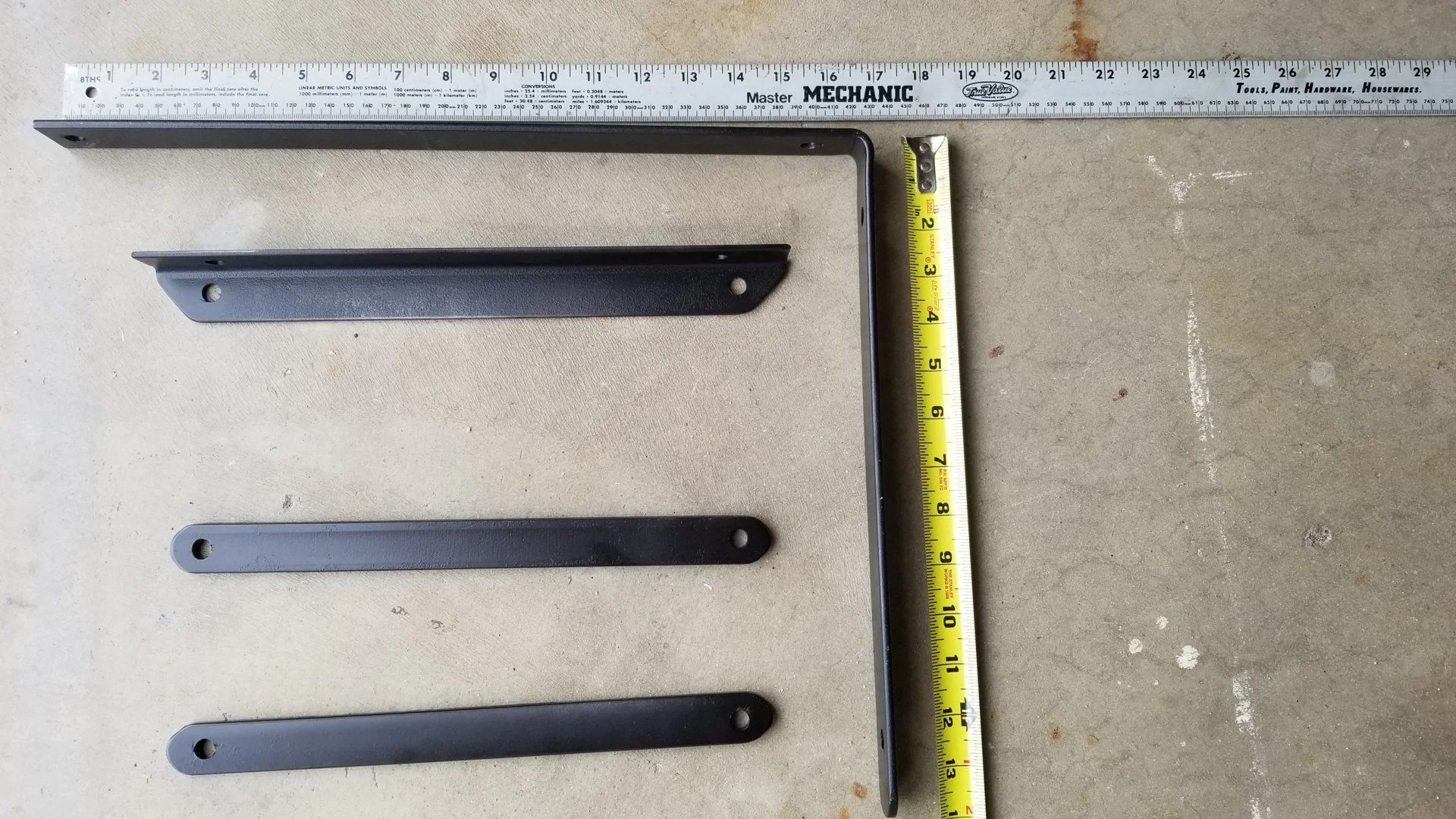

The first photo's below are just flat steel rod that I cut, bent and drilled some holes for 5/16" nuts and bolts.

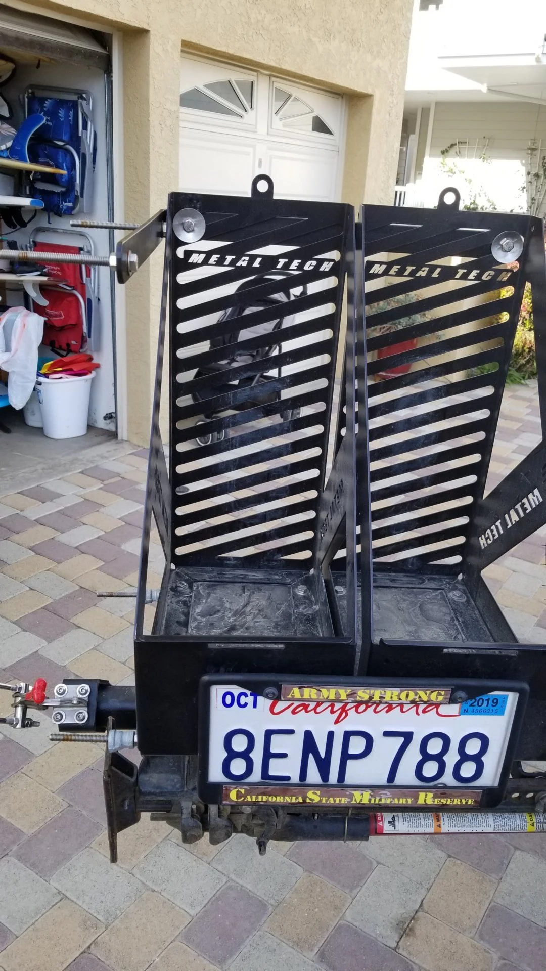

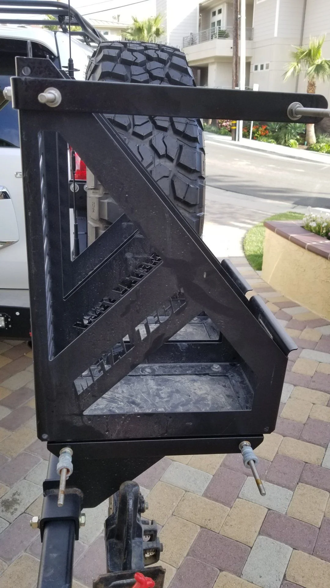

The next photos below are of it bolted to the dual jerry can mounts on the bumper.
1943341
1943342
1943344
1943345

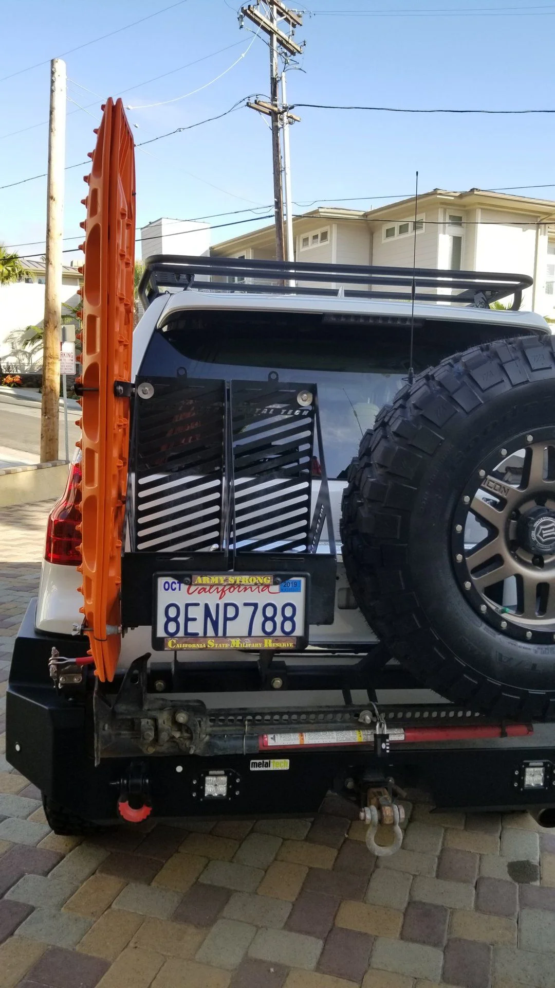

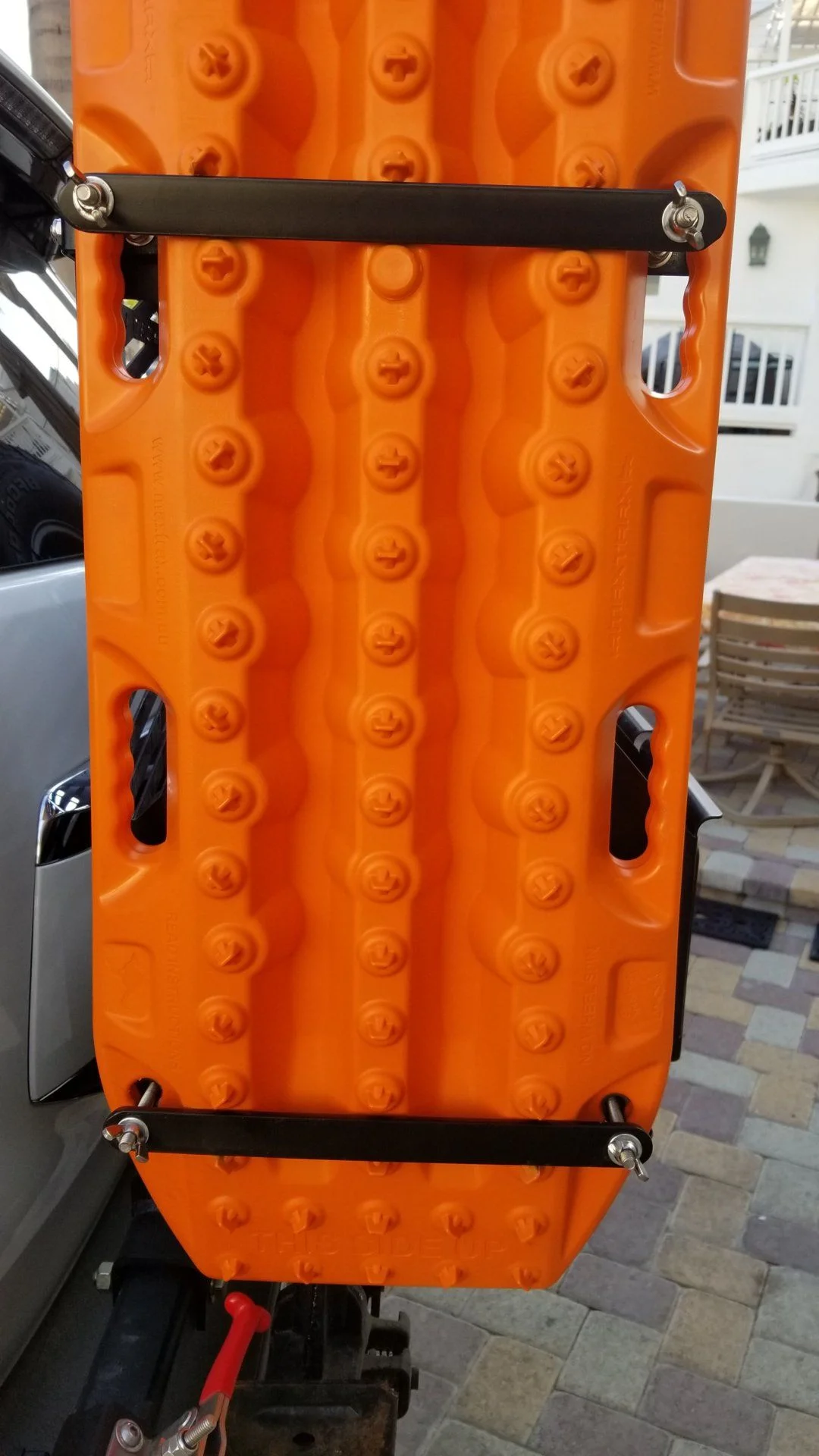

These last photo's are of the MaxTrax mounted.
1943346
1943347
1943348
As noted above, all fasteners are stainless steel and I used nylon insert/aircraft lock nuts for all the mounting bolts.
The rulers are just for reference if someone wants to tackle this themselves. If anyone is interested I can give more accurate dimensions of my cuts and the size of the fasteners, but I did this all in an afternoon just figuring it out along the way. It's not rocket science, but bending that top mount 90° took a big arse hammer and some good pounding to cold forge that to a 90 degree angle.

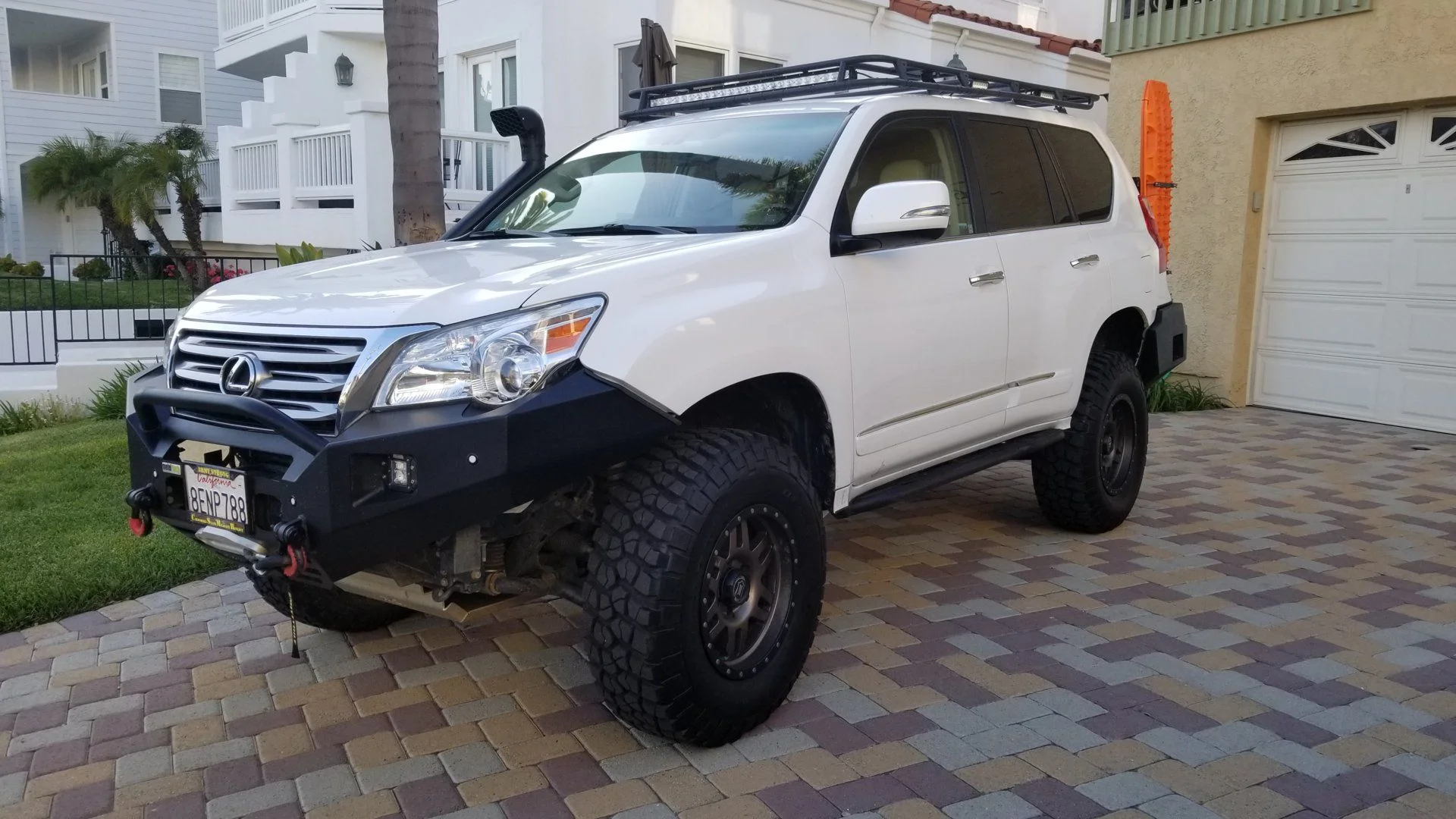

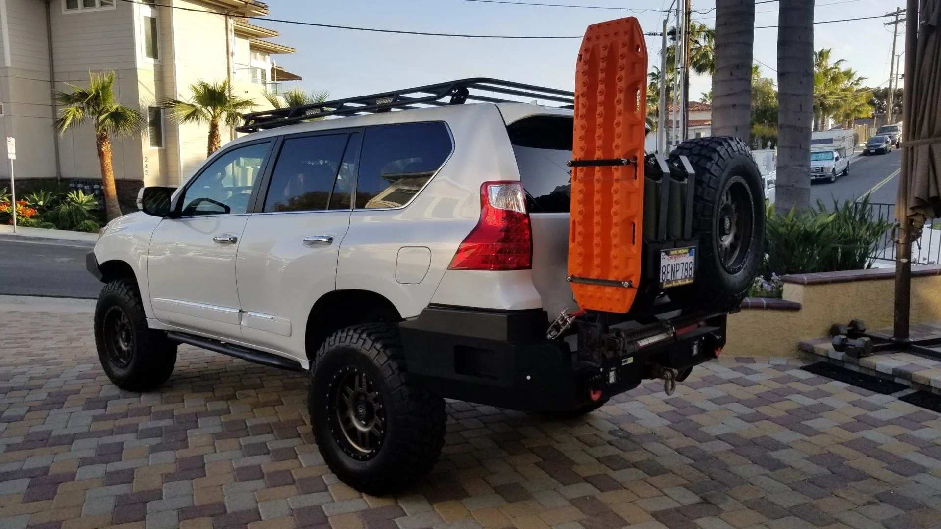

Just some more pic's of how it looks with the entire vehicle in the photo.
Note: You will never lose you rig in a parking lot again with this mount and that color Maxtrax!!
