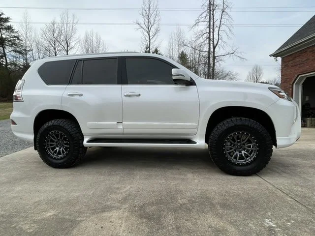

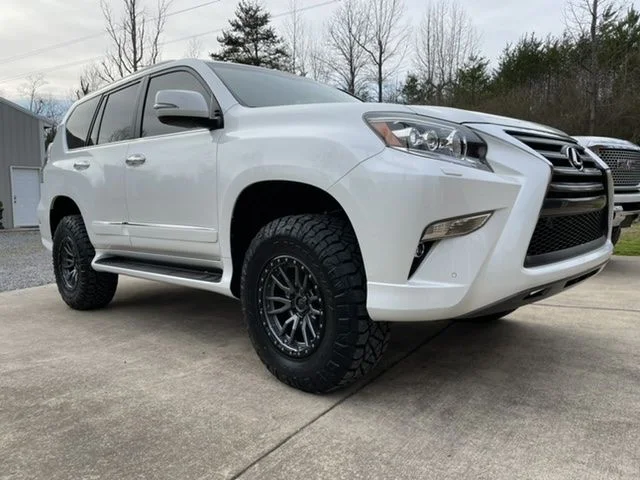

Thank you sir for the pic. I got lucky and only had to heat and bend the plastic but I think the SPC control arms helped a lot with that. I left the caster at 4.6 and it’s not even close in the rear. It drives just like it did before and I am well pleased with the lift, wheels and tires.
Looks good! Make sure you try it stuffed with the wheel turned out. It's almost guaranteed to rub with travel, flat street driving is pretty easy to clearance.
Will do man. I figured it might when it’s in some hairy stuff. Now onto sliders if I can get the nerve to cut the factory steps. Lol
