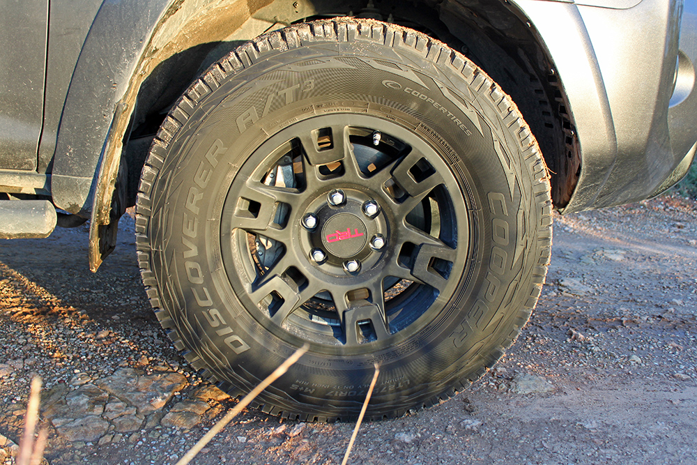

Very simple question in the title.
Will these wheels (they are 7" wide and have +4mm offset) and let's say 285/70r17 Wildpeaks 4 clear body mounts or not?
I know it will not clear plastic - but I already replaced steps with slides and on my way to cut front bumper as well, so plastic is not an issue.
Also I have 1" of lift.
Offset of these wheels will definitely clear UCA.
So the only question remains - will it clear BM or not? Please consider offroad situtaion (full lock, compression, etc, not just straight driving).
I do _not_ want to cut any piece of metal designed by Toyota engineers (especially such safety-critical ones as body mounts).
Thank you in advance for replies.

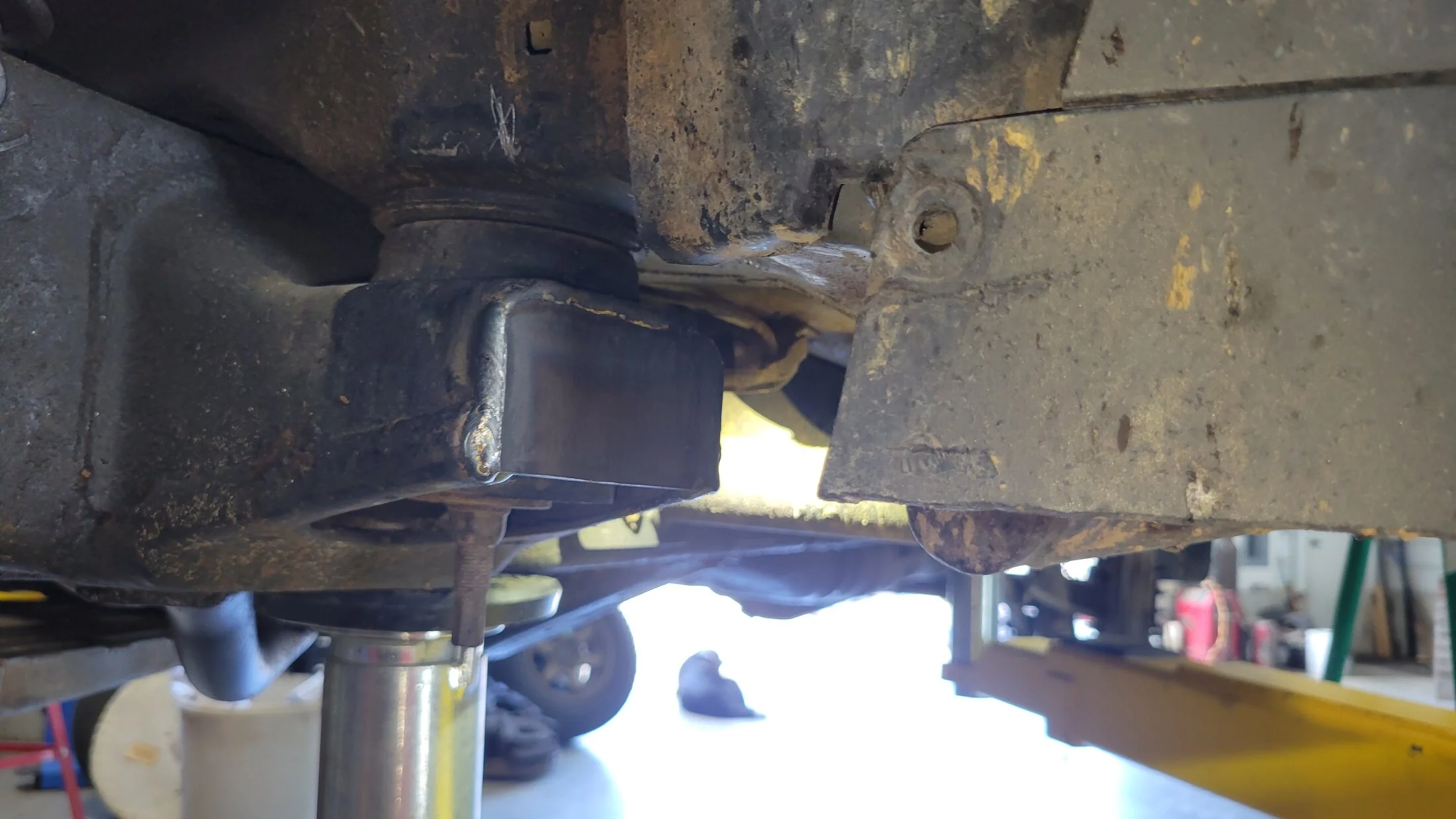

They will probably rub, especially with only 1" lift. Some folks on here don't have rubbing, but most do. I definitely had minor rubbings with 285/70R17 Wildpeaks and did a BMC.
BUT, a BMC is no big deal. You just lop off the protruding steel beyond the actual rubber mount and weld on a thicker plate across the cut. The body is still well-supported and the vast majority of Toyotas running on 33s or larger have had a BMC. If you don't want to do a BMC, then just stick with no larger than a 275/70R17 tire.

Seriously, yes they will rub. Maybe a little around town, but if you're serious about trails and off roading, just do the BMC. It's pretty quick and not very expensive.
