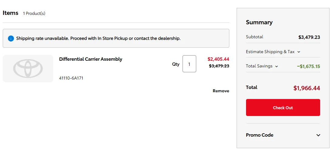

That's too bad. I know this isn't great news right now but if you need to order a new front diff now is the time. I plugged it in to Serra Toyota and you may need to pay a little bit of shipping but it would take some sting out.
I was thinking about going with a revolution gear 4.88 set and an Eaton e locker.
Thanks for that link though, I’m going to order a steering rack for $521 shipped!

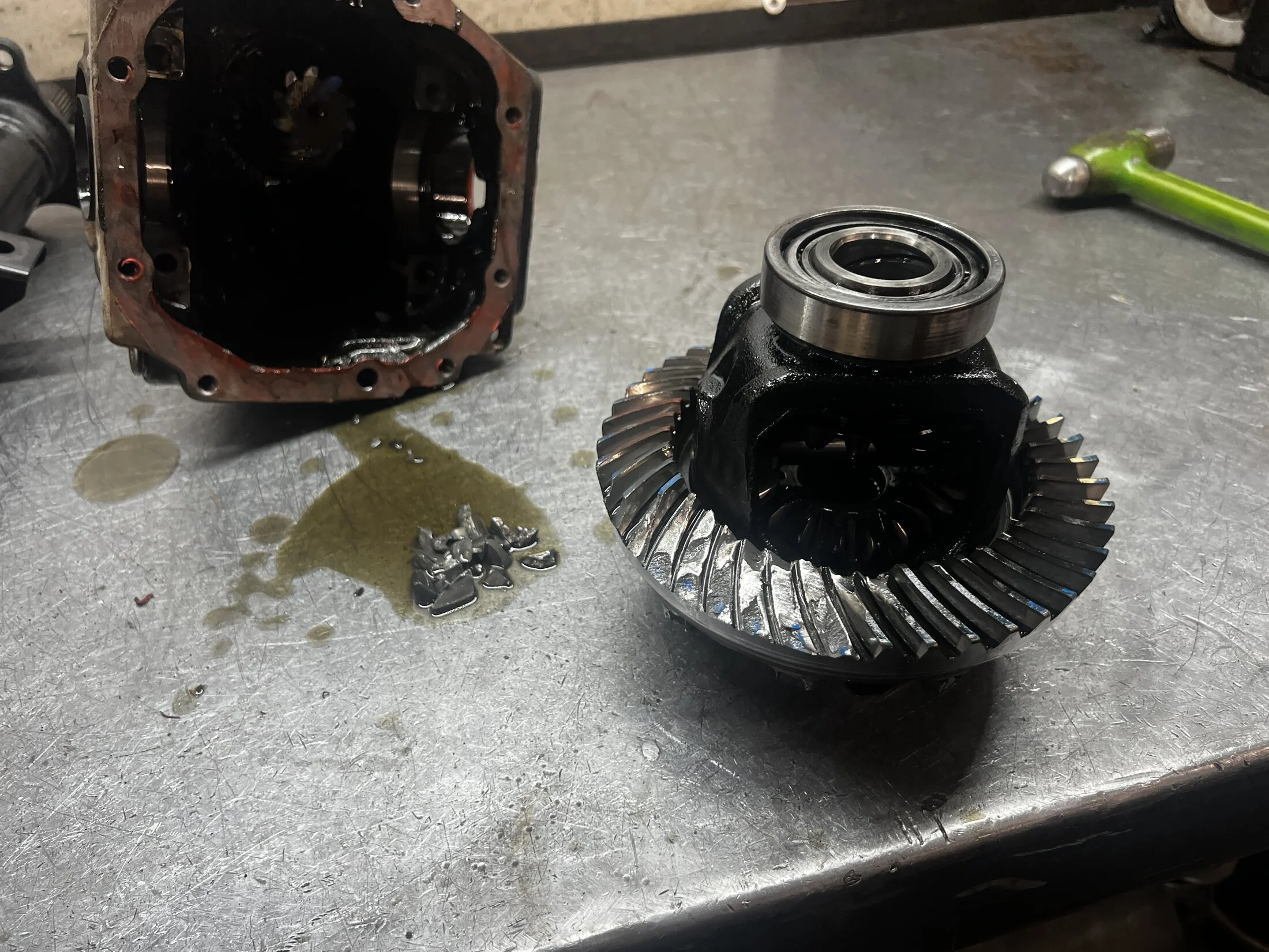

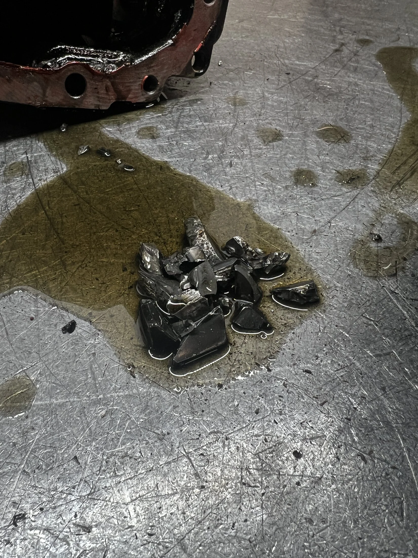

Well, here’s the carnage. RIP to the ring gear.
