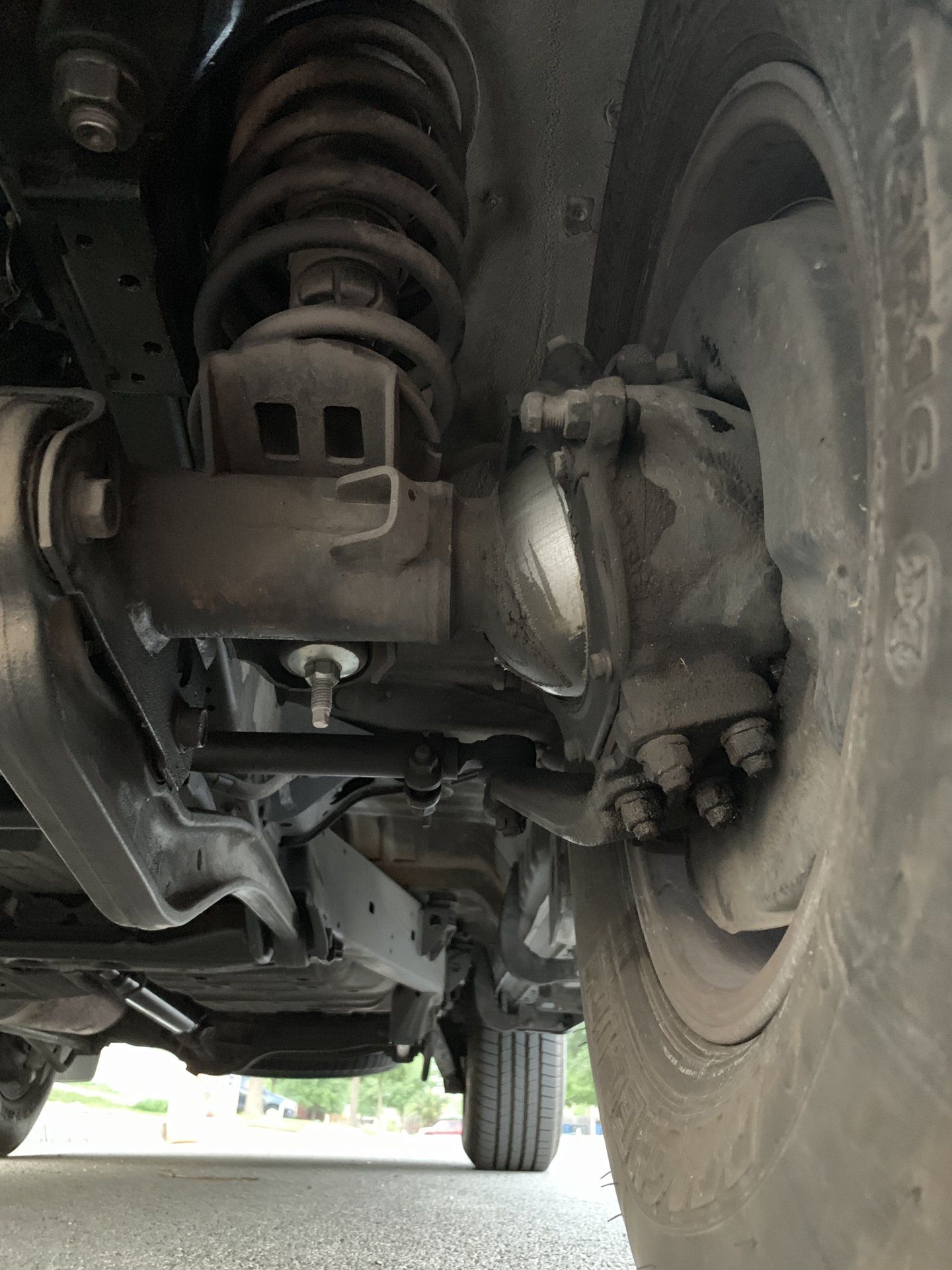

Looking for some advice here, I just picked up this rig. Front axle was serviced a few years ago. 20k miles ago I think. Anyway Do these knuckles look dry? The steering is a bit stiff compared to my buddies rig, I realize PS could be the issue here but I am also curious if dry knuckles could be a factor.
I will be changing diff fluid and peeking into the birfs later this week I hope.
