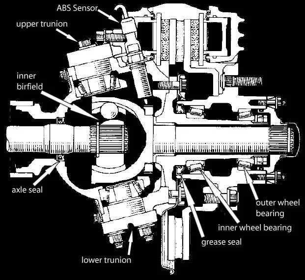

That's a great video, but one problem IMO is he way underfills the knuckles with grease. 12 oz. per side is nothing. Plus when you fill thru the fill plug on the outside of the knuckle, that grease mainly runs down onto the outer birf. You want grease on all surfaces. - Inside the inner knuckle, on the exterior of the inner knuckle (smooth visible part connected to the axle body), inside the outer knuckle, inside the birf, outside the birf and inside the spindle. I followed this video and used the CV joint grease he used and had rust show up at the top trunion bearing area. The grease never made it up there. I did another rebuild last week with 5 14oz. tubes of Valvoline Palladium (2.5 tubes for each knuckle). Packed it with grease as I put everything together. Much better.
I do the zip tie test thru square fill hole on top of knuckle body(2/3-3/4) then pump till my arm hurts (I know, I know) with Grease Gun Loaded with Valvoline Palladium. It's a 10 min and $10 Job.
*Chk the bottom 2 bolts that are pointing to the ground to ensure tightness (turn clockwise). These are the Trunion Bolts.

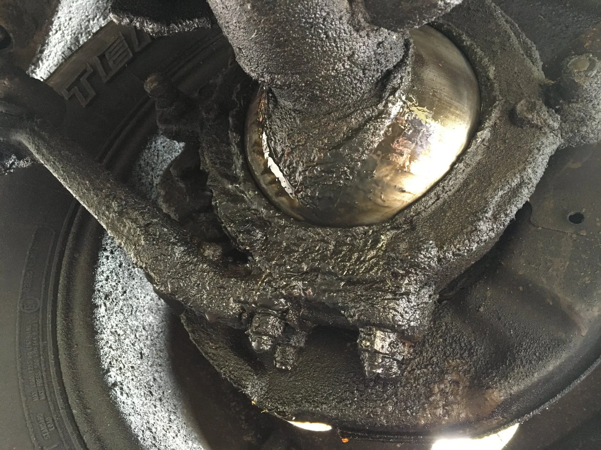

Ah, yeah. That's what my driver's side looked like last fall. I limped through the winter, my driveway stinking like gear oil. It's a really cool job provided you have the tools/time/prep. I'm sickly looking forward to doing the other side this summer.

If you clean up the outside of the birf where it's thickly caked on and overflowing, that will give you an idea of how quickly it's leaking. It may turn out the thing was never cleaned up and the leakage isn't as bad as it looks.
@greentruck - I've already bought everything and if it's leaking at all I should get it fixed, besides. I'd rather repair the issue than just adding diff oil and grease to the knuckle.
