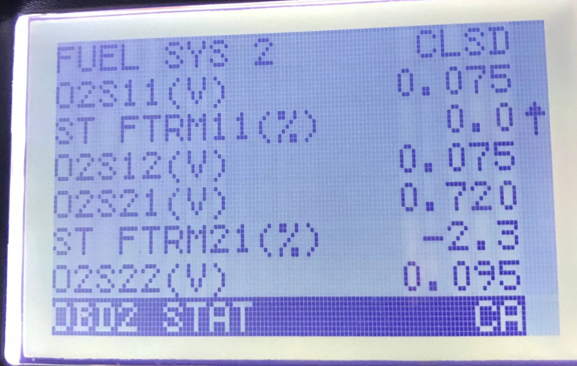

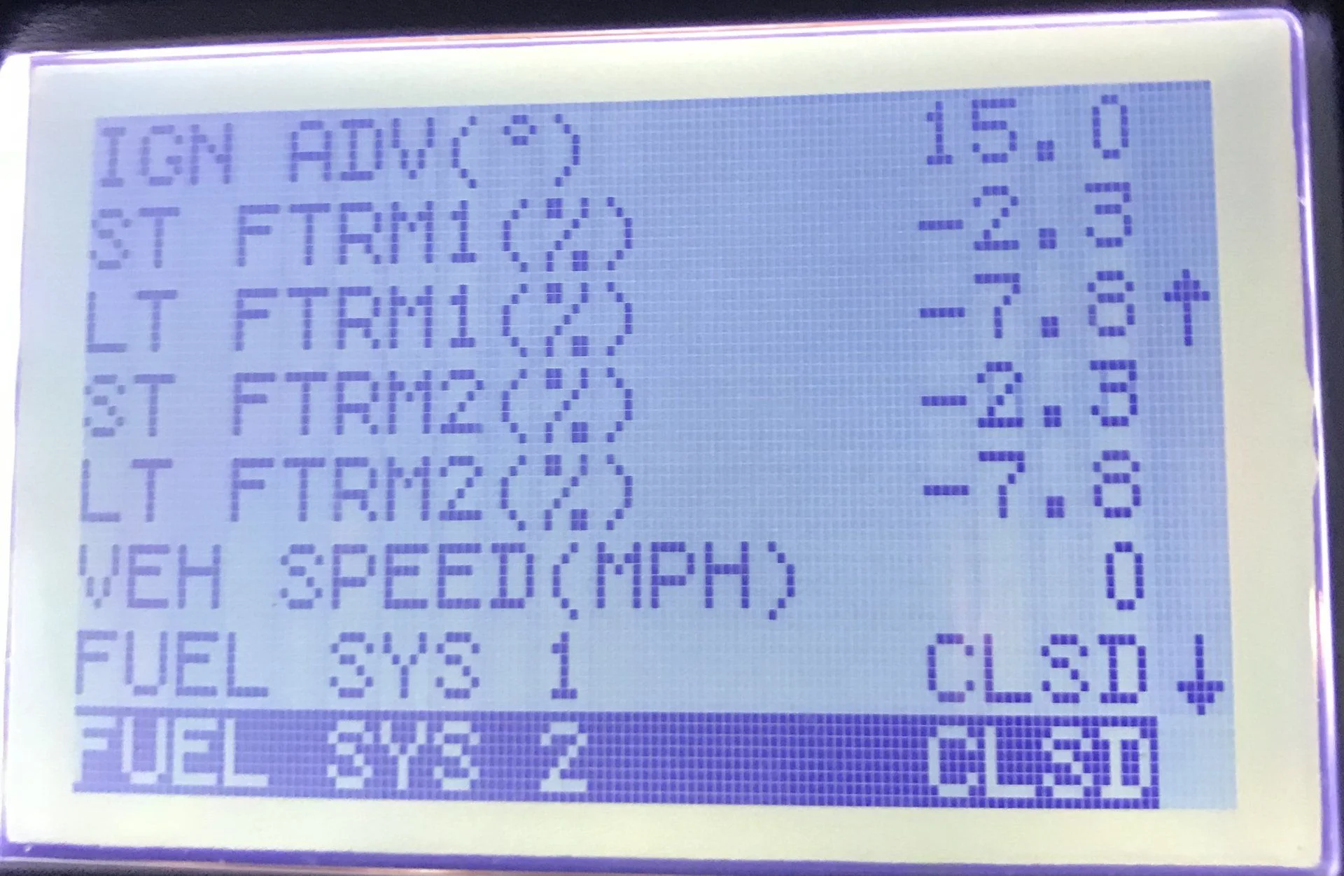

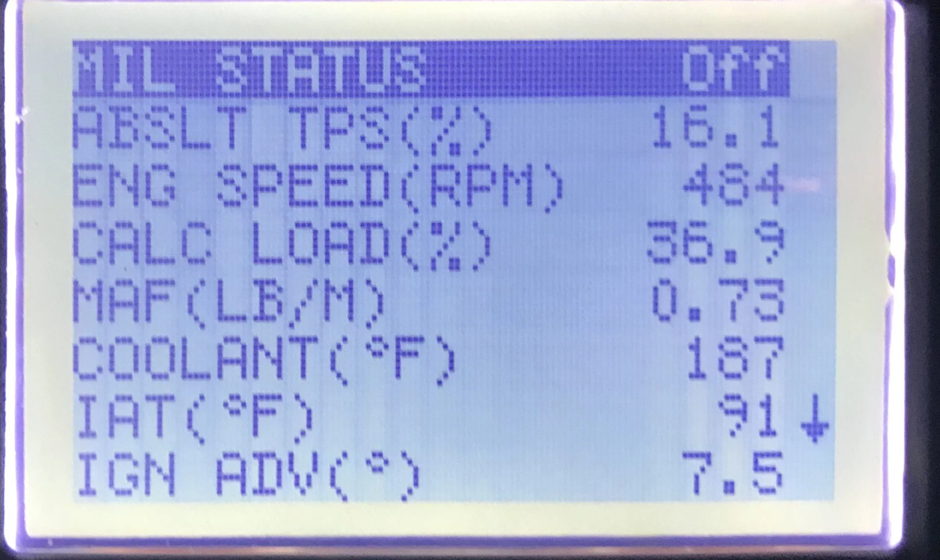

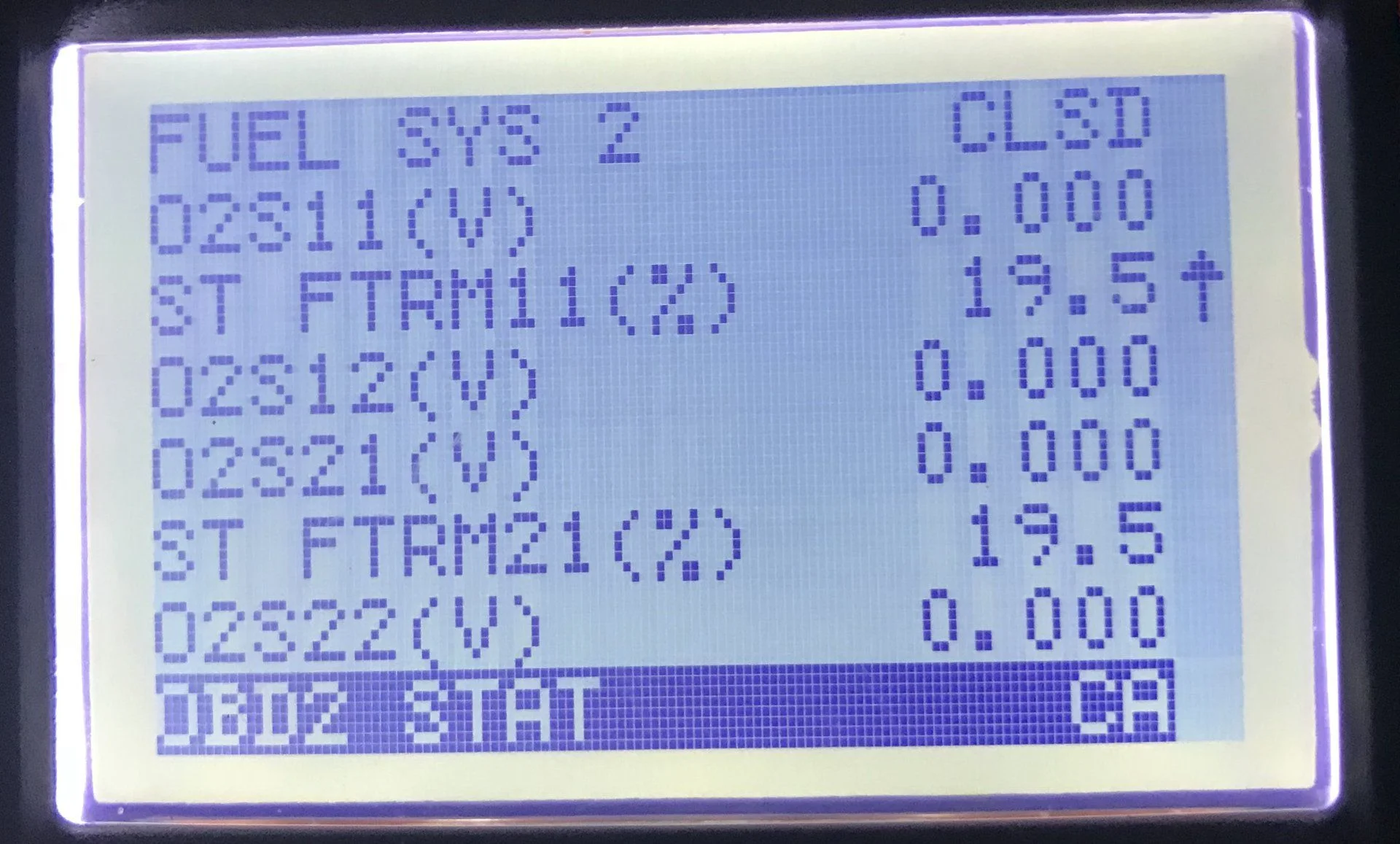

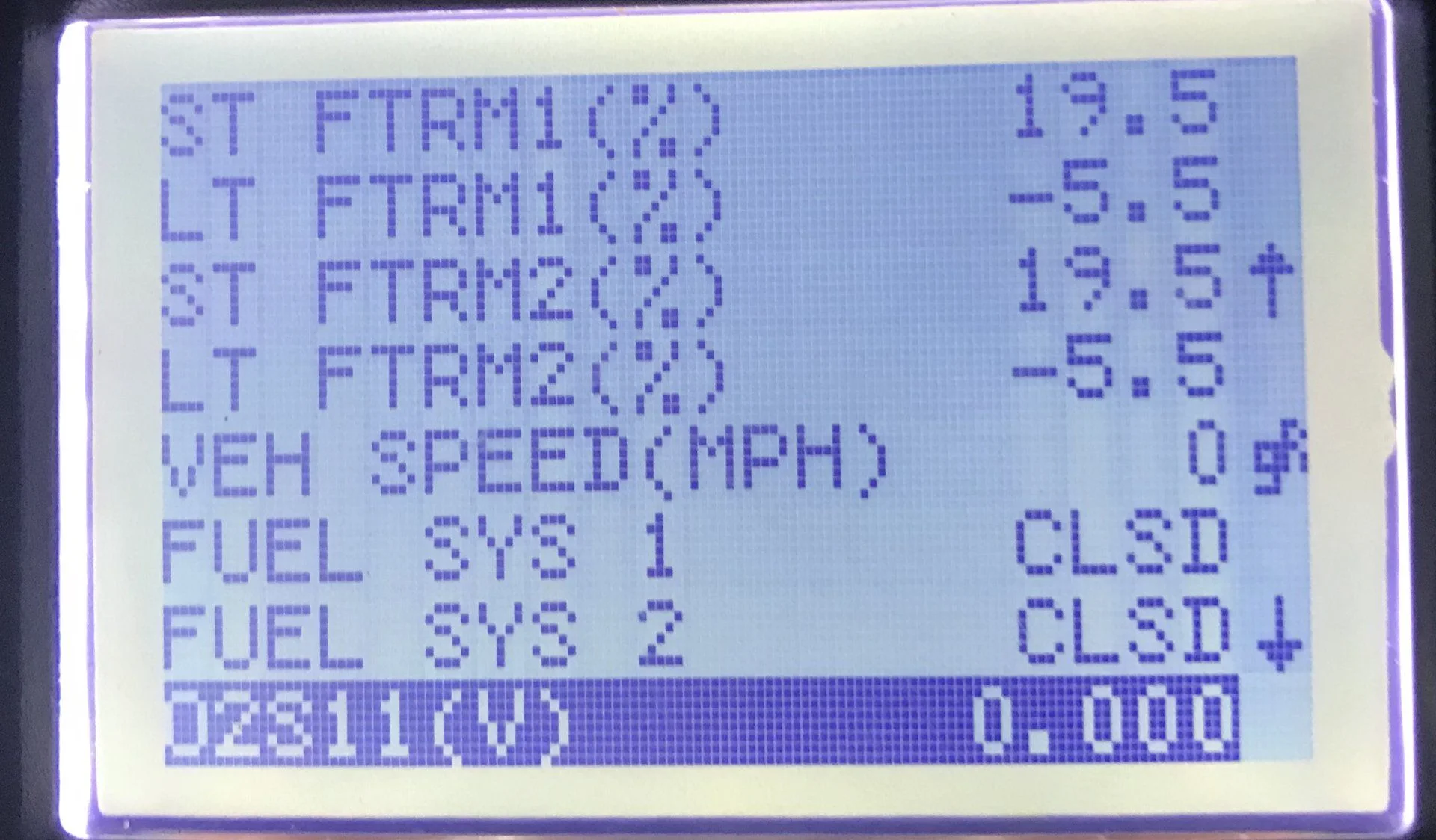

"Luckily" the other night it when I was close to a handheld OB2 scanner. These first 3 pictures are of when it was missing very badly.
The other 3 pictures are when it is running perfect! The biggest difference I can tell from the pictures is that the LX 470 might be losing all of its O2 sensors at one time?
Please advise before I shoot this SUV and leave it for dead!
Btw since I was planning on keeping this LX 470 forever, in my past 6 months of ownership I have had my Toyota dealership do the following to get a baseline: new fuel cap, new air filter, new fuel filter, new timing belt, the MAF has been clean, clean throttle body, the Injectors have been clean, new spark plugs, new water pump, new belts, new alternator, radiator flushed, transmission flushed, differentials flushed and oil changed.

I would treat the 02 sensor issue as a red herring, I would doubt your scanner first. I am not saying a 02 sensor isn't at fault, but for all to read 0v without a CEL then I would take it with a pinch of salt. Check your wiring harness for signs of damage though, and check your battery connections.
Another thing that is strange, is that all of your fuel trims are out, and they are all out by the same amount, so I would look at fuel pressure/fuel filter, MAF sensor, fuel condition, air filter and coolant temp/sensor as these would affect both banks the same and all cylinders.
Do you know anyone with Techstream to confirm the readings, I am just doubting these readings myself.

It might be for the best as If I was getting these readings on techstream then I would be worried about the ECM being at fault, as under fault, your coolant temp is good, your MAF reading is ok. Can't speak for fuel pressure so this could be a issue, but if you haven't got the kit to test then what can you do, but you still wouldn't expect 0v on the 02's.
