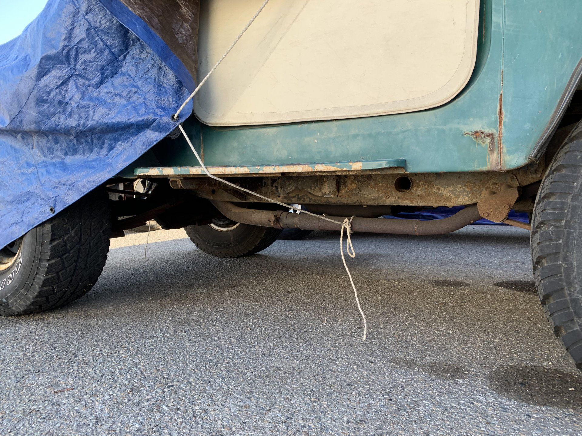

How dumb is this idea? Restoring the frame, not the body...

im actually sort of doing this now.- but leaving the body on. I fixed some rust on the body also and will repaint. You'll find more rust than you can see and mine was in better shape on the underside than what i see in the pics. The underside of the body will probably have a few places that would benefit a good cleaning, blast or wire wheel- you do have surface rust in many places but that wont likely come off with a powerwash. There are seams along the frame that are hard to reach. Im pulling the trans out, removing the fenders, exhaust and will get to as much of it as i can get to from underneath the truck. I dont have the tools or space to remove the body but if i did I would do so and farm out blasting of the frame. Industrial blast equipment will go much faster and you can focus your attention on getting it back on the road quickly. It is a little bit of a rabbit hole but I kind of give my self a set amount of time and then call it good.

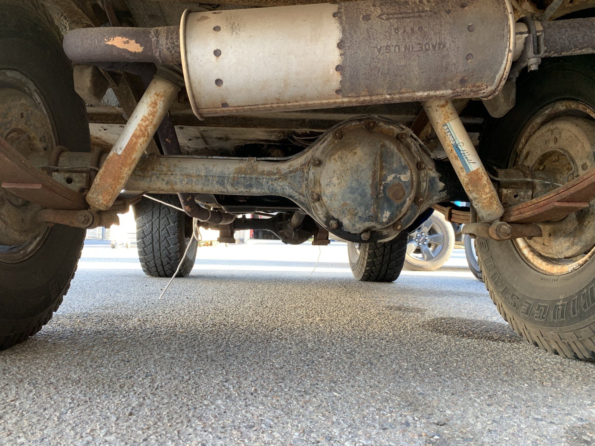

Was (still debating with myself) on similar dilemma - ‘75 with a lot of nice patina and frame that had surface rust - no rot. Spent most of it’s previous years in Cali and AZ but originally from OR. Purchased last May and very much daily driver condition so spent many hours underneath last summer cleaning, scraping, wire brushing, 3M disc, and air needle scaler. Basically a frame-on with what was accessible. Brushed on Eastwood Platinum encapsulator followed by Chassis Saver on frame and undercarriage that was reachable. Was tempted to try Eastwood Internal Frame Coat for inside of frame but instead cleaned inner frame best I could and then gave it a thorough FluidFilm coating thruout for the winter storage. Will reassess this spring. Would love to do full body off but the killer rabbit is for real - go down that rabbit hole and maybe years getting out

If you can tell by the picture... I have a bit of rust that gets worse as you go farther back. I just want to shore up some holes and clean some rust. Fix the body with some panel where the spare tire rack is. But I don't want to create a show pony. It has marks down the side from riding on trails and I kinda like them. I want it to be used and something the family can enjoy not going to just go full ferris bueller with it. "He doesn't even drive it. He just wipes it with a diaper" HAHA
I think you're getting close to the limit so I say pull the body. It's not hard. I did it by disconnecting the bare minimum of components and ratchetstrapping the front of the body just aft of the mirrors (running boards removed) to the rafters in a garage. I put a jack under the bed and lifted high enough to slide a 4x6 across the rear wheel wells and supported it with jack stands just outboard of the wheels. Then it was a simple matter of rolling the chassis forward out from under the body. You might have to pull the wheels. After that you'll have easy access to the frame to blast, wash, sand, scrub, whatever.

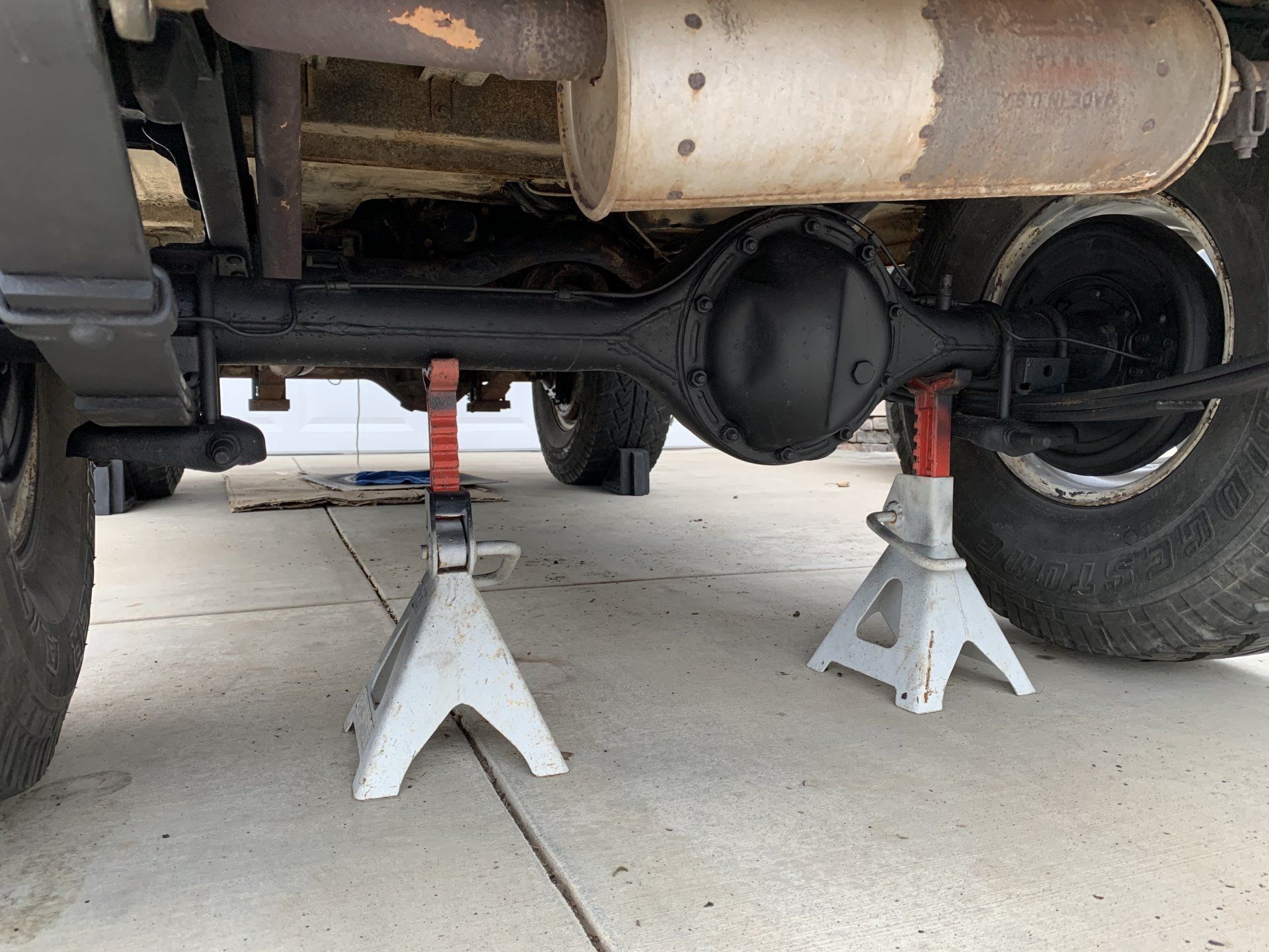

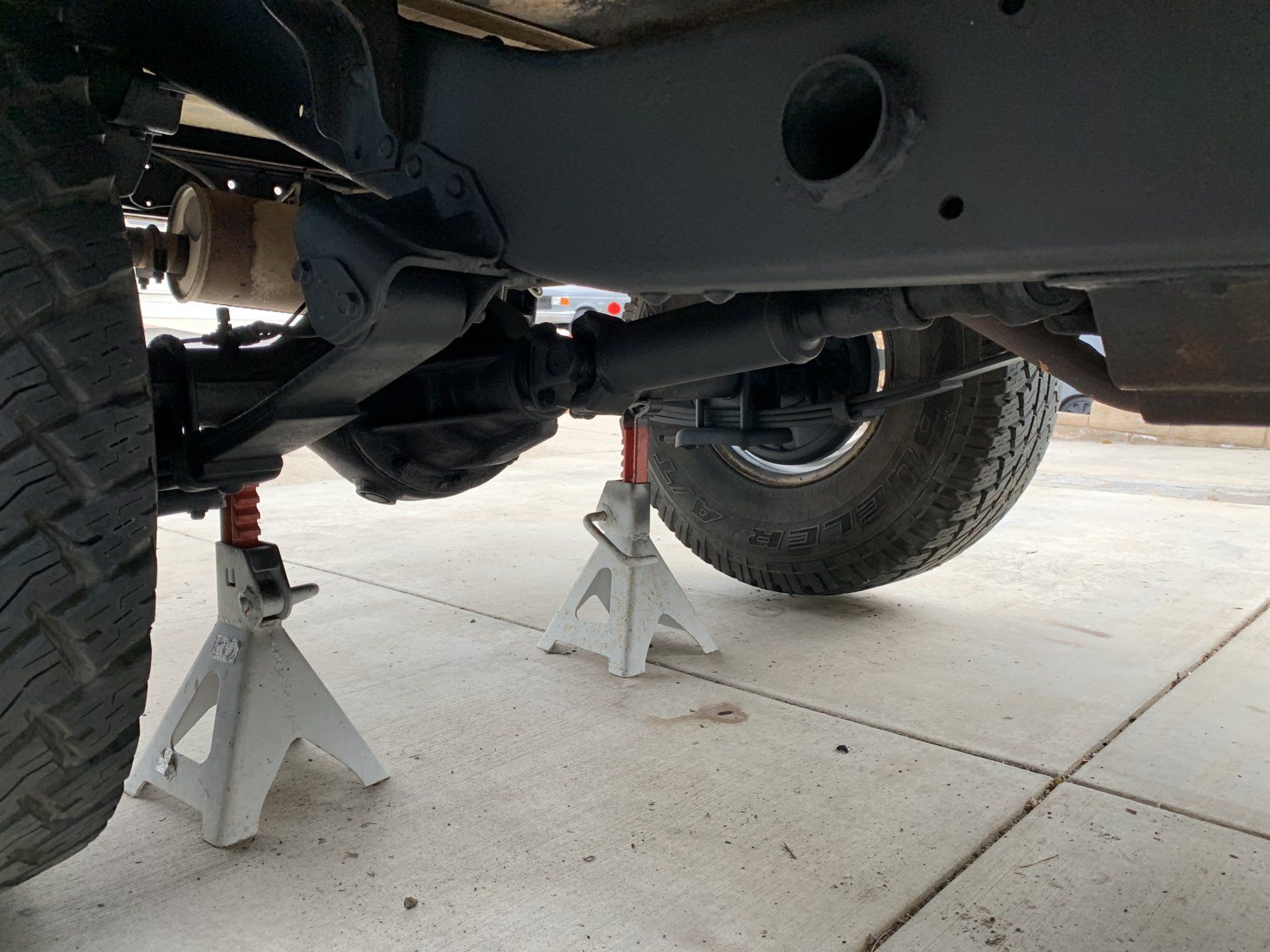

I am in the process of painting the frame now. Wire brush, cleaning with a degreaser and using rustoleum rust convert. Not perfect like a frame off but looks pretty good. Here are some pics.

No not on this one. I just cleaned it and painted as much as I can get access to. Used a piece of cardboard to prevent overspray. I removed the shocks and will put new ones after.
Looks really good! Anyone try Rust Release? I’m thinking of giving it a try...has a gel option that assume is like naval jelly. I found the back crossmember and rear sill to be the biggest challenge getting surface rust de-scaled, cleaned / degrease and coated.
