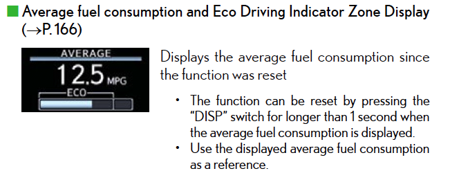

I believe the AVG. display is a running calc from the last time it was reset. Try holding the button down when it displays 16MPG and it should zero out and restart the displayed AVG calc?
Thanks for the tip! I will give that a try...just found it on the manual as well.
