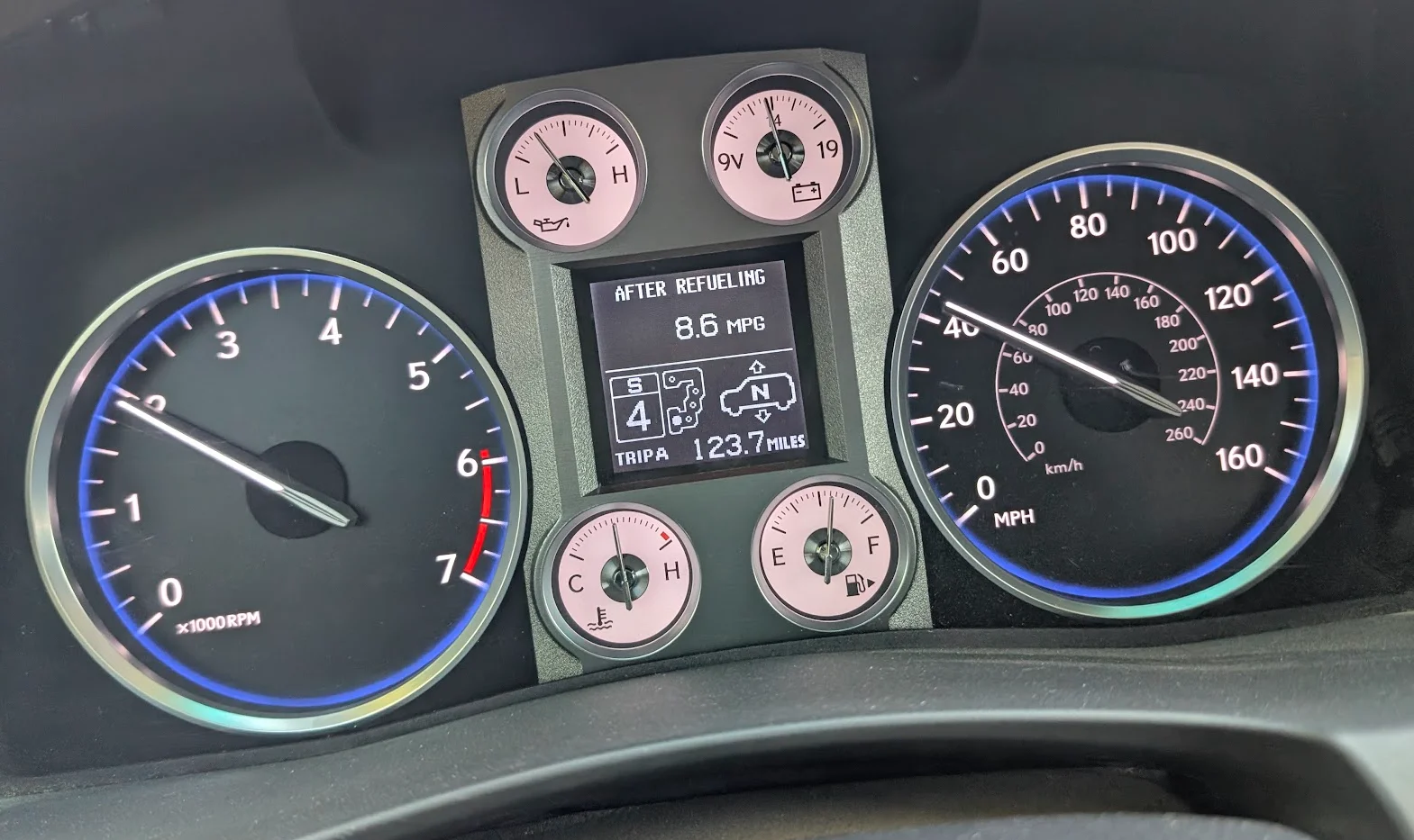

Here's what my MPG looks like straight off the gauge. My commute and trips are similar as I commute in town only. I have a heavy foot. Although I'm on 37" R/Ts so you should be doing a bit better than this. With 35 A/Ts, I was getting about 9-10.5 MPG readouts. With 33s A/Ts that were really close to your size in diameter, about 10-11.5MPG, which is what I'd expect for your setup.
Yes, definitely change the PCV if you don't know when it was last serviced. You should also be correcting for tire diameter as mentioned. Short answer is take what your readout says and multiply by 1.05.
My 8.6 corrected (1.10 for 37s) is 9.5 MPG. It's pretty close to hand calculated MPH.
