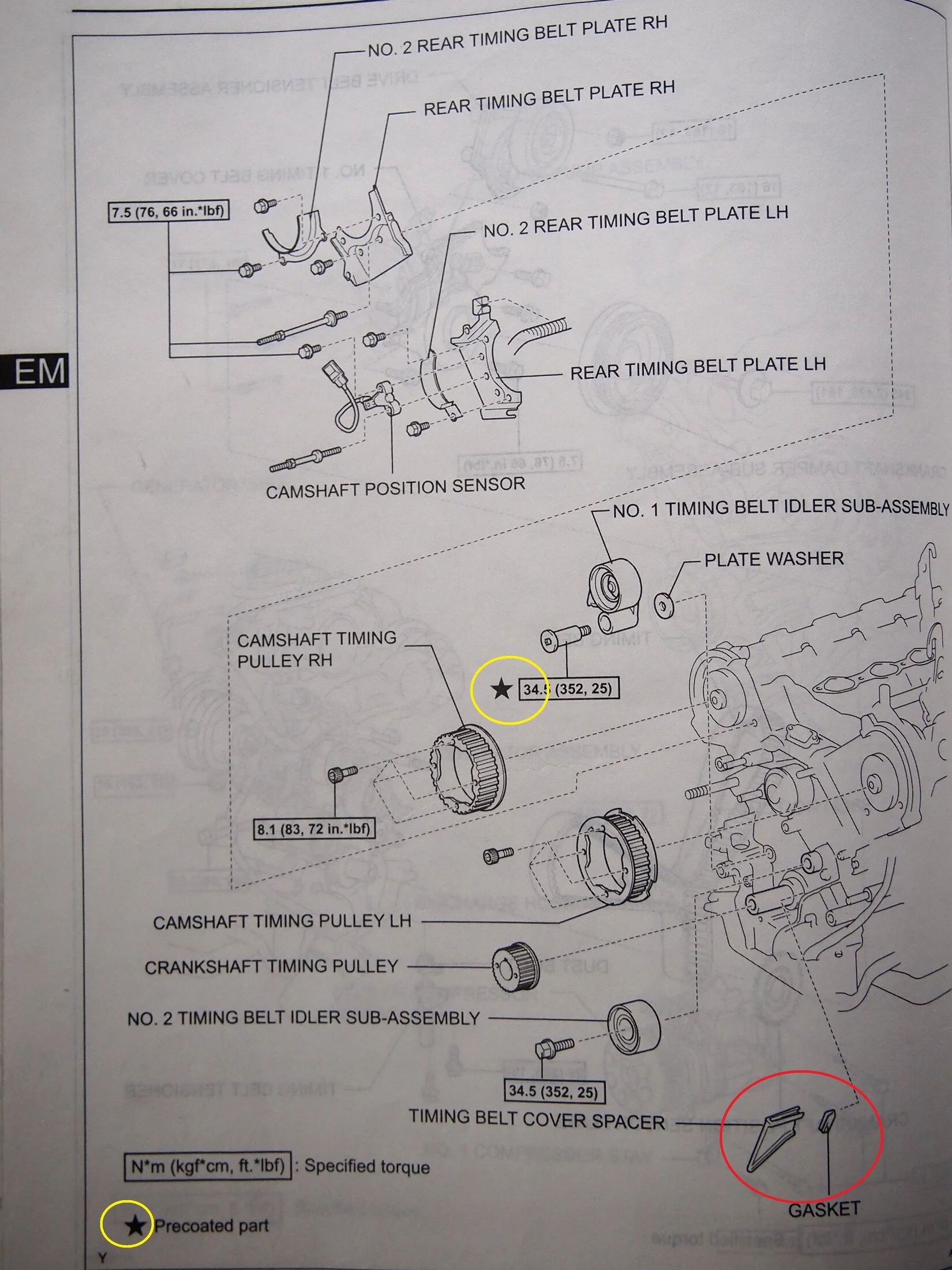

Here's what the Factory Service Manual recommends on No. 1 pulley bolt threads.
"Precoated parts" means sealants on threads. (note: Newer years FSM, also recommend sealant on N0. 2 pulley (idler) bolt threads.

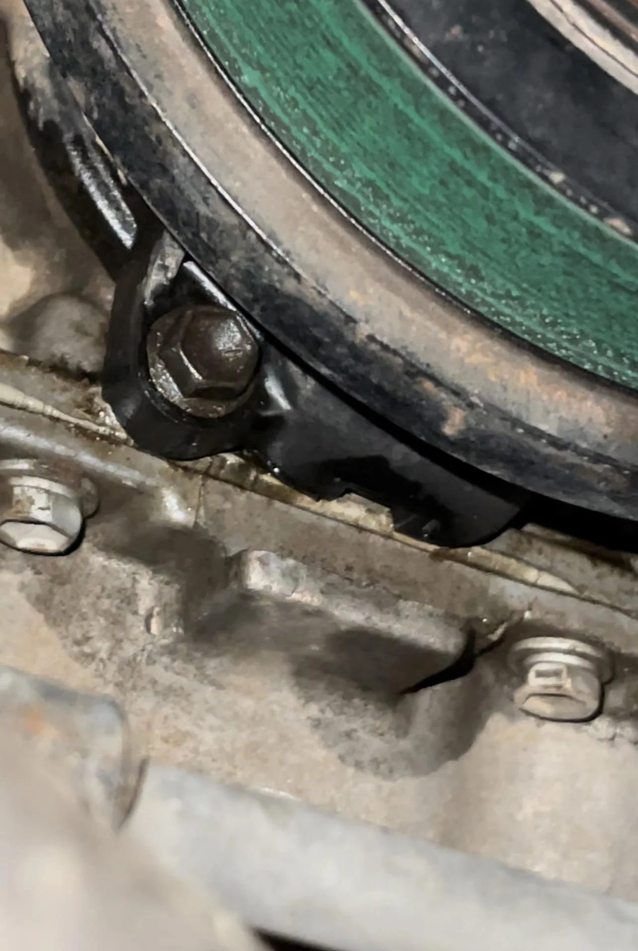

After removing the lower timing cover, I can basically confirm the leak is from the top of the oil pump
