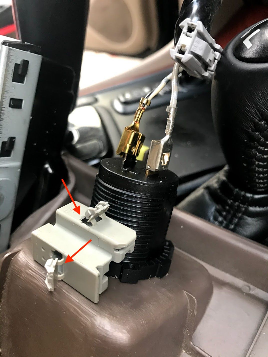

I just did this on my 2001 LX470. Here are some pictures for what I did. Hopefully this helps someone else.
Notes:
1. The reference to pulling hard is due to a couple lips on the bottom left and right of the panel. I used a plastic lever to lift each corner while pulling out; came out pretty easy this way.
2. Instead of cutting off the connector I simply took the connector housing off and reused the female sockets to plug into the back of the usb charger gadget. I covered them with liquid electrical tape before putting it all back together.
Red arrows below point to the lips I mentioned.
I replaced the cigarette lighter in the middle with a USB charger gadget.
You'll need to use something pointy like a box knife to get under this little tabs. It doesn't take much effort to pull them up. Once you do, you'll unlock the female sockets inside of the connector and be able to pull them out.

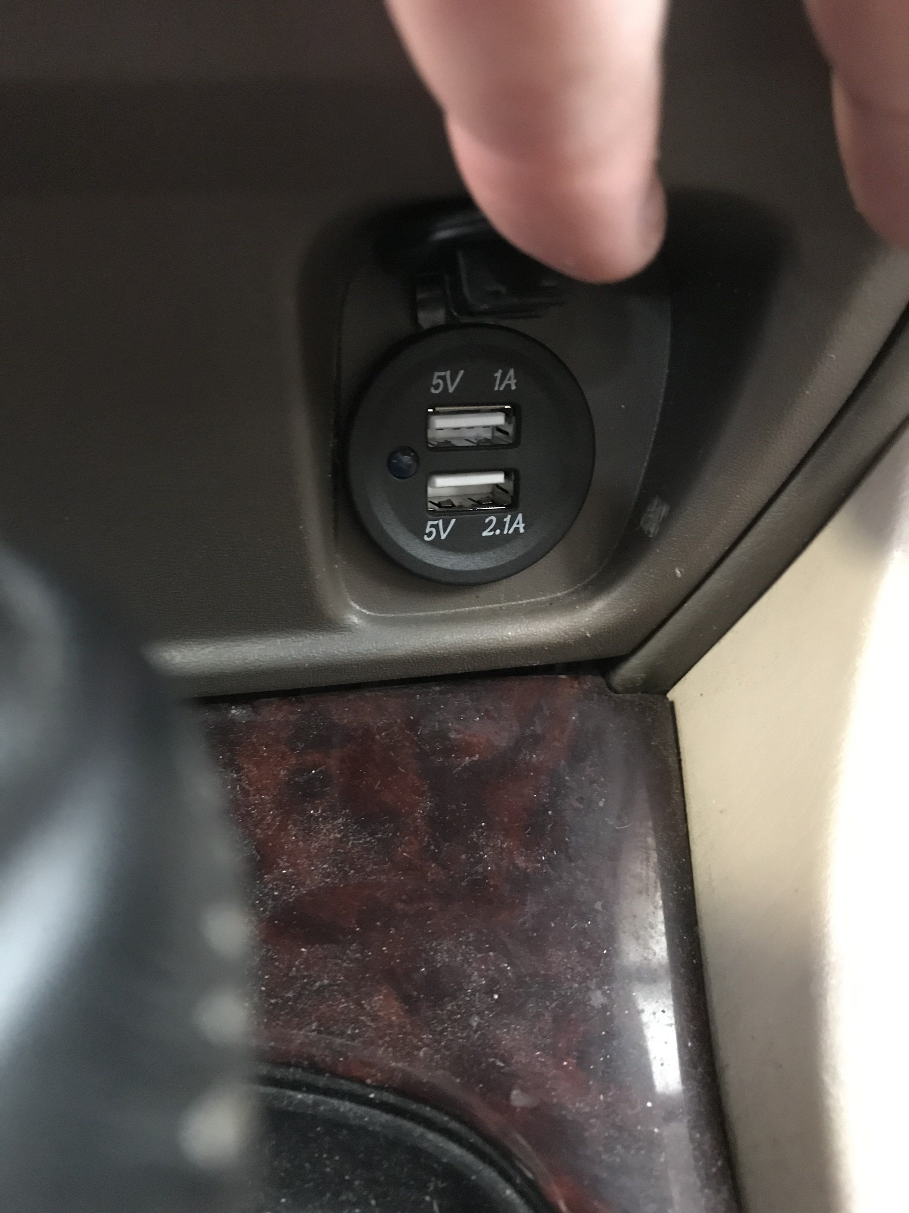

That looks really great, do you have a picture of the final product? Definitely gonna follow your steps and do similar to that, but I may have one usb as a pass-through for my head unit.
Sure thing, here you go. It's a 2-port USB charger (both 2.1 amps) and the center display is the car battery voltage. Here's a link to the one I purchased.
What wiring did you run to your battery to show battery voltage?
I have the same Dual USB plug as above with the voltage readout. No additional wiring necessary. I simply cut the factory +/- connections and added appropriate spade connections and then slid them onto the +/- "posts" on the new outlet.
Special note: if you replace the "outboard" plug (NOT the "cigarette lighter" plug), you'll need to dremel the hole a little larger for these dual USB sockets to fit. If you're replacing the "cigarette lighter" you won't need to dremel out anything.
