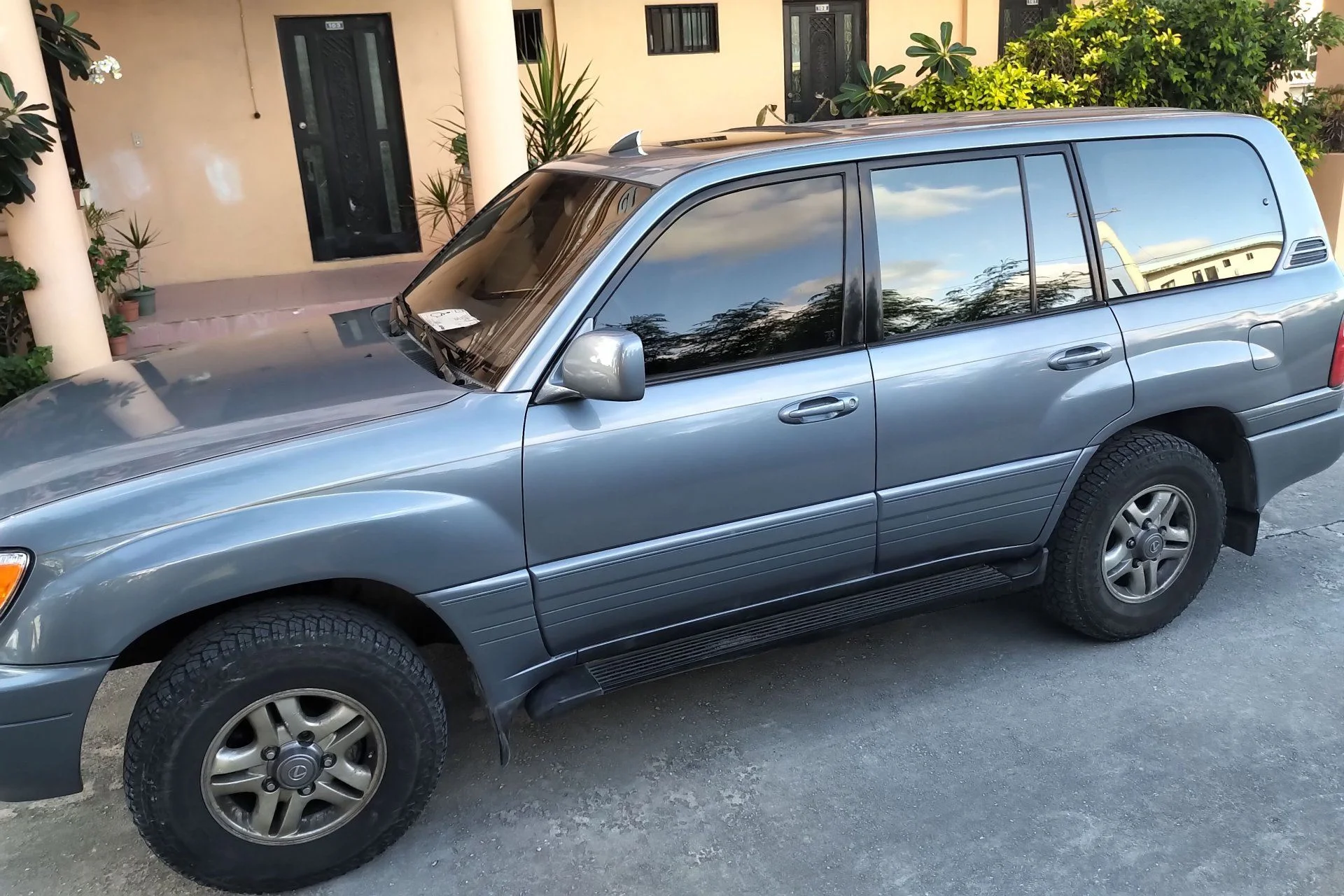

All good now, normal height front and rear, thanks to OEM Land Cruiser springs in the back and OEM Land Cruiser shocks all around.
Still using LX470 torsion bars in the front, but that will change once the LC torsion bars arrive from a very generous forum member.
Thanks for everyone's help.
Hey, we are back to stock height, and this truck is awesome! It now has stock Toyota springs and shocks, and also a ton of replaced suspension parts: ball joints, links, bushings, front and rear. Also new drive shaft joints. Among a ton of other stuff.
Subjectively speaking, it feels a lot faster. That sounds credible to me; there was probably a lot of deadweight loss in all the weird angles involved in the rear being up like that.
Quickie photo below taken while waiting for my mom to come for a first ride in it. Thanks to all who helped this absolute novice. (Yeah, I also need to get that fake GPS shark fin removed from the roof. I guess it's the 21st century equivalent of the fake cellphone spiral antennas back in the day.)
