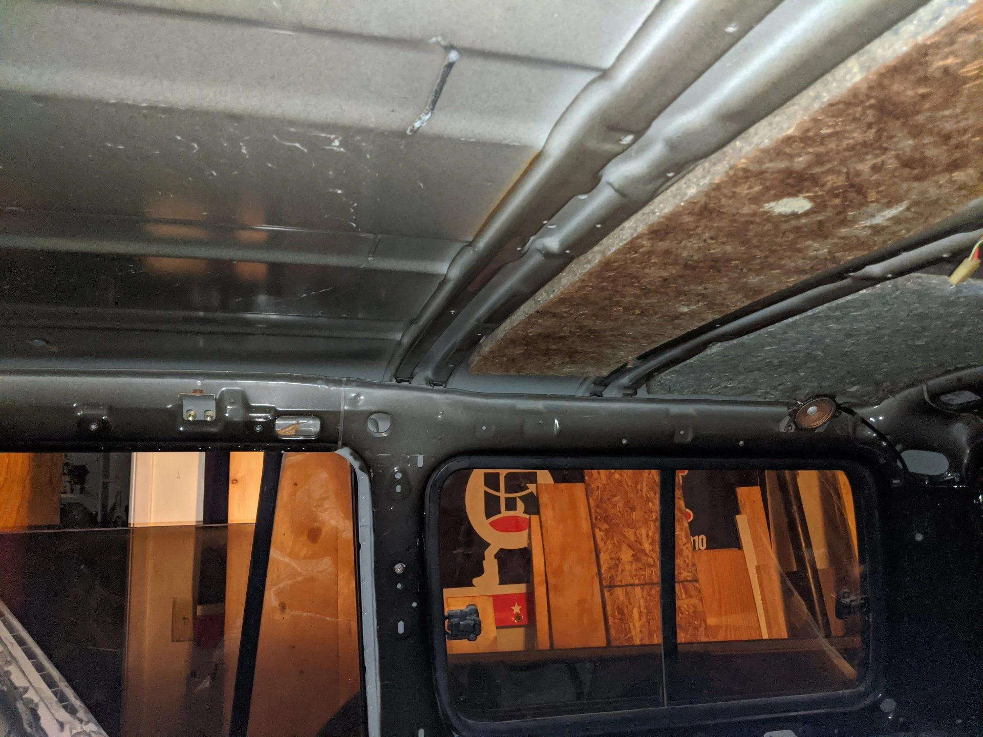

I have a 96, how difficult is it to run wire from the bottom of the left C-Pillar, under the headliner, and down the right C-Pillar?
I know there are pictures with the headliner removed but can't seem to find them. Anyone know if there are any obstructions
that would keep a wire from being fished straight through? Do I have to zig zag my way through to get to the other side under
the headliner? If someone has a picture of a 96 Series without the headliner, that would help. Thanks.

Pic of a 95.

No. The top of the pillars is covered. You'd have to exit the top of the pillars-theu the rounded hole in the picture, go over the brace, then have it hang free between the roof and headliner
Argh!! That's what I figured by looking at your picture. Of course it can't be that easy. Looks like there is no way round taking off some of the
hardware and clips and pulling down the headliner a bit to run that wire to the other side.

I have a huge heavy drawer system back there and can't run anything under the carpet from left to right. I've got so much other heavy wiring on the right side under the door sill that I can't fit any more wiring under that curved panel on top of the front of the wheel well. I have to go to the roof line.
