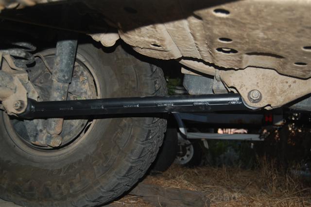

Measurements seem equal on both sides, parked on level ground. First 2 are passenger side, 3rd is driver. Passenger is the one i hung up yesterday. Thanks

From the looks of it, that bend is mild enough that I wouldn't be concerned from a structural standpoint.

So, not catastrophic, and something I can turn maybe 2500 miles on before replacing? Even under throttle, 40-70 it didn't feel like it torque steered awkward or anything.

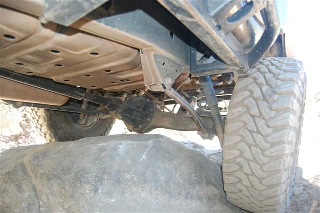

I wouldn’t even give it a second thought, but that’s me. If you’re set on fixing it, I’d recommend upgrading too. The easiest and cheapest fix I know of is to truss it/them with angle iron. Angle iron doesn’t require cutting the arm, you just straighten it and weld on the angle iron. Here’s the 80 that I did myself after running into too many rocks on the Rubicon :p

Wonder if trussing above the tube might be better from a clearance standpoint. Probably not as strong as trussing below, but perhaps worth the trade?
At some point you just start smashing the tube flat if it is so strong that it won’t give but as thin wall as ours are. Angle on bottom prevents that too.
The stock arms are actually reasonably stout. Not thin wall jobs likely to be flattened.

I agree that angle would better protect and support from the bottom. My thought is that it's always better to avoid contact in the first place which by putting the angle iron below, surely gives up breakover clearance. The opposite what we generally want, which is high clearance, or stock clearance for that matter. It almost comes full circle in that it increases the likelihood of contact, with increased bending pressures on the arm.
