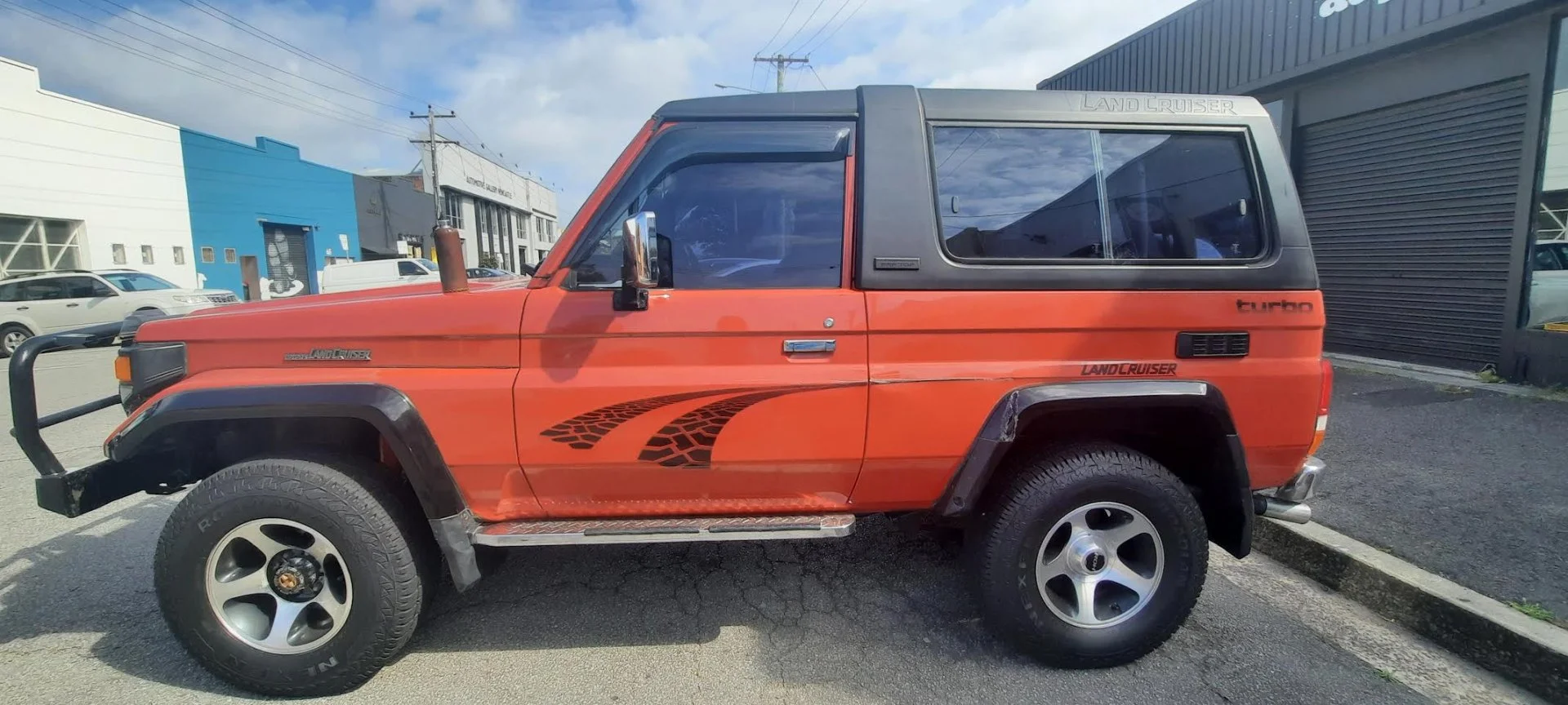

Hey there, this is my first post in this forum.
I've found myself here several times when looking for answers to my BJ74 questions so I figured I should just join. I'm so grateful for the wealth of info and knowledge in this community.
In September last year I finally bought a BJ74! A short wheel base Cruiser had been my dream car for some time but I just wasn't finding one in good enough condition at the right price so resigned myself to it remaining a 'one day' thing for me.
Then I came across this old girl! She's a 1986, BJ74, Turbo Diesel with 200,000kms on her, garaged her whole life, only a couple of owners and in mint condition!
Since getting her I've done a fire bit of work on her. She's a year older than I am so needed a refresh of parts and her turbo needed rebuilding, just got her back yesterday after a month in the shop and OMG, what a dream!
On top of this work, she also spend a month with the auto elec when I first got her because her ignition barrel stuck in the 'on' position and cooked the starter motor so that needed replacing and then to get it insured I had to get an alarm system, immobiliser and GPS tracking system installed. At the same time I got the dual battery set up put in and some outlets in the back and an anderson plug put on for charging my caravan battery too. It's been a pricey time already but she's now ready for her first long trip and it's nice to know I've got her ready for that.
Next week we're taking off to Alice Springs from Newcastle for a 3 month work contract in the Central Australian Desert. I'm so excited to get her out on the open road (she hates living in town).
I've done this drive a number of times in a few kinds of cars, a Mazda 3, a Daihatsu Feroza (one of THE BEST cars!) and a Holden Colorardo but doing in this Cruiser is the most exciting because it feels like drives like this are what these cars were made for!
I'm wondering how others here have gone doing long trips like this and particularly in Australia.
I'd love any hot tips you have for taking these machines on the road and and what your long distance driving hacks are?
I'll have a small trailer on the back for sleeping in, which I'm happy about because the only downside to the BJ74 is that it's just a little to small for sleeping in with gear as well.
