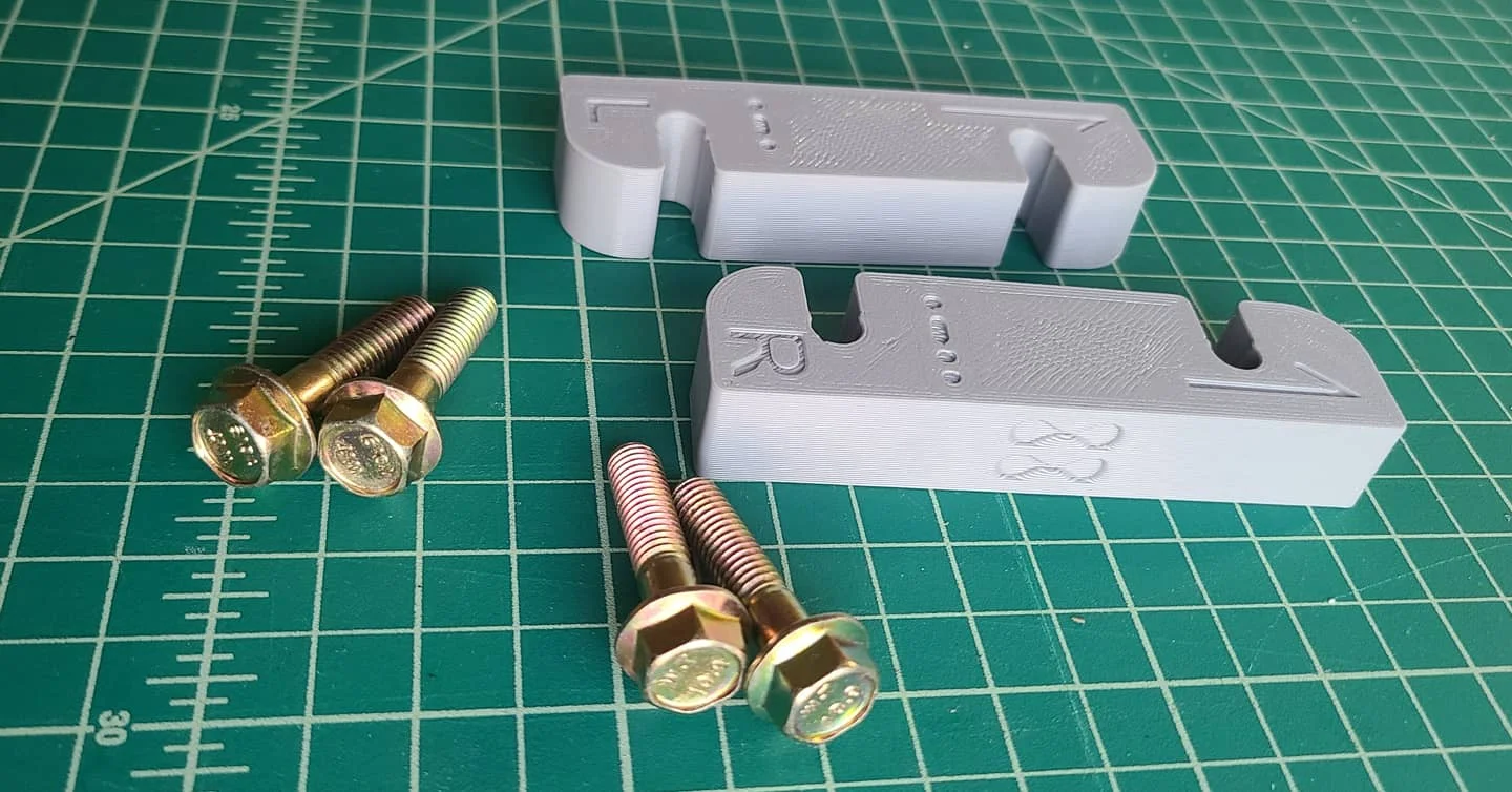

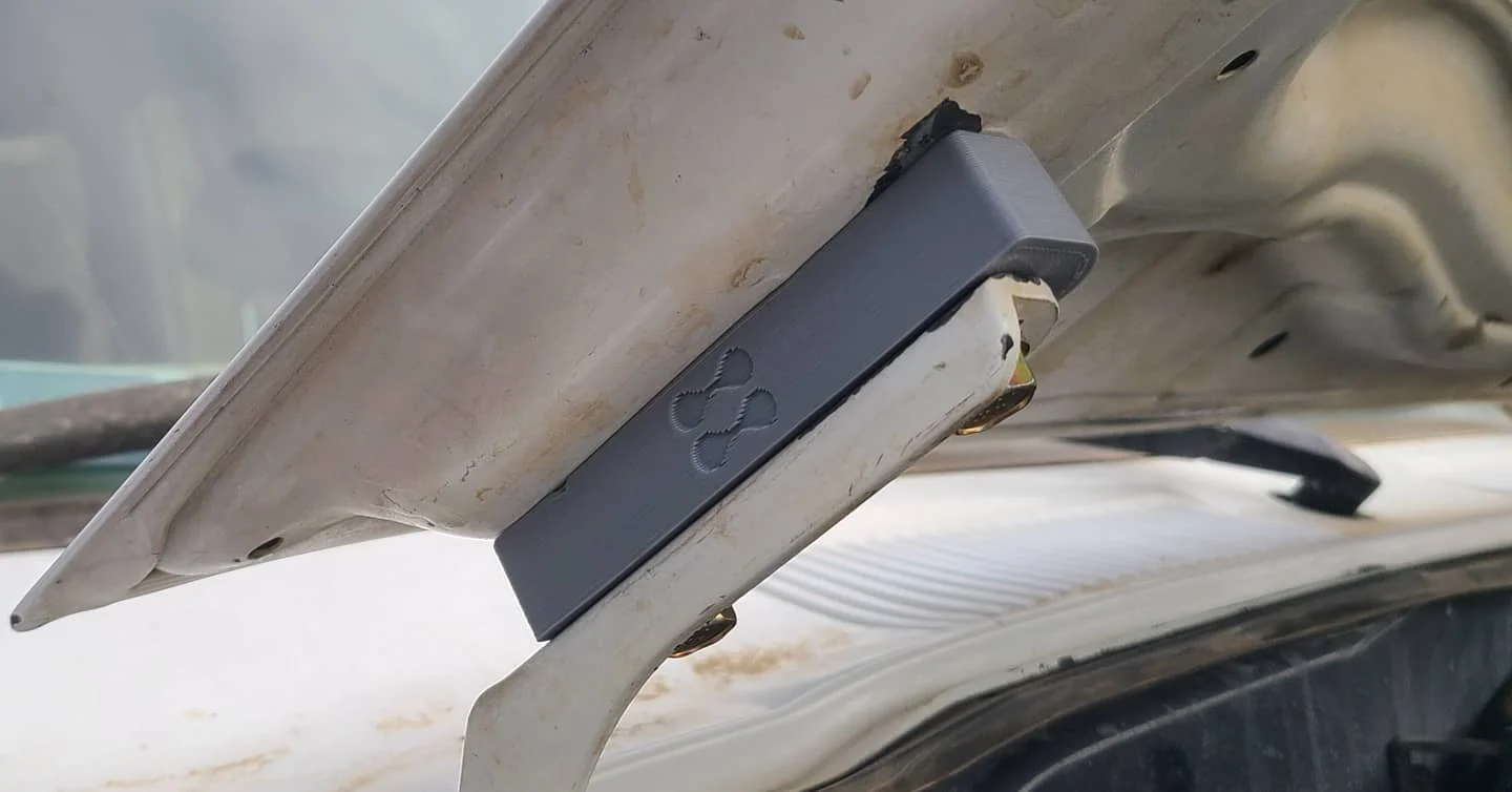

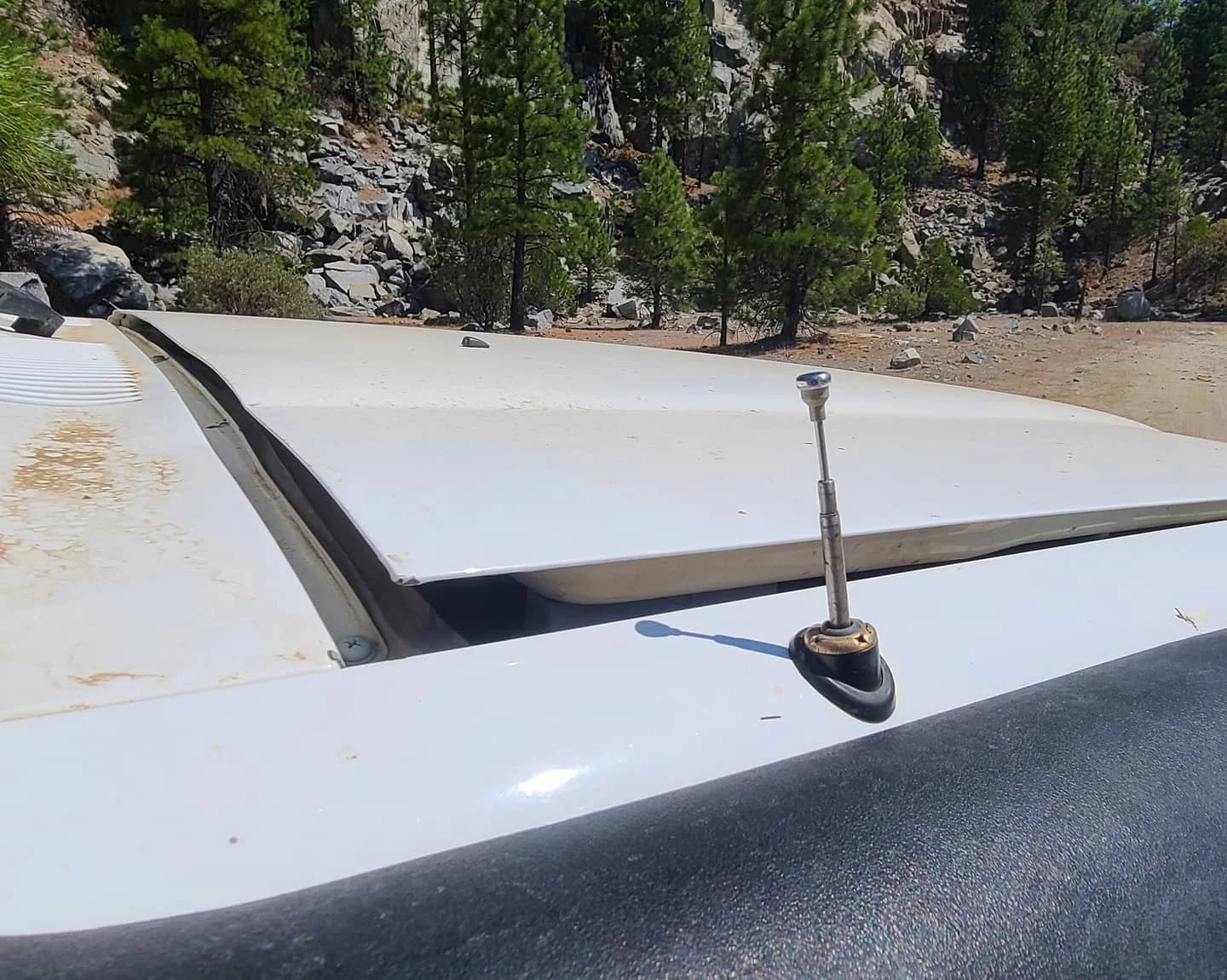

I made some hood risers to help vent some of the engine bay heat.
This is a nice alternative to cutting holes into your hood. Slots are added so you can install by your self a little easier. Bolts are included.
I have had no issues with the hood latch. Credit to Land Cruiser Phil for the suggestion.
What a simple and effective way to get heat out from under the hood (inexpensive too).

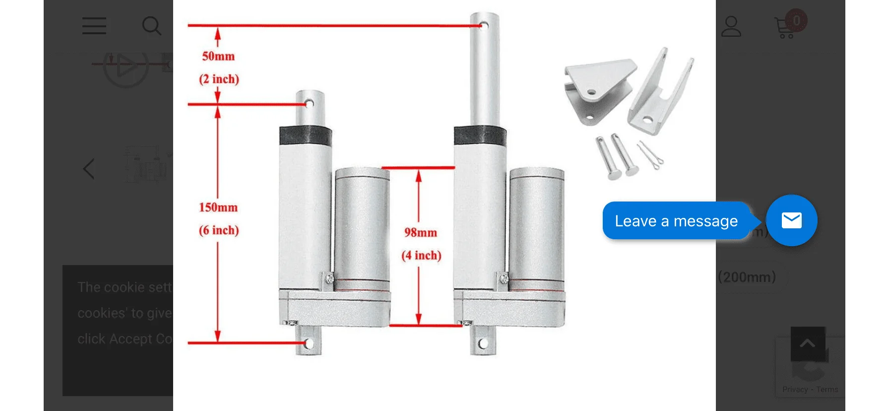

You could find a 1-2in stroke linear actuator for each side. And make a bracket to incorporate it into the hinges. Not something I would ever need to do, just a thought.
Or whatever bolts hold the hood to the hinge could be replaced with longer bolts with springs to pull the hood down unless pushed up by the actuators.
idk just thinking out loud :meh:
edit: the actuators could just be mounted to the firewall if you did the longer bolt and springs on the hinges.
I thought someone did something similar 10+ years ago and didn’t notice a difference in temperature. I could be wrong though. Did you happen to notice any difference in the intake air temperature sitting in traffic?

@Outsane are the stock hood bolts long enough for this? How many threads of engagement are left on the hood side? Is that the thickest you can go? I'm surprised the stock hood bolts would be that long.
@Andrewlnf I love all these first hand memories.
The stock bolts are not long enough for these risers, I made these risers 19mm tall as suggested by @LandCruiserPhil Longer bolts are supplied with purchase for installation.
I can go thicker or thinner, would just need to the appropriate bolts.

When you add these is it a little bit "trickier" to make the hood latch on front? I would think the angle might cause an issue (may be super wrong haha). It's a great idea, you guys make really cool stuff
great idea , but I hope you never get into a front end collision...
Been looking for something like this @Outsane. Ordered and thanks!
Me too, but I dont see how this would have an effect on that.
I guess it would be possible for the hood to come flying to the windshield on a front end collision... the angle on that picture looks way to creepy to me
