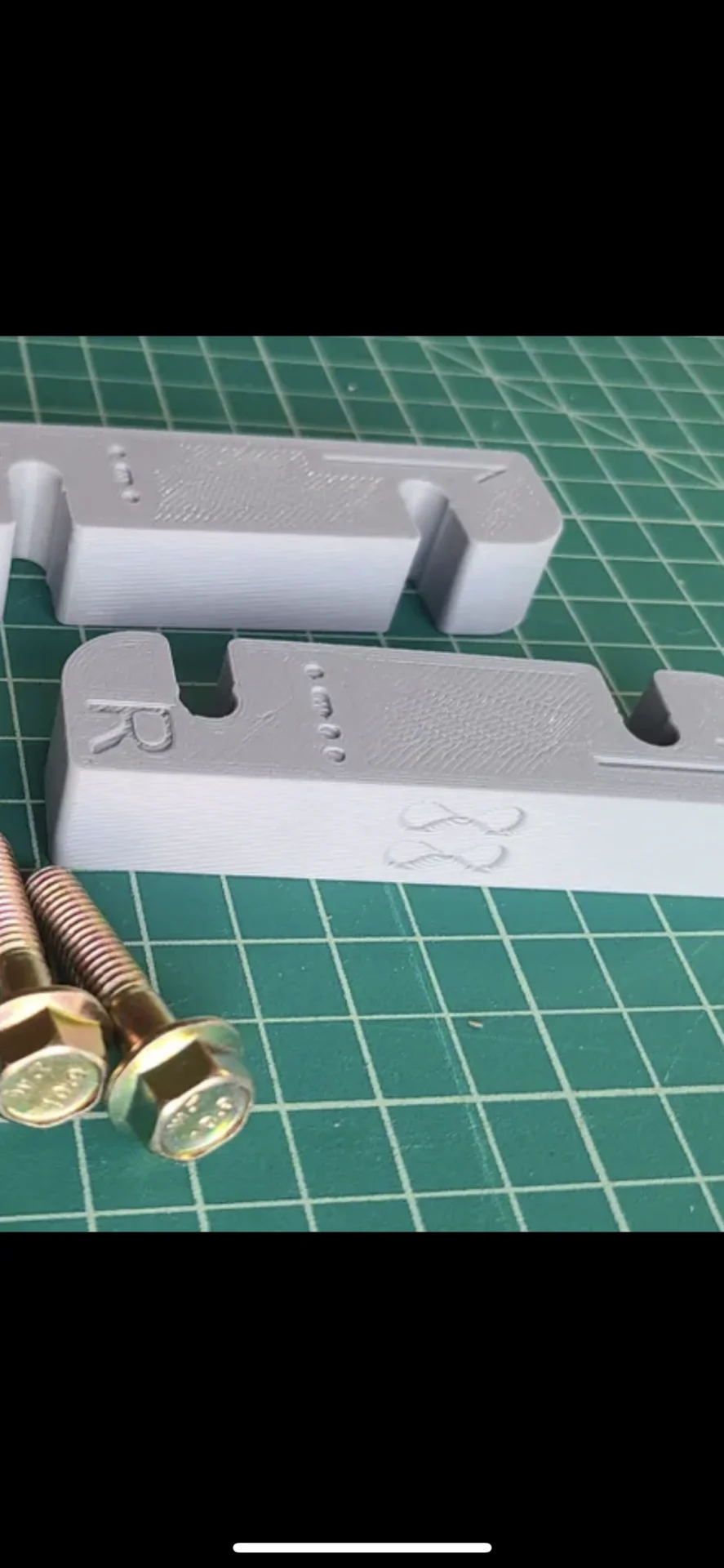

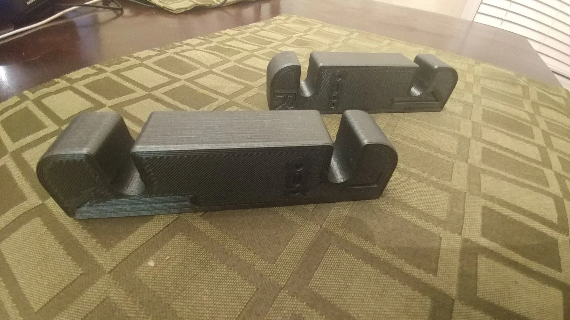

Recently installed a supercharger and moved to North Carolina a few months ago. Knowing that the engine bay will get hot, and the summers here are hot and muggy, to proactive, I bought the risers.
I paint everything and painted these, but unnecessary because @Outsane offers different colors and they are not seen when the hood is closed.
Solid product. I will install during summers, and store in the winter.

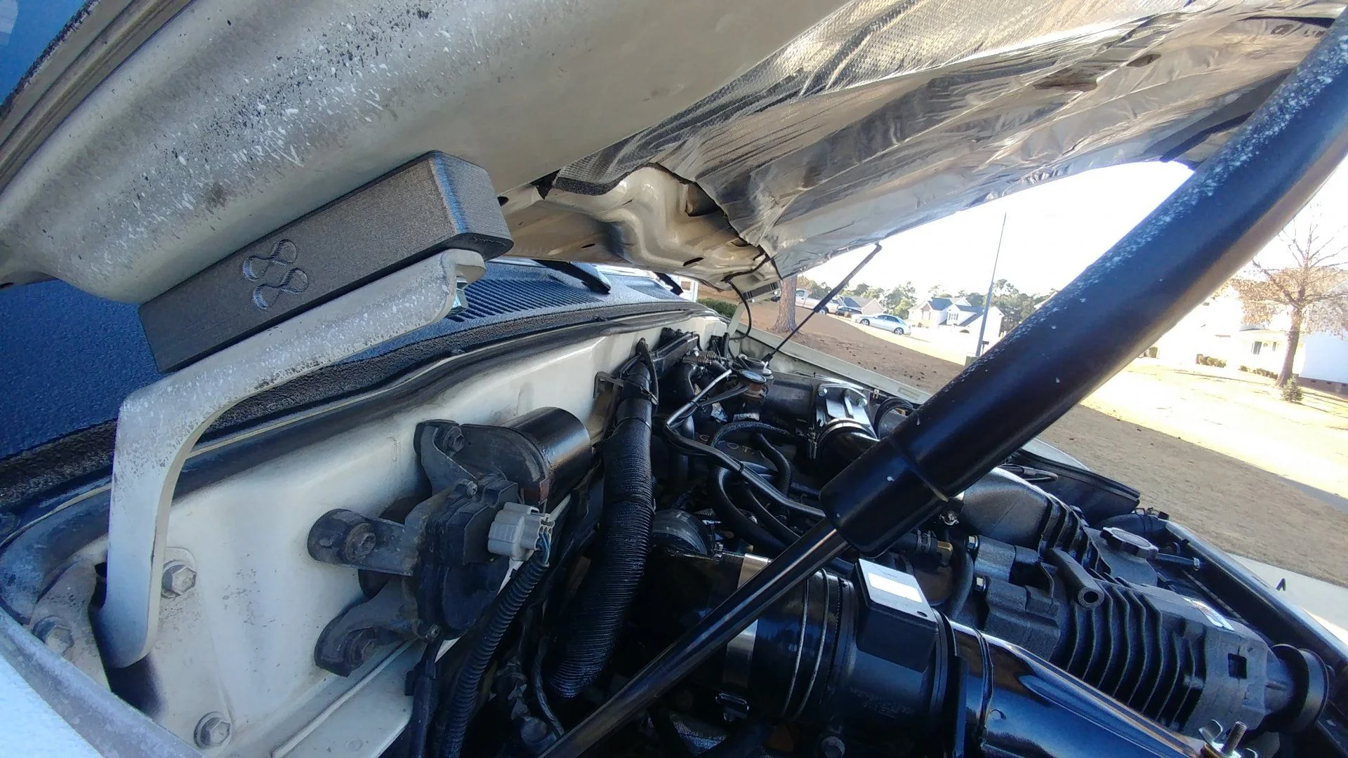

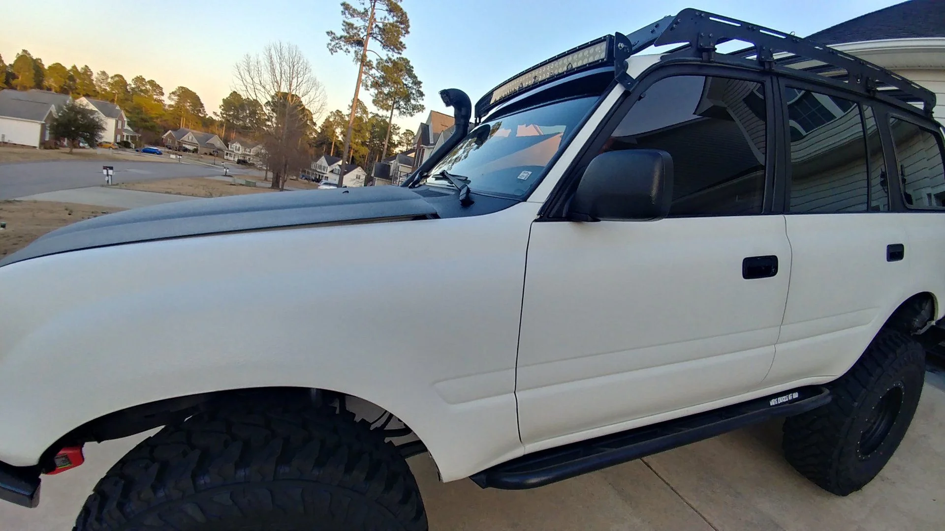

Just installed these hood risers to assist with heat extraction from under the hood since I recently installed a supercharger.

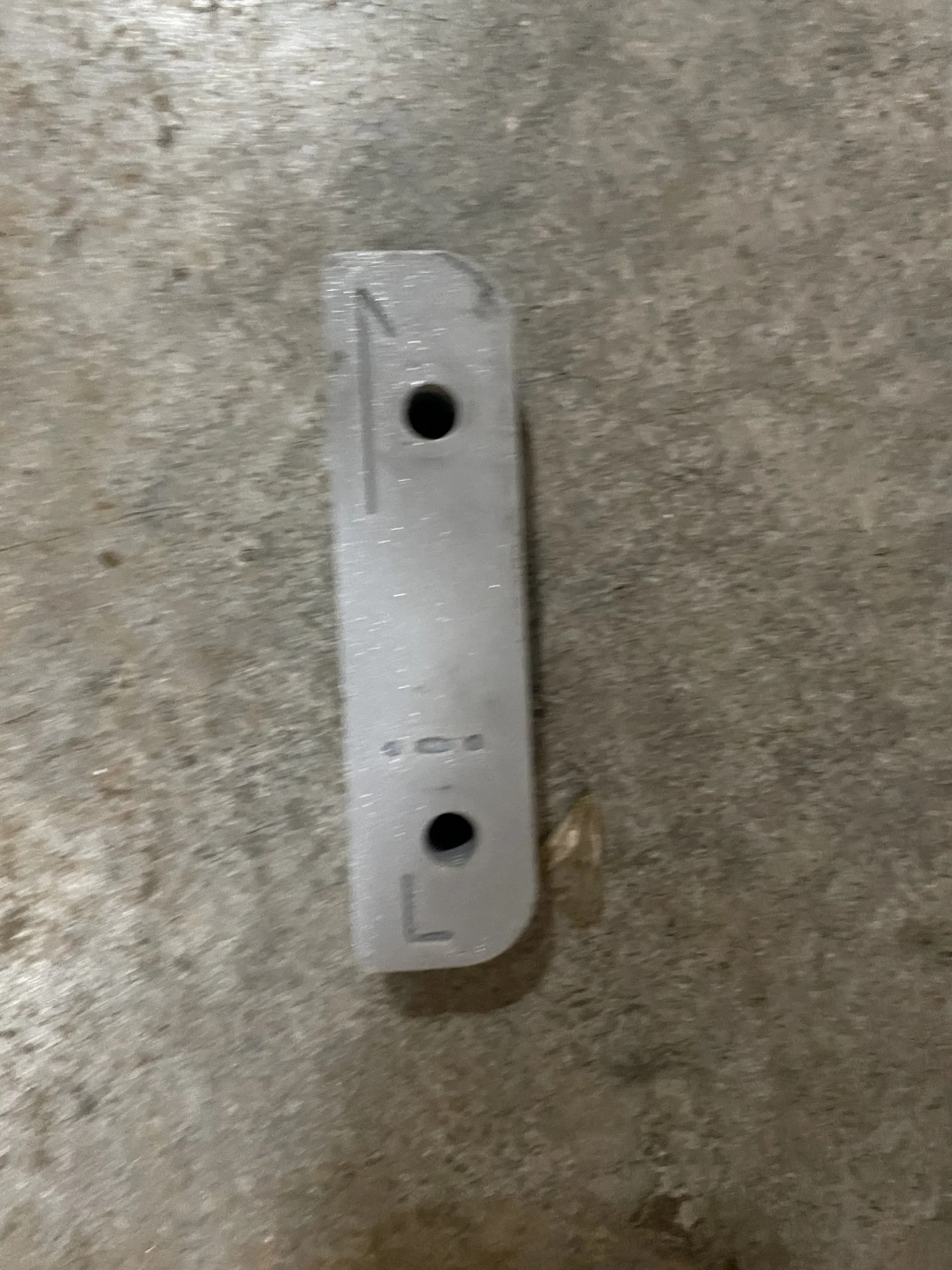

Yes it is a one person job, but my hood struts are only a few years old. When I first installed, the struts were pulling the hood forward and it wouldn't latch down when closing the hood.
After removing a strut install spacer, then re-install strut (then do the other side). It was a lot easier.
Anecdotally, my AC seems to have worked better. Take this with a grain of salt as I did absolutely no before/after testing. Just going off what it "feels" like on hot days in traffic when my AC used to struggle. Now it seems a bit better. I'm happy I did it and will just be leaving the risers in year-round. HTH!
