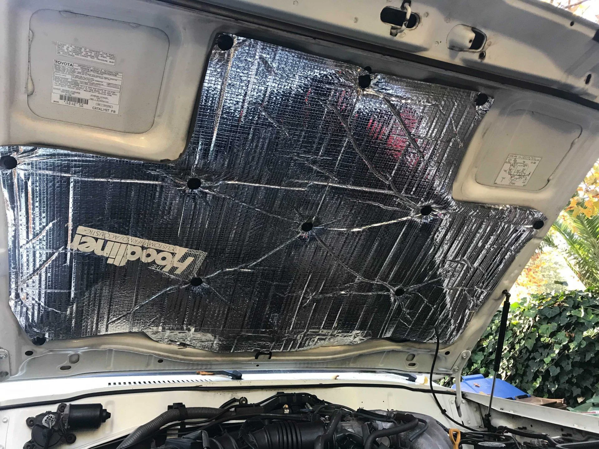

Mine was falling apart too and decided to go with Dynaliner hoodliner. It was big enough to cover the same footprint as the factory one, and even though it has an adhesive back, i added the little black OEM clips to make it more secure.
Does it help with sound? Maybe, but nothing to write home about. I put some seam sealer and second skin damplifier on the underside, and that helps with the "claaaaang" when it closes; now it has more of a thud.

It was this one: Amazon product ASIN B00069QLVC
Ironically, I just took this off a week ago. The foam layer under the foil on the Dynamat is not closed cell and it soaks up water like crazy. It also does nothing for sound.

I bought hood insulation from Summit Racing back in 2019. Metro Supersoft HI3, p/n MMP-HI3. Currently $90.99.
It noticeably reduced engine noise, not that it was at all intrusive before. It's significantly thicker than the factory liner. On a frosty cold day, the middle of my hood will still be frosty/icy after a ~5 mile drive across town.
When you cut it, make it a bit oversized. Maybe 1/4" or 3/8" in each direction. It's not custom molded like the factory liner, so if you lay the factory liner on it and cut it out exactly, you'll end up a tiny bit short on a few holes once it's mounted. I have a couple of holes that tore out because I didn't cut it oversized. No big deal, since the Toyota plastic clips are so large diameter.
Regarding paint, I ran without a hood liner for about two years after repainting the vehicle with PPG Shop Line (their cheap stuff) single stage. The paint was undamaged. I've heard of hood paint discoloring from heat, but it was a Rustoleum job. I would probably be concerned if I lived in Los Angeles or Phoenix, but I think the risk of paint damage from engine heat is overstated. 25 years of UV is probably what killed your hood paint.
