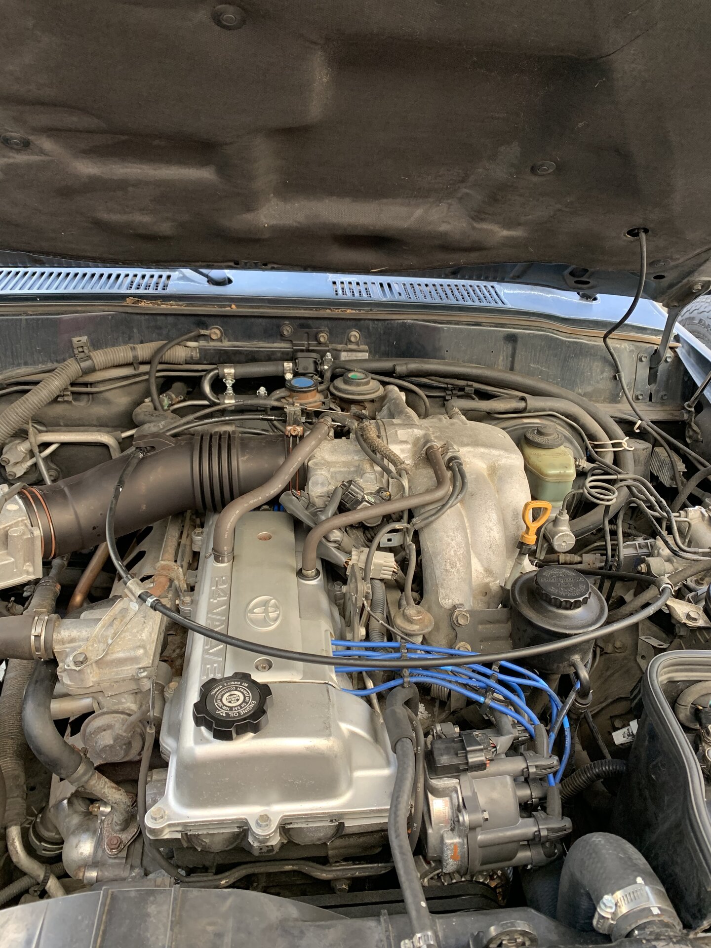

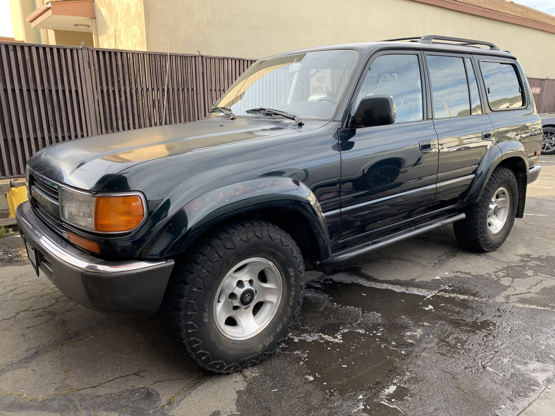

Swapped the crusty old throttle cable for a fresh OEM unit. Buttery throttle response! Added a good 50 HP to the butt dyno for sure!

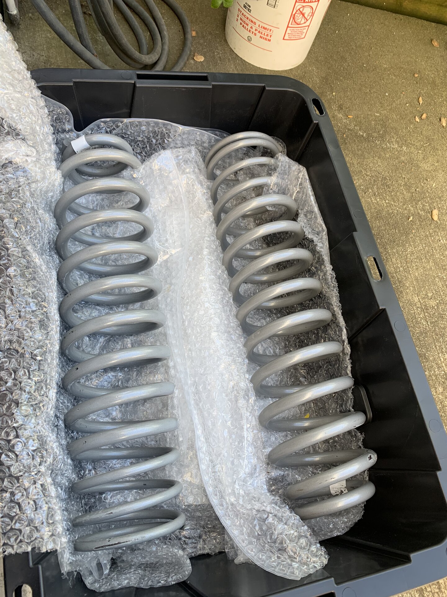

Suspension goodies have arrived! Thanks to @FMC80 for styling me out with a 75mm Slinky setup. Still sourcing shocks… mill creek overland has a set of stage 4 icons in stock that are matched to these springs… I really want to pull the trigger on them, but man are they pricey!
Millcreek Overland is where I got my slinky stage 1 from. If Albert has a set of stage 4s on the shelf, you better jump on it soonest or it will be gone asap.
P.S. Glad UPS only destroyed some of the packaging and not the internals.
All your heater hoses are original better change them and the phh sooner then later. I’d also get the right rad cap from Toyota or at least make sure the one you have is for the right pressure.
Have fun

OK! I Need some advice here. I've been sourcing parts for a big suspension upgrade, and I need help finishing out the build list...
I Have:
Slinky 75 mm springs, adjustable upper control arms, extended brake lines, sway bar extended mounts and extended bump stops. Slinky Icon Stage 4 shock absorbers are on their way... Fifteen52 17x8.5 ET0 wheels and 37x12.5 Cooper Discoverer STT Pro's.
