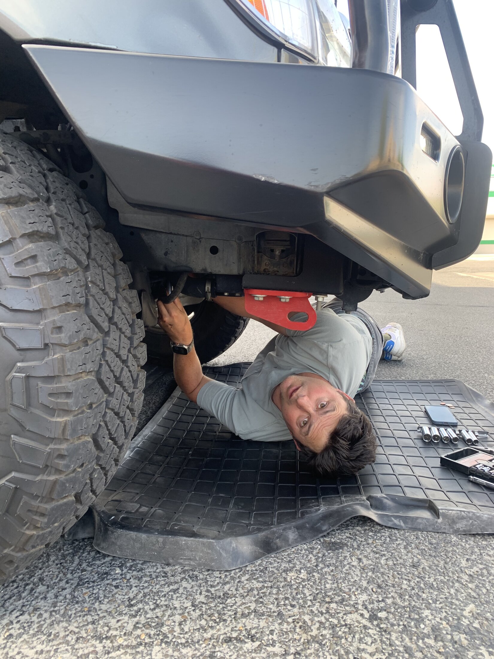

Hit the road towards Reno, and made it another 125 miles to Winnemucca. We located an Oreilly's there who would loan us some tools and had a shady spot in the parking lot. There we tackled the Alternator job, which was a 2 banana affair in my opinion. Having to remove the PS pump in order to free the alt was the 1st challenge, but birthing that big alternator out from below, dodging all the trans cooler lines, lower rad hose and everything else was no picnic. We finally got it swapped out, and were covered in grease for our efforts. New Alt did the trick, and she was charging great, 14.2 on the multimeter! Big thanks to the kind folks at Oriellys in Winnemucca for loaning us all the tools we needed, and even a bucket to stand on to get into the hood.

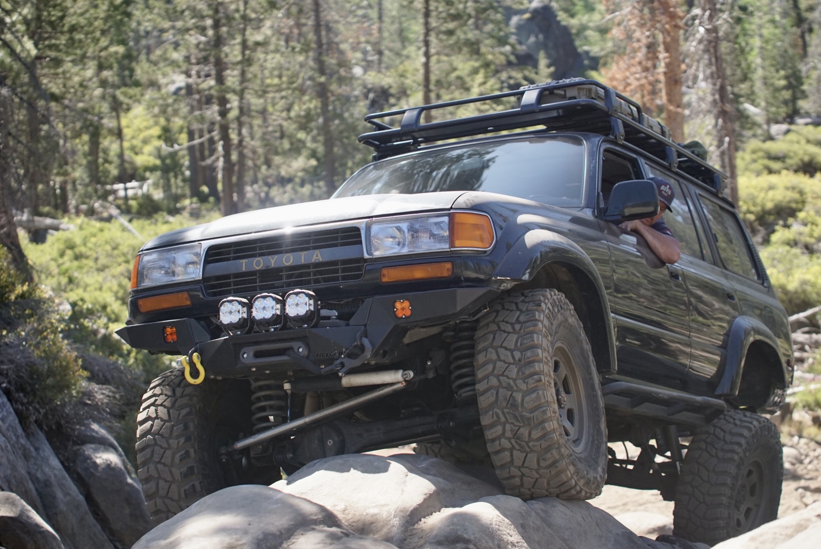

Conquered the Con! Attended the TLCA Rubithon last weekend. What an amazing event, and very proud of Honu for her accomplishments making it through the Rubicon. Definitely the most challenging wheeling I've ever done, and she handled it like a champ!

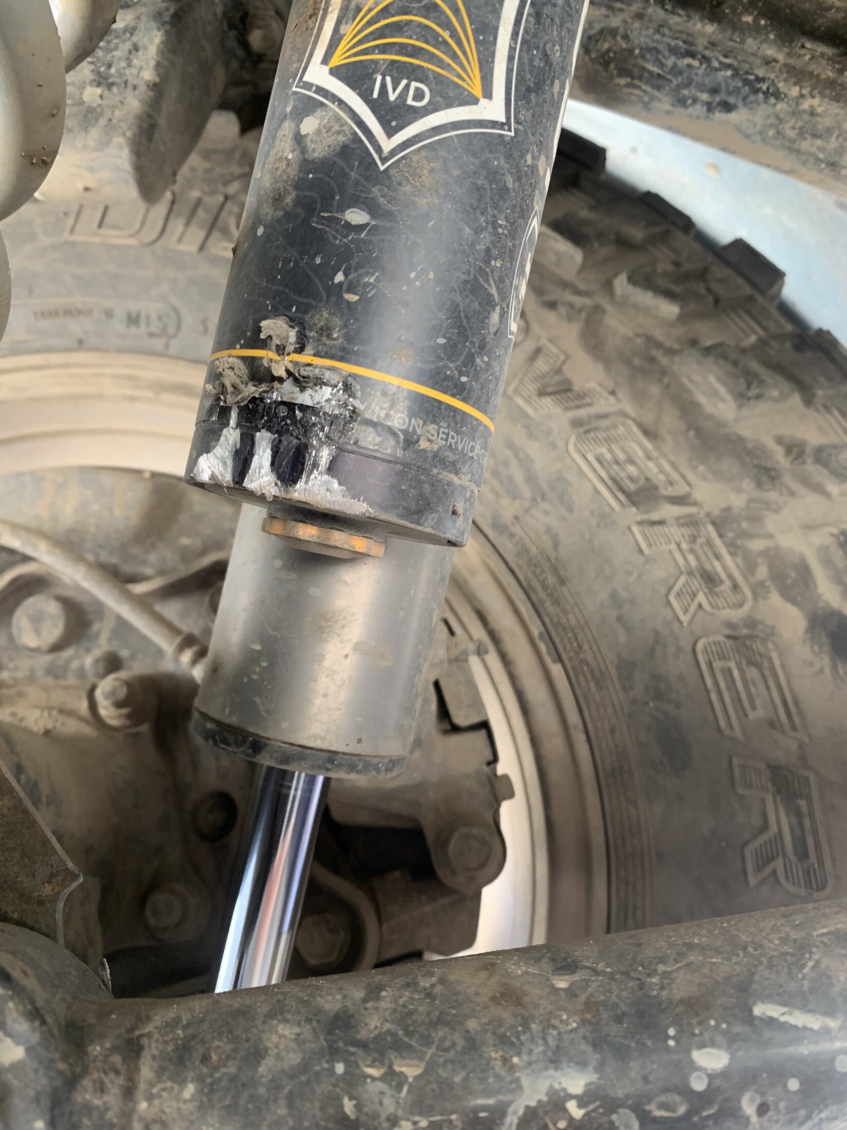

While inspecting my rig for damage post rubicon I found this pretty gnarly damage to both rear shock piggyback reservoirs. It looks like the body of the shocks had rotated, and the res was making contact with the axle housing or lower control arm when compressed.
Going to have to find a way to keep them from spinning like that and making contact...
